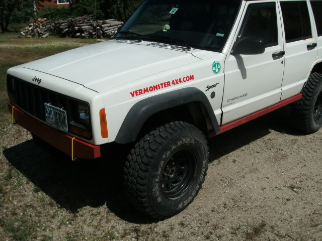

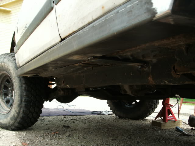

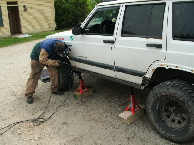

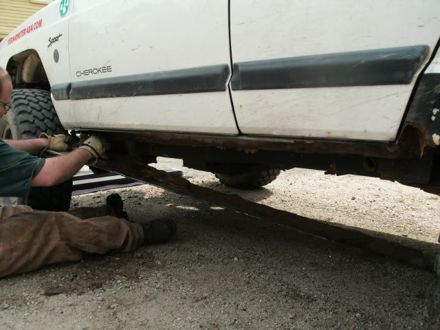

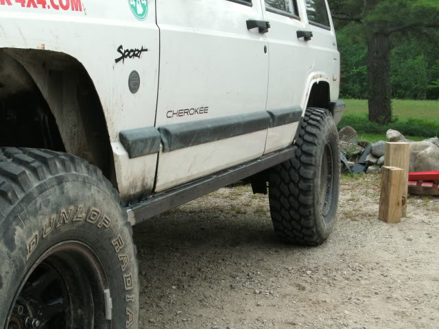

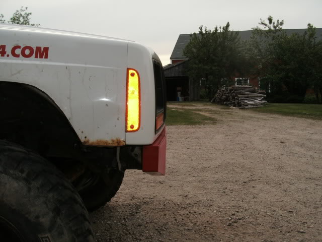

she has changed a bit.no more stock bumper,rockers or flares..after bashing the front bumper on a rock/tree,a friend built a simple C channel bumper for me and he also cut off rotted rocker panels and welded on some 2X5 square tubing..fender flares have been replaced with TJ flares.(four rear flares).other misc stuff is she has been demolded and rear fenders have been trimmed a bit..plus a couple more dents and dings..

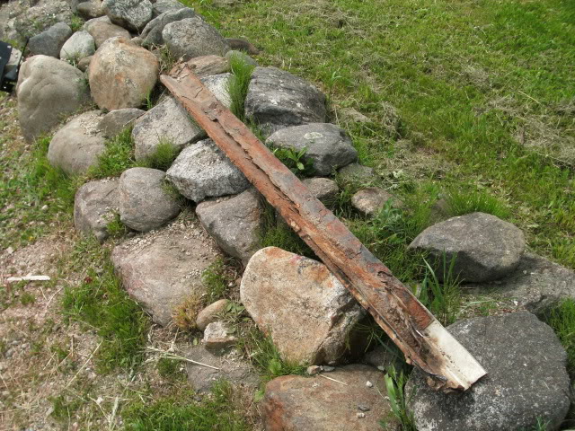

cutting rockers off..

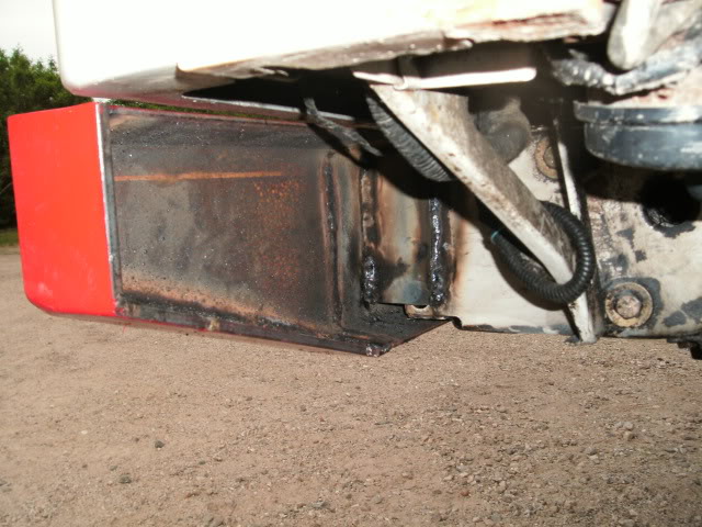

welding rocker/sliders on..
all welded on..

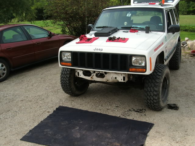

stock bumper removed.
it doesn't stick out very far.
we didn't bother making it removable to easy..welded on.
and a few months later,he welded on some home made D-ring tabs and we reinforced bumper mounting by bolting and welding in tow hook brackets also..
front flares mocked up.(presently mounted on front and rear)

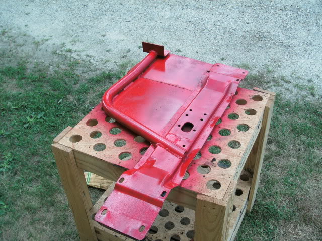

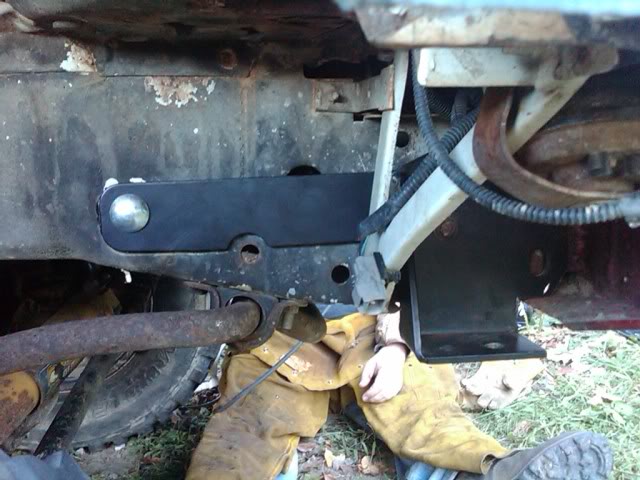

this crossmember and T-case skid plate will be going on hopefully this sat..

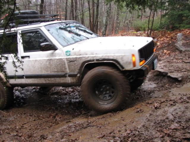

Very nicely done man! Just out of curiosity how do those dunlops perform offroad?
Thanks to both of yeah.

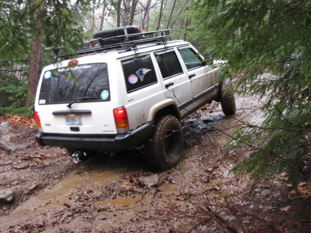

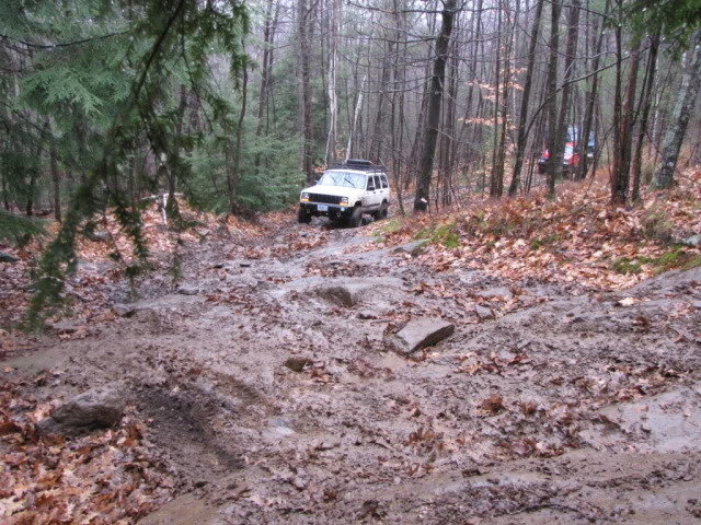

I'verun them through mud,snow and on rock,if aired down properly (around 15 psi) they worked pretty well (IMHO).
there's one trail in my area that has a semi steep incline with left turn in the middle and i crawled right up it when it was wet and muddy.they act the same in deep snow when aired down..thin sidewall though so even at 25psi,walls will start to flex.
Well thanks for the review on those tires lol ive been looking at purchasing a set of them, especially since BFG quit making its KM1 mud terrain, not to mention they're cheaper than BFG's
