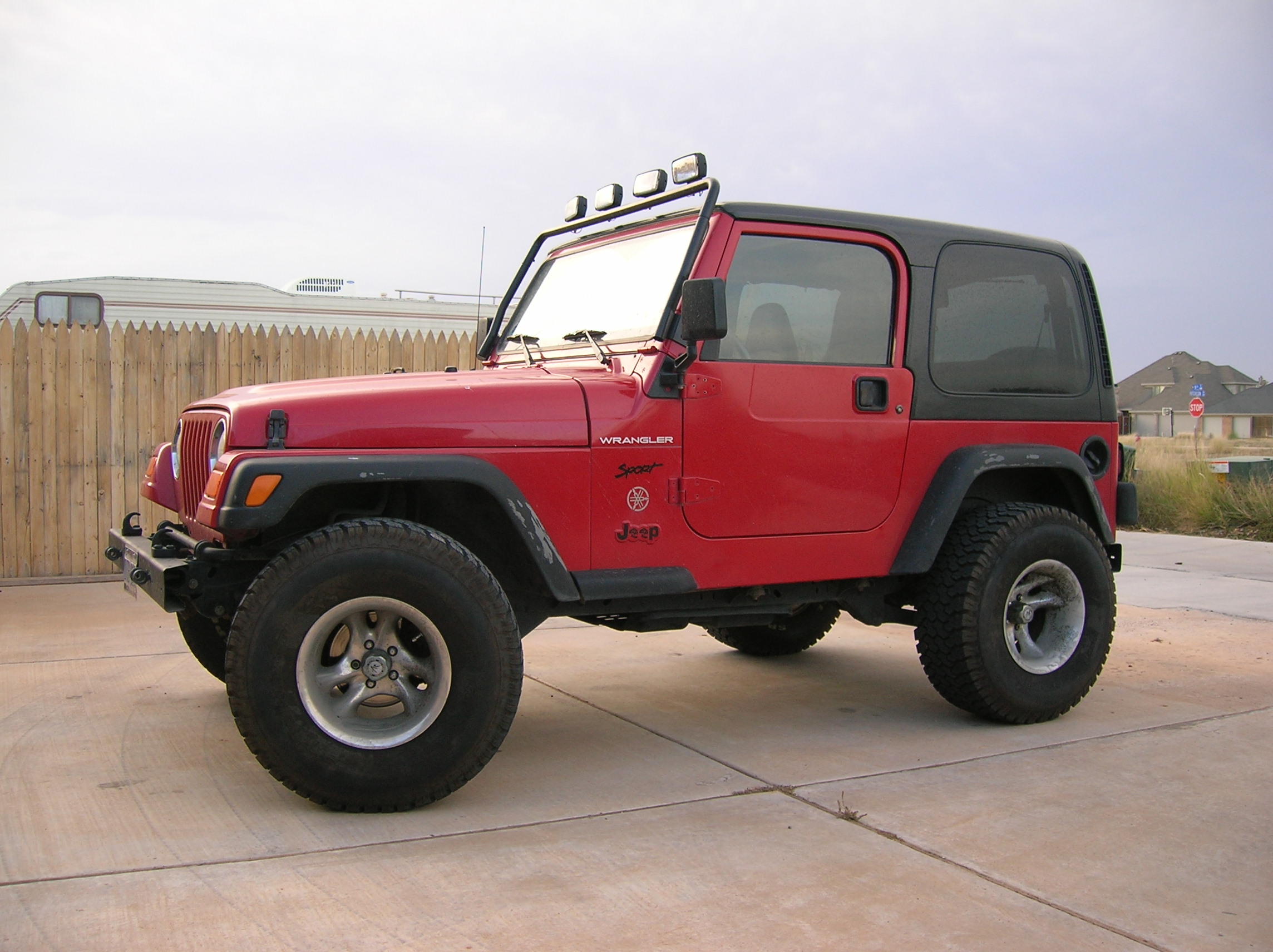

Here is a picture of my 02 with 33x12.5's and I think a 2" bb coil spacer lift, just to give you an idea. I haven't had any problems with rubbing or anything, and I also still have the stock shocks, probably not too good for it, but I'm planning on upgrading soon anyway.
