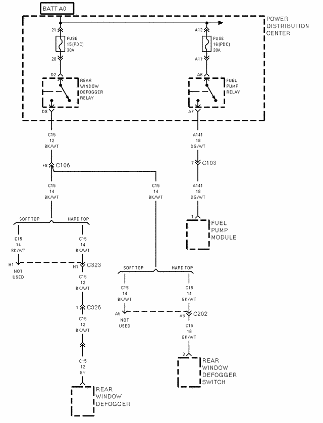

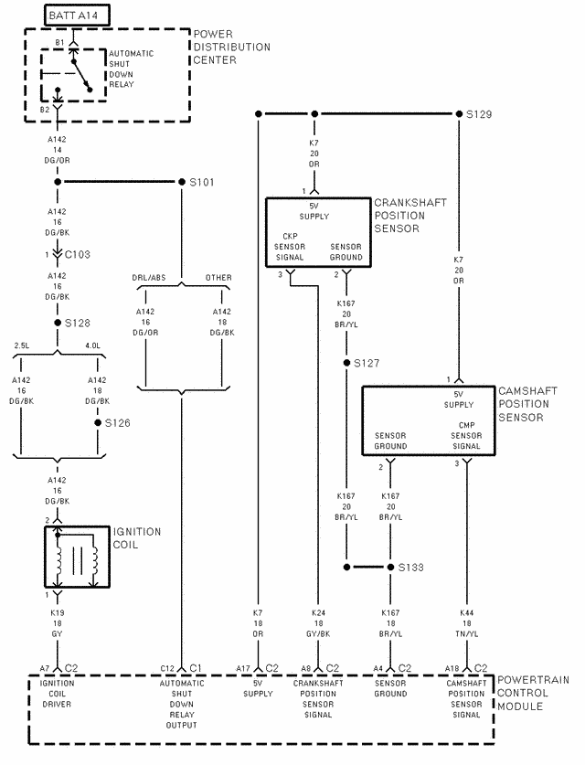

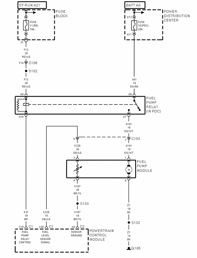

Ok a little bit of rewording here. I just need help finding out what the layout of the PDC is for my 97(4.0,manual,soft top if that makes a difference). I have gone through the haynes manual, and looked at the owners manual for several different years of TJ. The haynes manual is useless in this case since I do not have the time to pour through wiring diagrams. The owners manuals all say the same thing, that the PDC cap has the layout on the inside of it.......... Mine does but all it says is fuse 1, fuse 2, fuse 3 etc. If anyone has a pdf or a scan or even a picture of the layout that says which fuse is which I would be grateful if they would be willing to share.
