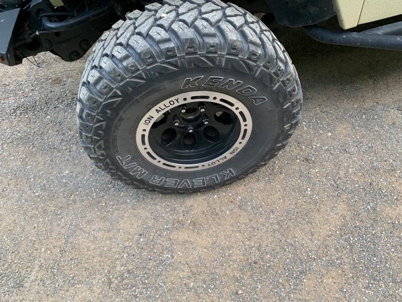

I have a daily Driver, TJ 2000 Sport 4.0 - She has a 4" lift and 31" x 10.5" x 15" currently, I would like to upgrade the tires to BFG - KO2 - 33" x 12.5" x 15"
Considering shes a Daily driver I would like to be able to get her up to 75mph and still hit the sands on the beach
I need to ask what items I should consider regarding this change.
Drive Shaft?
Gear Ratios considering a speed (@75mph) Hwy of course.
Anything I'm not thinking of?
Etc?
