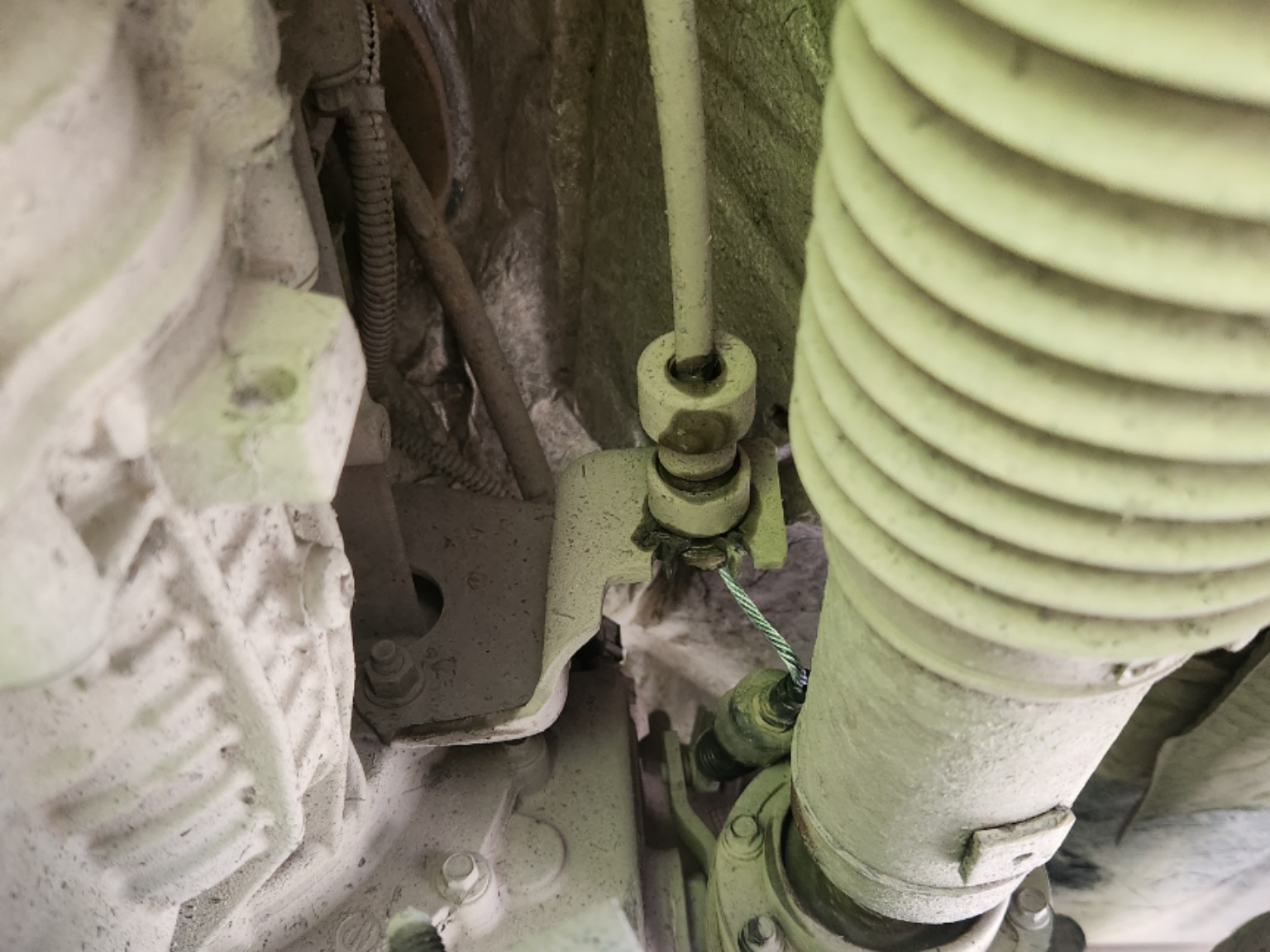

Today, at the off-road park, I lost 4 lo. My transfer case would shift into 2 hi, 4 hi & neutral but no 4 lo, just a spongey feeling in my shifter where 4 lo should be... well, I went to the articulation area to get a good look under the Jeep at the linkage and this is what I found.
I'd rather not have to replace the linkage as is ridiculously and needlessly complicated... but I couldn't do anything on the trails but curse my ham hands because I kept finding the exhaust with the back of my wrist... waiting until it cools down then I'm going to see if it came unscrewed (hopefully) or broke 💀

Part of that cable is rubbing on the drive shaft. Not good!!!
Slowly cutting it or swiftly ripping it out.
That's only when I'm trying to shift into 4LO. 2HI/4HI/N don't make the cable bulge out like that. I bought the B&M upgraded cable & bracket... no instructions on the box & limited instructions on the internet.

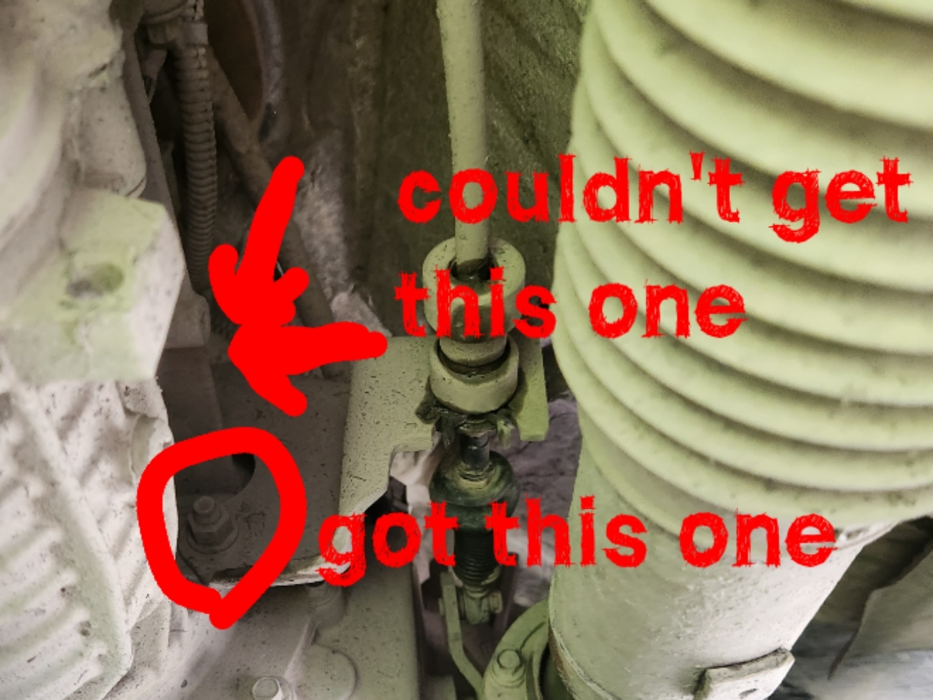

There's a bracket on the driver's side of the transfer case that I can only undo the lower bolt (and that was a feat in itself). The new bracket moves where the cable attaches further away from the t-case so the stock bracket has to go. I tried undoing the crossmember that cradles the t case to get better access but that didn't work. Instructions are as clear as mud & the help line was a joke. They both told me to "just unbolt it" like the Instructions say to
can you put 2 or 3 feet of extension on the ratchet and get it from farther back?
thats how i have to pull the bolts for some bmw bell housing bolts. i lay by the back wheels and feed the extensions up along the driveshaft and upto the top bolts, which are a dang 11mm. what the heck
I'll see what I can do. That top bolt is at the top of the t-case facing front but I'll see if there's another angle of attack.
