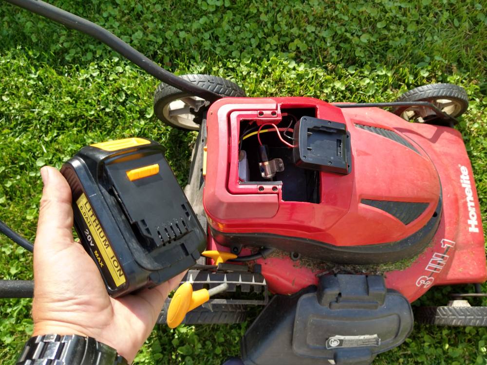

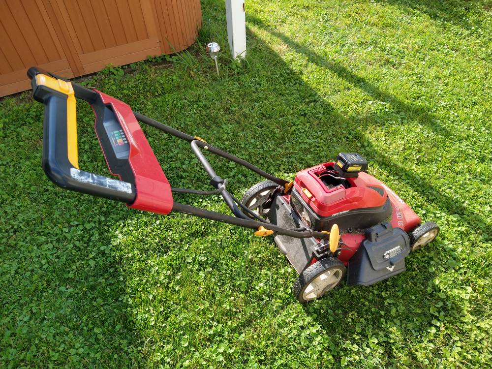

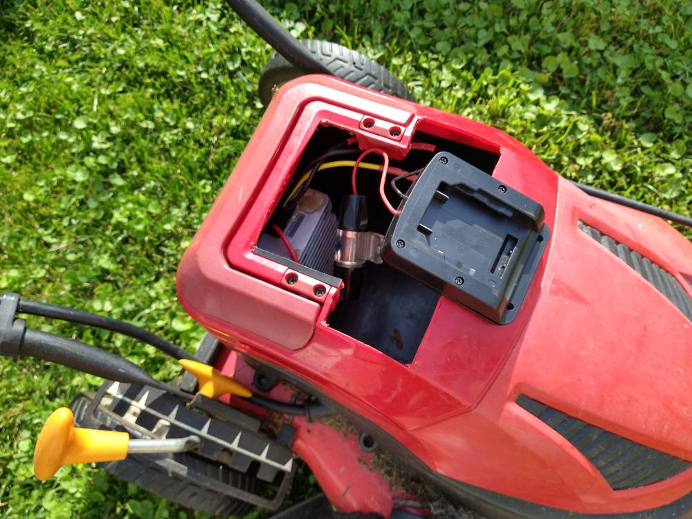

I've been using this battery powered lawn mower that I got for free for years now. It got to the point where every year I would buy new lead acid batteries to go in it. I started shopping around for a new dewalt lawn mower that would use the same batteries as my drill and other tools but those lawn mowers were over $400. I decided to get an adapter and a 20 volt to 24 volt step up converter and modified my old lawn mower to use my existing DeWalt batteries. It turned out pretty good I believe.
I do have to keep my eye on it because it will run the battery down to zero but other than that it works great.
Overall I'm really happy with it.

I got it off the side of the road - the older batteries had died, so I replaced them. It took two 12 volt batteries that were pretty large - the rectangle shaped ones. Together the two batters were about the size of a standard car battery.
I probably could have run it straight off the 20volt Dewalt battery instead of the 24 volts it's designed for, but I wanted to learn a bit more about step up converters, as it's not something that I had worked with before.

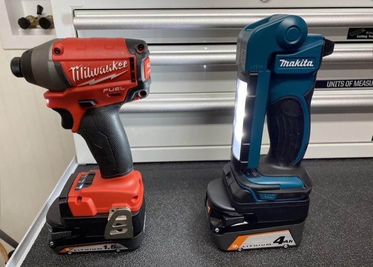

Nice mod to keep the lawn mower powered up with Dewalt batteries. On the topic of lithium batteries just want to share the direction I’m heading with battery adapters. My Ridgid batteries have LSA warranty for life-time replacement can now power up different brands power tools with inexpensive battery adapters.5CEA9A1B-35DC-4F00-97E5-89A7E321AF8A.jpeg
