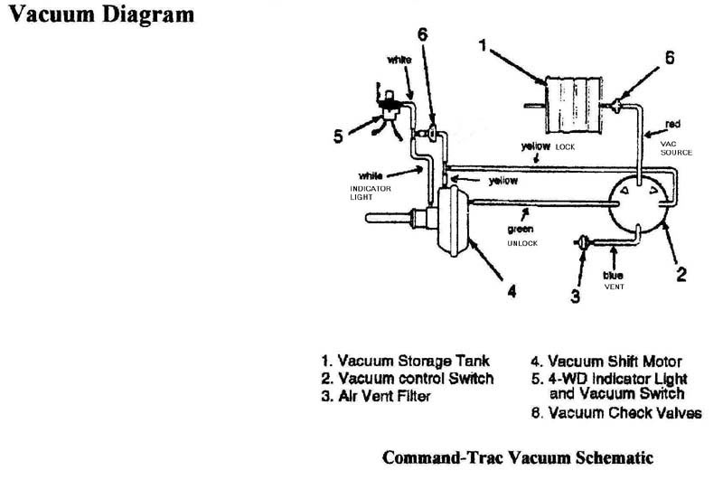

Maybe the vacuum lines got switched somehow.
Here's a schematic, if you want to check.
That diagram is fine for early YJ's before the moved the 4wd indicator switch to the disconnect housing on the axle like the 95. Everything before the axle is the same.
I don't think so, I think the switchover was around '91 but not sure.
It's close for every YJ, the '91+ just didn't have the white vacuum line on the axle but an electrical connection instead, from the axle mounted 4wd light switch back to the computer.
