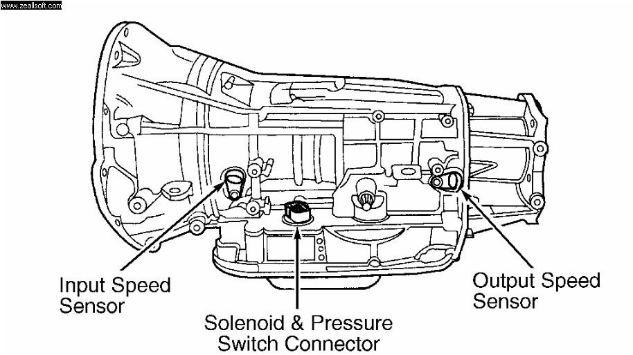

If fluid was full and color correct then clean the TPS and check the transmission output speed sensor.

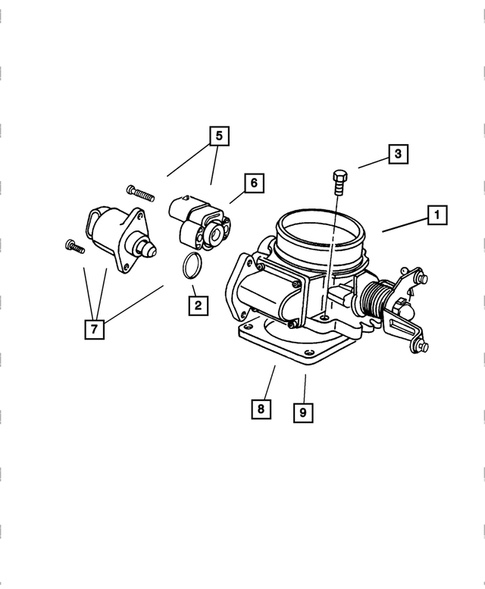

TPS throttle position sensor. #6

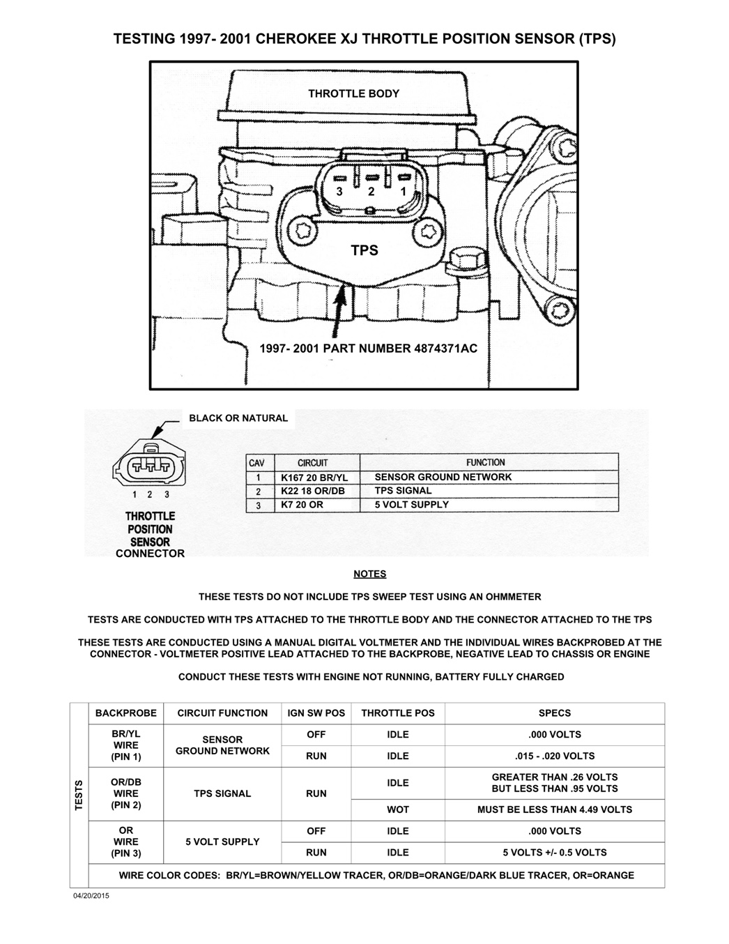

Tps is a voltage dividing resistor. Center pin resistance should vary as you open and close the Throttle Body.
Sometimes dirt gets in. Fully Opening and closing the throttle body valve a number 20-30 of times can clear it. Some blow air in it. If replacing any sensor use OEM parts.
