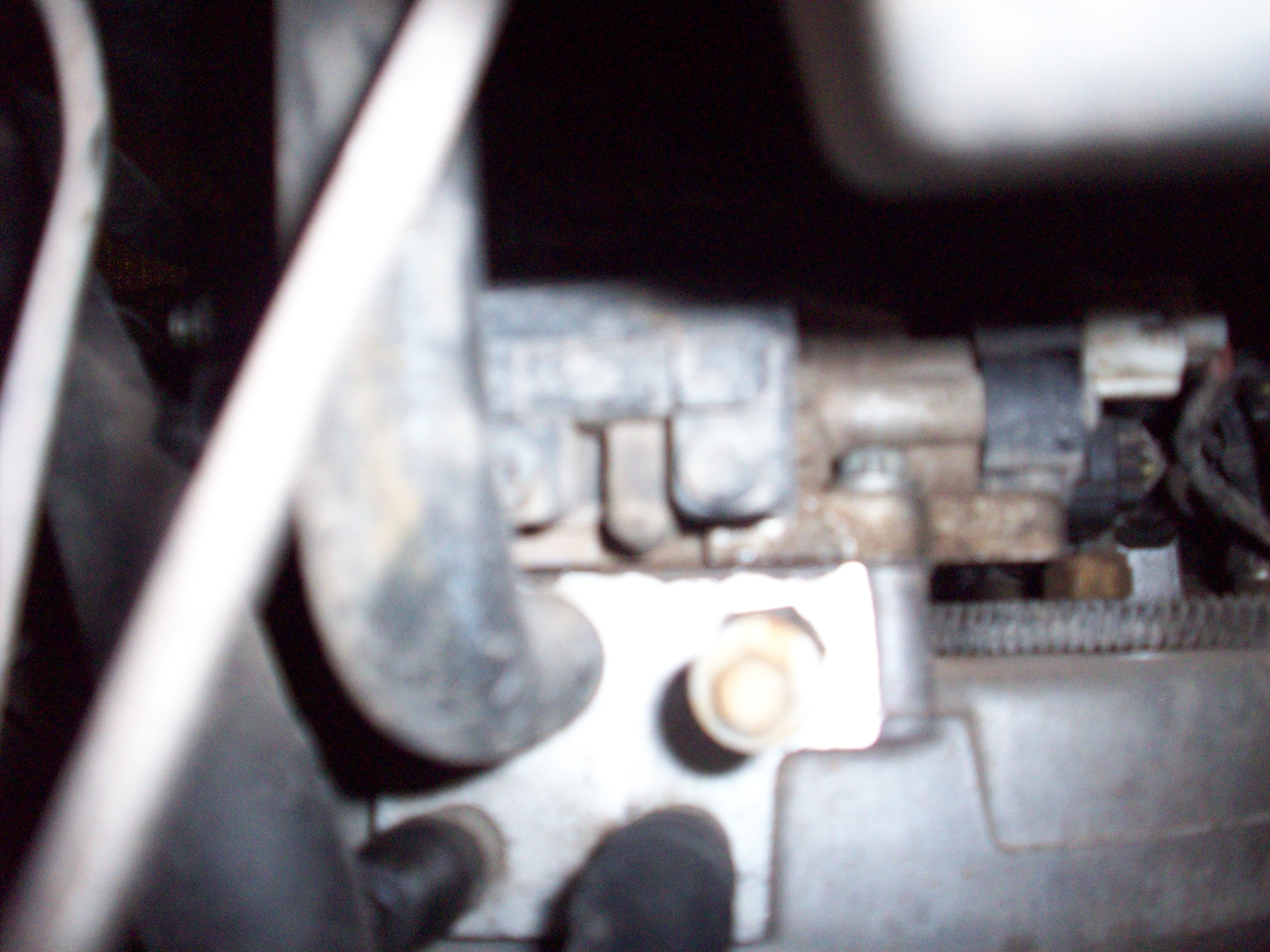

Well.. i Have pin pointed the Vacuum Leak.. and it is on my throttle Body..
I have pointed out in the Pictures Below.. that it is the 2nd hole.. down that Hisses While the Engine is on..

There are supposed to be two vacuum lines in that plug that run toward the front of the intake then towards the driver's fender. Don't recall what they're for. Plug them both good if you don't need 'em.
well i have my laptop right next to my jeep in my Garage, i'm going to try to find any hanging Lines.. and gonna try getting to the bottom of this..
Thank you for your Reply.. 8)
EDIT:
I Found The Right Line for That hole. I just didn't see it casue it was with all the wires..
Well It is Running 100% Better!! Thank You...
So now i just have to Chane a Fuel injector.. (easy)
I am sooooo Relived That , that was it..
thanks for the Help!

hey guys, i have cleaned my battery cables, reset the computer (ECU). and took this picture of the vacuum hoses going into my intake below the trottle body the hose going in at the top left is coming from the brake booster, not sure what its called, the hose on the bottom left is coming from the valve cover, the hose coming fron the bottom right is coming from that black box that i guess is something with the gas tank that captures the fumes? And the top right port that i have plugged up with windsheild wiper hose and a screw is whats missing. any ideas? :???:

Some models have that nipple plugged with a vacuum plug. Some has the emmision line for the purge solenoid. There should also be another line that goes to the firewall with a T connector to the reservoir going under the battery tray and the other inside the cab.
