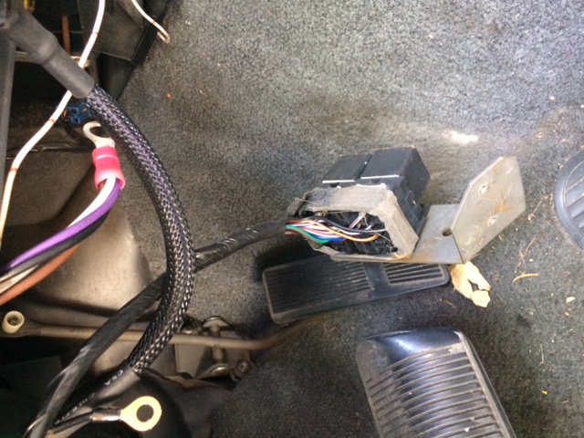

This just dropped out of the electrical area under the steering wheel/above the pedals. It's now just dangling there. I tried to peek around and see where it belongs, but I can't figure it out for the life of me. Also, those two o-ended wires that are unattached- what are those?? Electrical is a mystery to me.

besides the o-ended wires and the fuse/relay boxs hanging down does the jeep run and all functions/flashers/radio/blower fan/windows .. work as well ? if everything works just put tape on the o-ended wires witch I am pretty sure they are not from the factory and find a safe place to put the fuse/relay box and zip-tie it. If your jeep dosnt run or only some things work like k-2 says more info is needed.
This is just a guess but if that block fell down did a screw come out some where they may have all been grounds.

Those are relays attached to the wiring harness, the metal bracket should be screwed to the back of the dash somewhere.
The O terminals are not factory, and are generally used as a ground connection.
