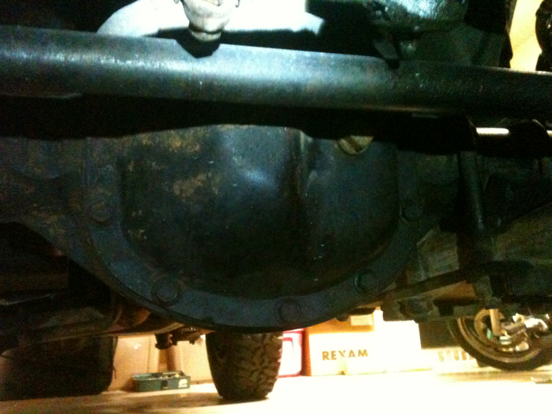

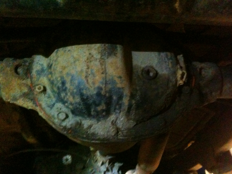

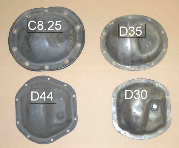

You have a D30 front axle and 35 rear. Your front 30 on the yj's and tj's are actually stronger than the earlier cj 30's. They have bigger u-joint in them. the shafts may even be bigger but not positive about that. I have to be honest with you, I have read and heard bad things about the 35 rear, BUT my dad and my brother both have had yj's with the 35 and my brothers were all lifted with 32's and 33's being the largest tires he ran and NEVER had problems out of it, and we did some pretty rough trails. So I really wouldn't worry to much about the 35 unless you are doing some really tough stuff with some huge tires and a heavy foot. Oh, just a fyI. Dont know if you got a 4 or 6 cylinder but All four cylinder's got 4.10 gears.
