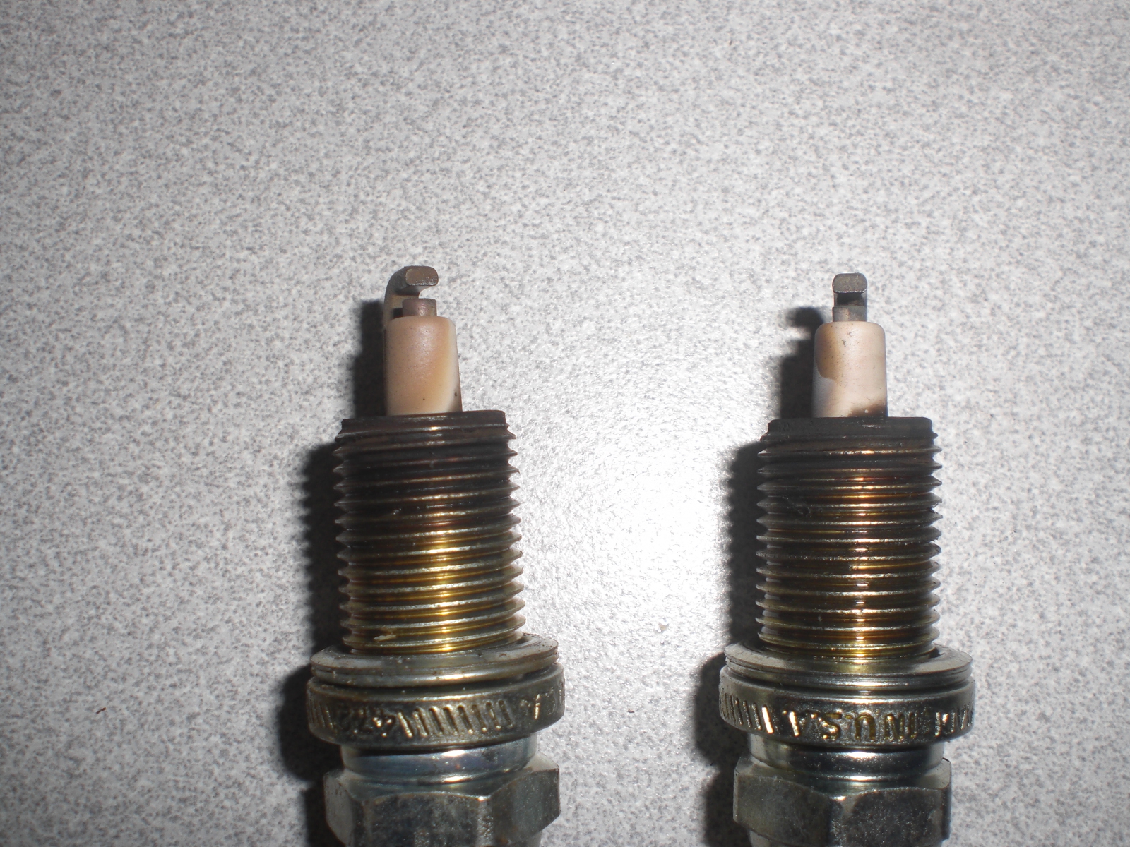

Ok guys I'm home, and i swapped out the O2 sensor. There was a pretty bad crimp in the wire of the old one, but the new one didn't fix the problem. Maybe it was already bad and the new problem is just compounding it? Anyway, I let it run with the new O2 sensor in high idle to see if it would kick down to low idle and stay there, but it didn't. It shot right back up to high less than a second after it dropped. I pulled two of the plugs to take a look at their color, and I inserted a pic of them. Maybe ya'll can tell me what you think...
I held a papertowel behind the tail pipe for about 10 seconds, and it was clean. While it's running, its got a real strong gas smell, and it seems to be getting worse.
Thoughts?

Did you check the old O2 sensor before swapping it out? I didn't mean to imply to just start throwing parts at it. It is impossible to properly read plugs from a photo, but looking at the two plugs you pulled those two cyls. are within the ball park for A/F and no oil fouling. If you can take another photo so we can see the other side of the insulator, it looks kinda black toward the bottom. Then pull the others and lets look at them.

The other side of the plugs looked the same. I'll get a look at the others while I'm pulling these to open up their gaps.
