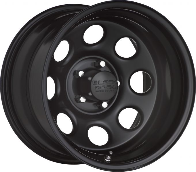

What is your opinion on this set up-35" x 12.5" on 15" x 8" steel wheels
Also with a 3.75" backset.......The less backset the less likely to rub when turning?
Should work, but something that hasn't been said yet is the rear axle. The Dana 35 is weak and 35's can add extra strain, especially if you wheel hard.
