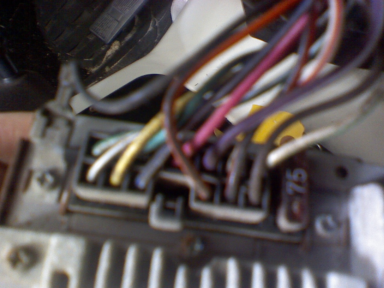

hey im in the middle of wiring a sound bar to a 92 wrangler.. everything in it is bone stock... still have the old stock radio that i pulled out and my question is the soundbar has two wires running from it so after i run it under the padding, under the door jam to the radio, where do i run the cables to in the back of the radio... theres a harness that pops out then a bunch of different color wires? i have no clue where to put these two wires from the sound bar... anything would help.. thanks

There should be a 4 pin connector on the lower right side of the instrument panel with the following wire colors; White/Green(+), Brown(-) = Right rear spk., Brown/white(-), Green/White(+)= left rear speaker.
You mean lower side of the harness or is there a seperate place in front of where the passenger sits like underneath the glove box
It would be around behind the glove box.. the best way to find it is to follow the wiring from the rear of the radio bt using the color codes i gave you.. If you dont find the 4 pin connector to splice into. just splice the sound bar behind the radio.
