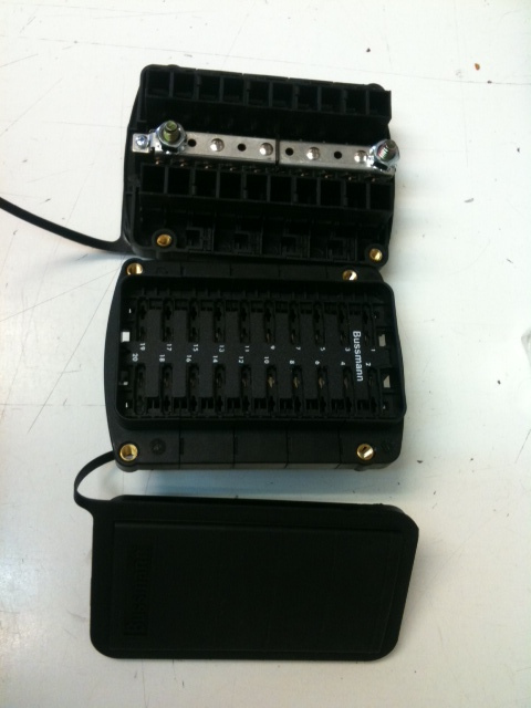

My question, (sorry for my ignorance) can't I feed the 4 gauge into a covered automotive type fuse panel and eliminate all the individual inline fuses? If so, how would I attach the hurkin 4 gauge to the 'hot' side of the fuse panel. Is there such a thing as a reducer for wire?

Update: I think I've found what I'm looking for, just have to adapt my primary wiring. Unit measures 4 3/4" x 3"
Yea that looks like the deal...I did something similar with mine by putting the aux fuse bock in a box with my aux switches...the box mounts on a stalk in front of my center console...If the box is relatively water-tight you can mount it under the hood.

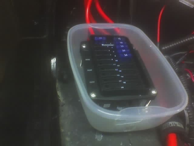

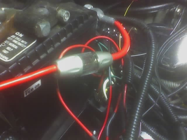

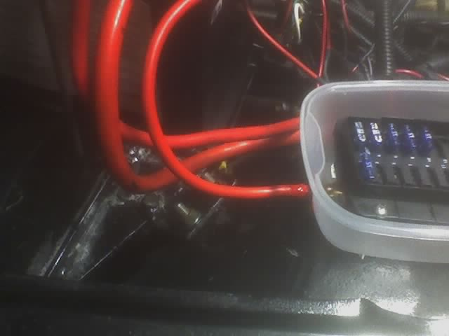

Okay gang, got 'er wired in and it seems to be working fine so far. Ran a 20 amp primary fuse to the 4 gauge, (although I've seen other pages that explain running up to an 80 amp primary) and the accy. lights, electric cooling fan and electric choke are wired in using 15 amp as that's all I had (I'm used to using cylindrical fuses) ;)
I used Plasti coat to seal the primary wire in from moisture, now I'm just hoping the whole thing doesn't warp on account of underhood temperatures.

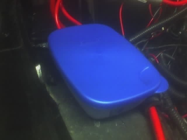

Looks good! The Tupperware fuse box case is a great idea(if it doesn't warp).They stand up to the microwave fairly well so it might be ok.Let us know how it hoolds up.
Im no electrical genius, in fact, I hate it, but isn't putting just one fuse on the 4 gauge side going to cause all of your accessories to go out at once if the fuse blows, rather than having individual fuses for each one? It seems to me that it might be a tedious, and long process, but well worth the work. I don't know. Just wondering because I want to do something similar for all of my extra things that have been going in. I really like the Tupperware idea by the way. Its a nice waterproof touch. I really wish I had someone near me to help with this kind of thing. I really suck at it. And I hate feeling like an idiot.
Prior to cleaning up the wiring in this way I was using in-line fuses which, served the purpose without failure, I just liked the handiness and clean looks of this setup.
