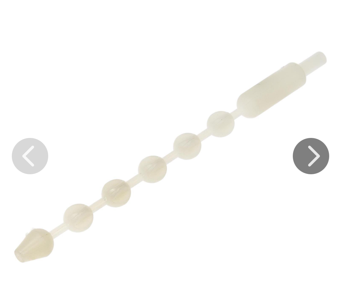

The plastic piece always breaks off after the 4th ball. Here's what the shifter looks like with the broken piece.
The dealership sells the shifter as an assembly. The shifter cannot be taken apart, you WILL break it if you try to do so..
Here's the busted piece removed from the shifter tube, I'm replacing it with, 1/4" steel brake line.
