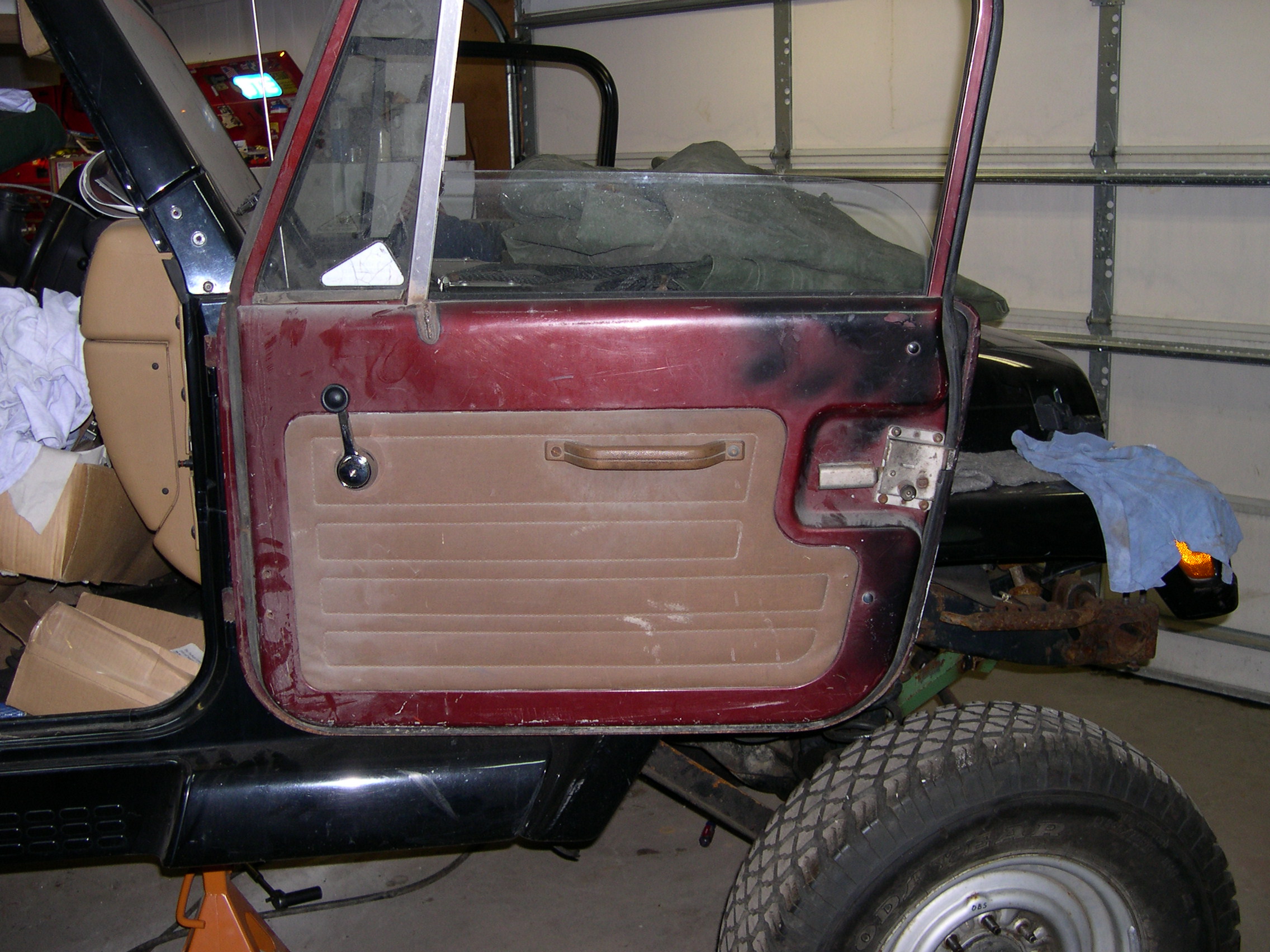

Here is a picture for ya, granted the door is not shut because I have not changed the door latches yet. But the "A" pillar fits nicely to the door.
I had always heard that they didn't fit, but I've never tested it myself. Ggg, would you mind uploading some more photos once you get the proper striker on (or just when you take the existing one off)?
Sure TM what would you like to see specifically? I believe you can click on my picture above and it should zoom in. You can see the door has wing windows which we all know the TJ never had.

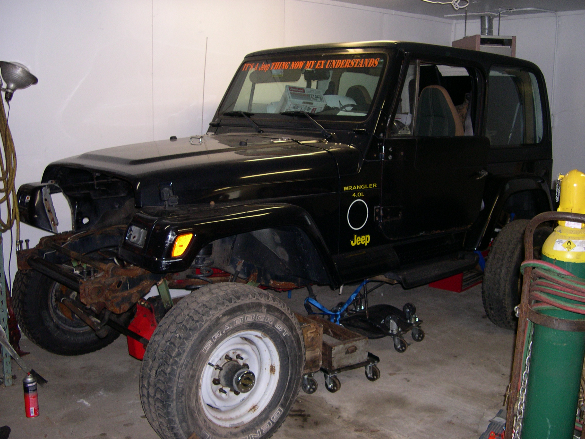

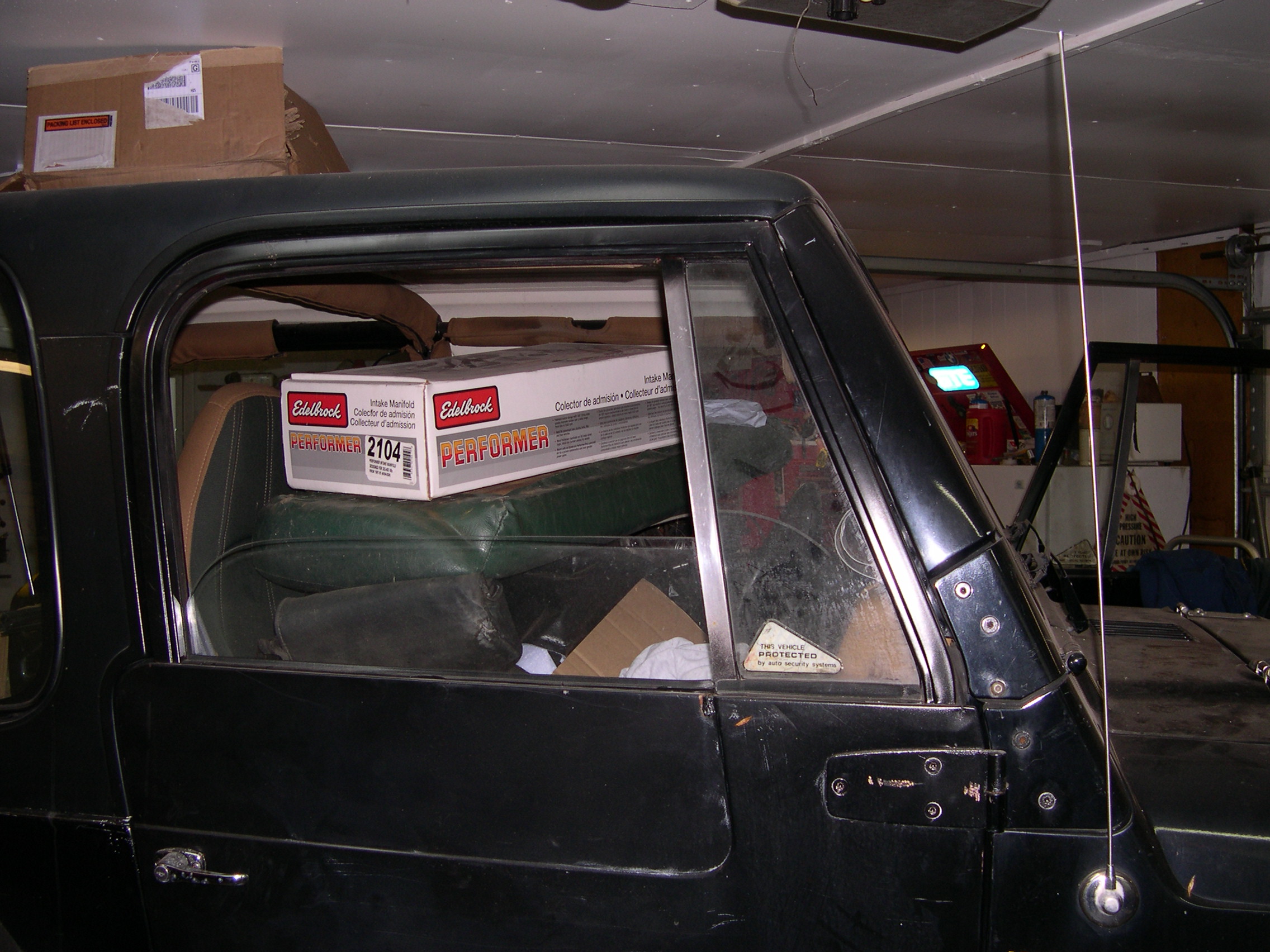

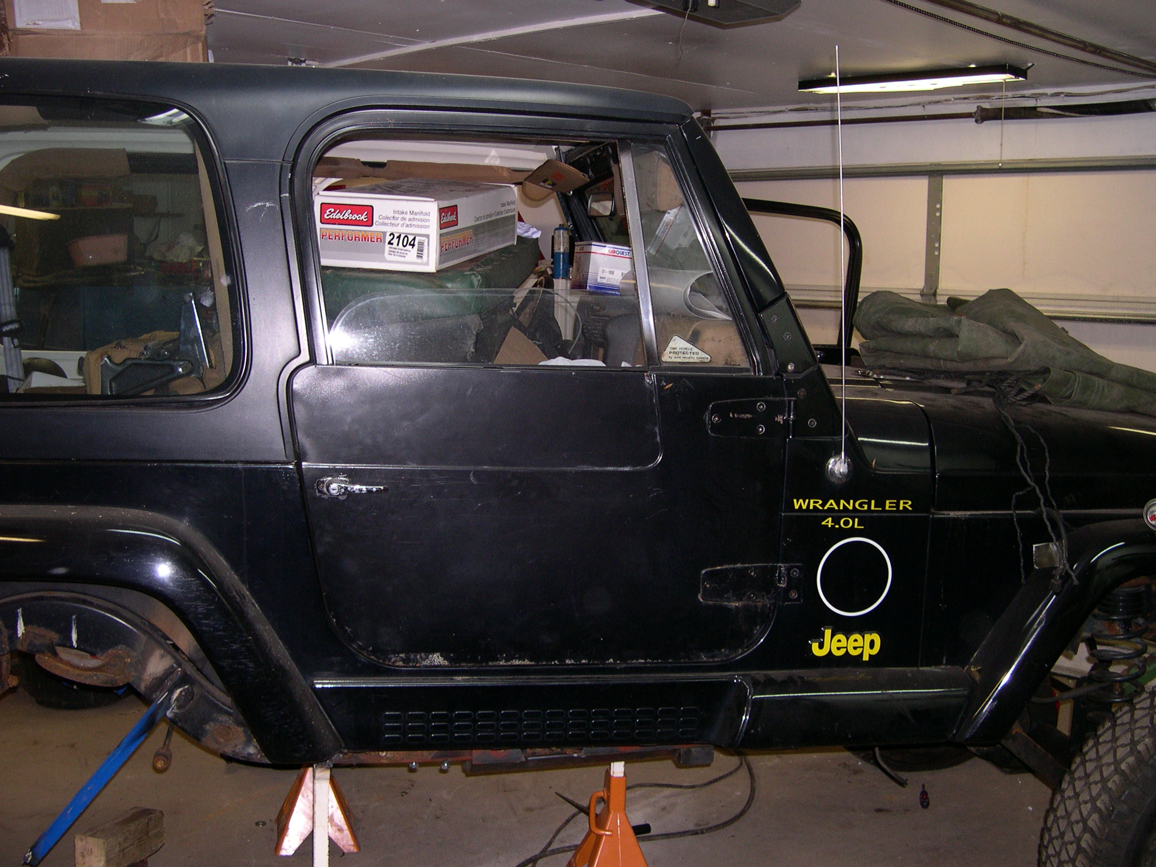

Sorry I took so long.

I suppose truthfully it is not a perfect "Pebble Beach concourse" car show quality fit. But as far as AMC quality Jeep parts go it fits in my book. Literally all I did was adjust the door hinges to get the door gap closer than what it was. I removed the TJ Nader pin, and fabricating a CJ7 style that will bolt into the existing TJ tub holes.
Are you sure those are YJ doors? I've never seen YJ hard doors, but the ones in your photo look exactly like some doors I had on my CJ7. I remember I use to push the button on the side by accident and lock them all the time.
Either way you're right about YJ doors fitting on a TJ. They look like a good enough fit to me.
Sorry for the confusion, those are CJ7 doors. I stated earlier in this thread that CJ and YJ doors will fit a TJ. We all know CJ and YJ doors are interchangeable, but lots of people think TJ was different. So if CJ doors fit then YJ will too. If anybody says they do not fit link them to this thread and tell them to "read em and weep".
