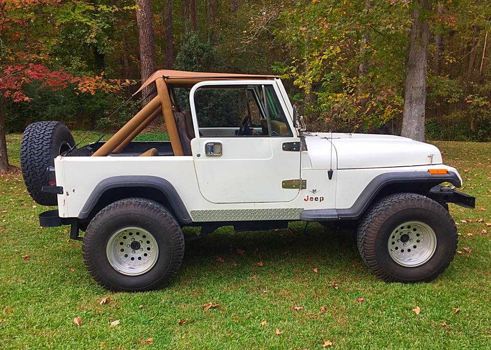

Looking for the best slip yoke eliminator kit & CV driveshaft to throw onto this girl. She dropped her rear driveshaft in the road. Brands or suggested dealers?

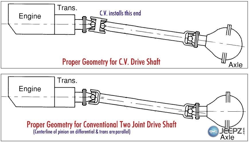

Oh and some SYE are super short so you could run a longer drive shaft. That is important as it changes pinion angle and if you get vibes… needing to fab the rear over upper adjustable control arms…
