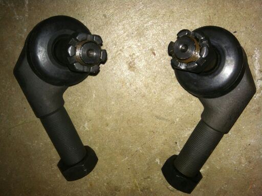

It's the tie rod that runs from the passenger knuckle to the knuckle on the drivers side.
The tie rod on the passenger side has an offset towards the rear on the shank of the tie rod end.
I haven't measured it but it looks like a 30 or 40 degree bend.
I'm considering the possibility of heating it up to the point I can straighten it out, but have some concerns about the tempering of the metal.
Fixing it this way would probably yield a half inch or so of additional clearance, solving my problem.
I'm going to think about it for a while.
I have a cross over steering conversion on my cj that is VERY similar to your yj,s steering. The bent tie rod end on the passenger side you mention is bent towards the front not the rear as you say yours is. You may want to check some photos of yours, as I believe it should be pointing forward as well. They make those tie rod ends with a bent either way so yours may be the wrong way.

If it doesn't moving the offset forward would is not feasible, at least not with the current tie rod and drag link, as it would cause a clearance problem with the drag link near the attachment point, which is close to the end on this system.
