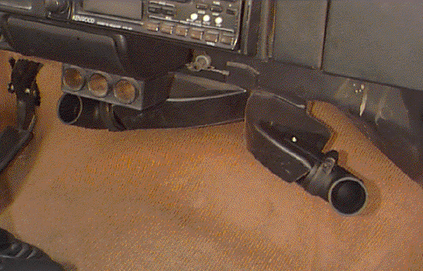

If your heater blows straight toward the shifter like my '88 did, consider getting the plastic duct from the dealer for a newer YJ, like '95. It will direct it into each floorboard and spreads the heat much better. It's in the pic below, minus the round tube.
