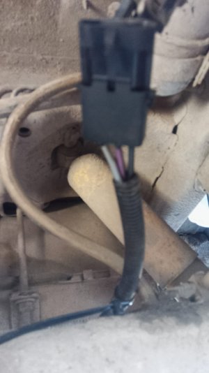

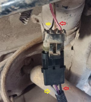

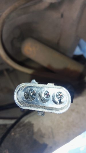

    I have a theory and a question this is more concerning the new pump and wiring that goes to the gauge. When I was under the Jeep taking...

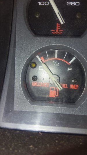

    I have an update, I went to the shop and brought the Jeep home this morning. The image on the original post is what the gauge looks like...

    I am going to remove the gauge from the cluster and take a look at it I know the electronics are good it is just the face or needle...

    Dang, i just saw the little picture in the bottom of your first post. I think it is the gauge but do the test i told you. It actually...
  • superj
    superj replied to the thread Fuel Gauge issue.
    To test the gauge and wire, unhook the wire from the sensor and touch it to the block when the ignition is in the run position. The...

    I am going there in the morning and plan to make sure the plug you see in the attached video is plugged in right and while I have the...

    So its a single connwction sensor? If so. The pull the sensor and check it. It acts like its bad since it pegging to foll deflection
