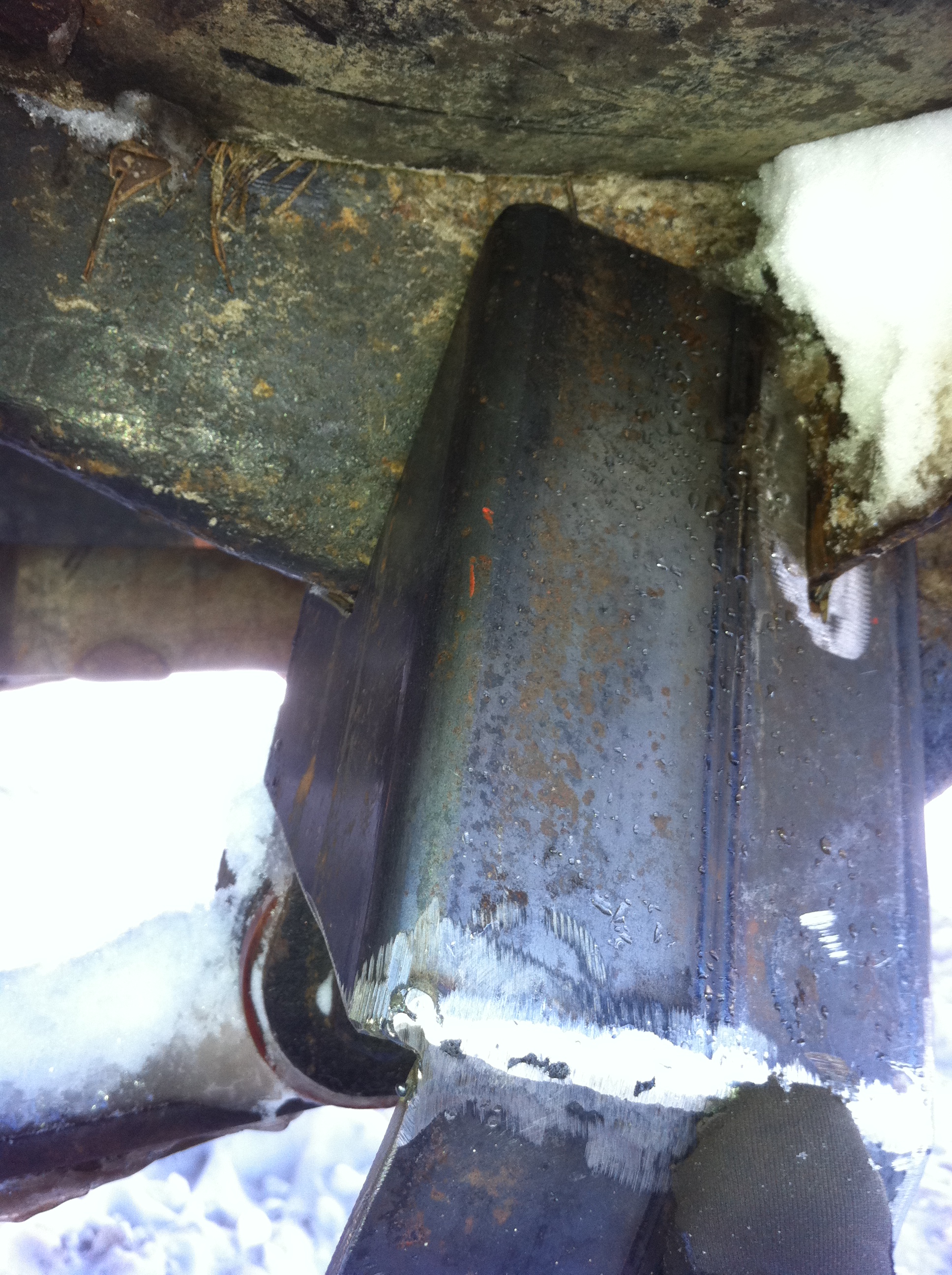

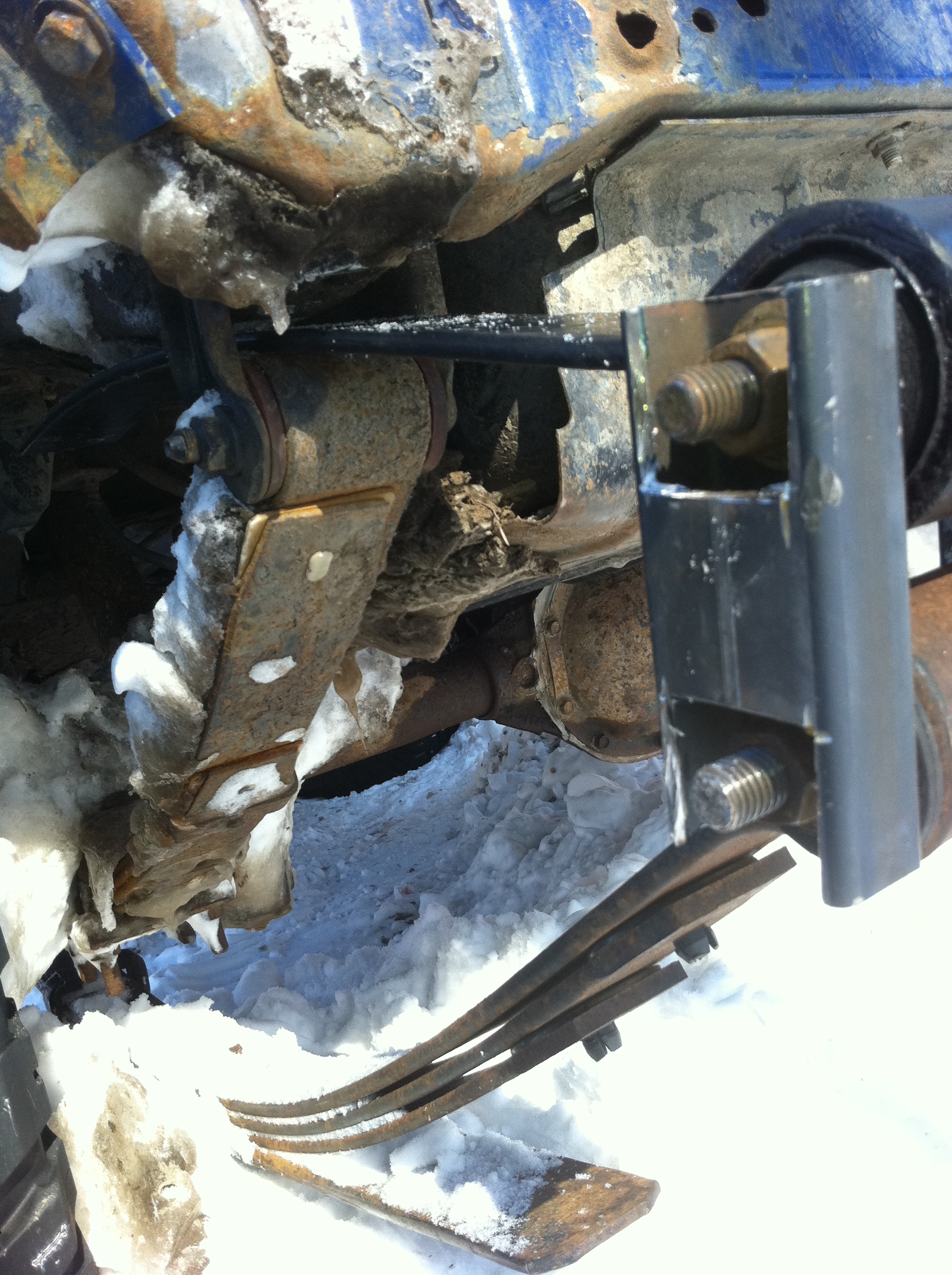

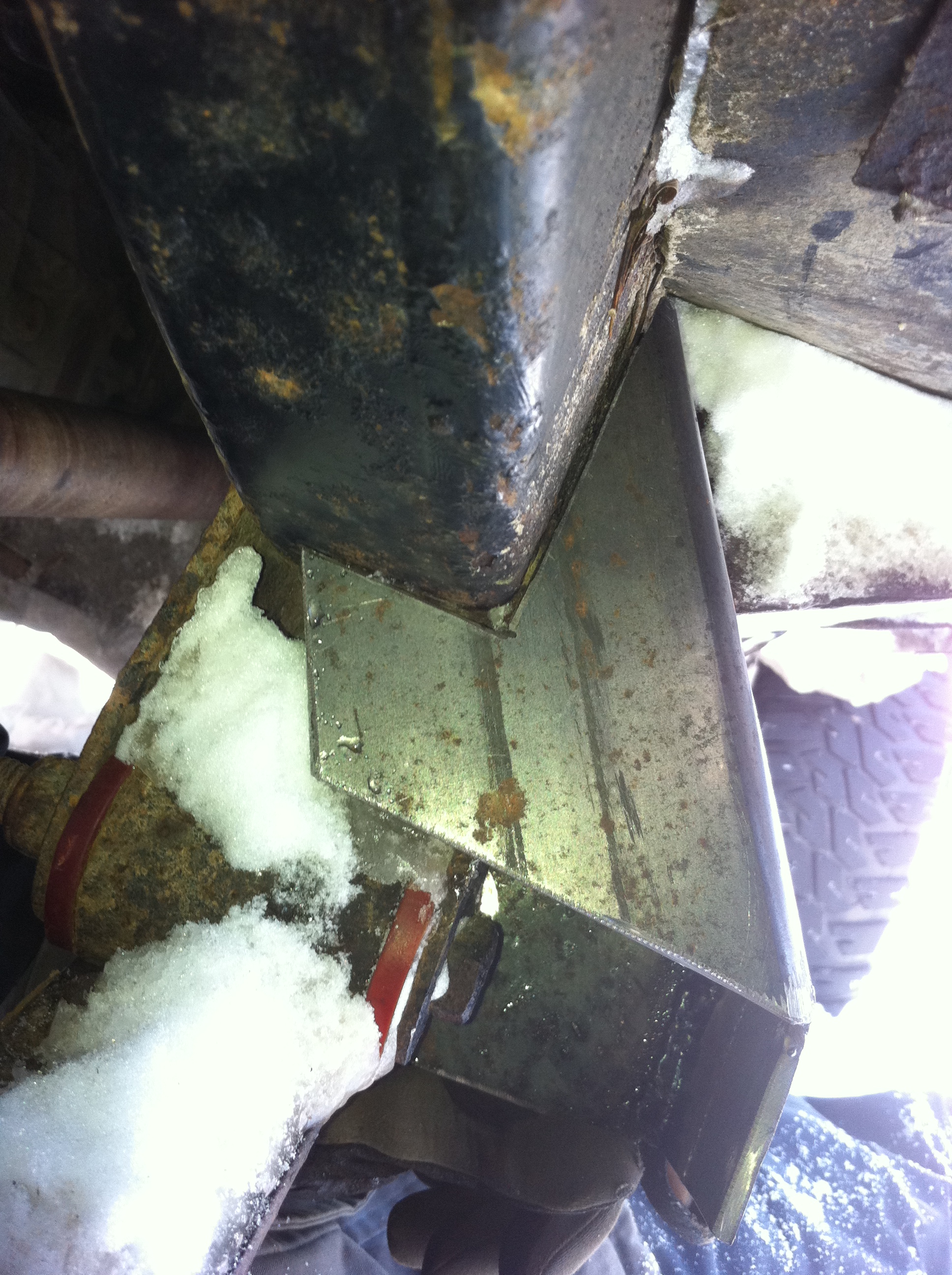

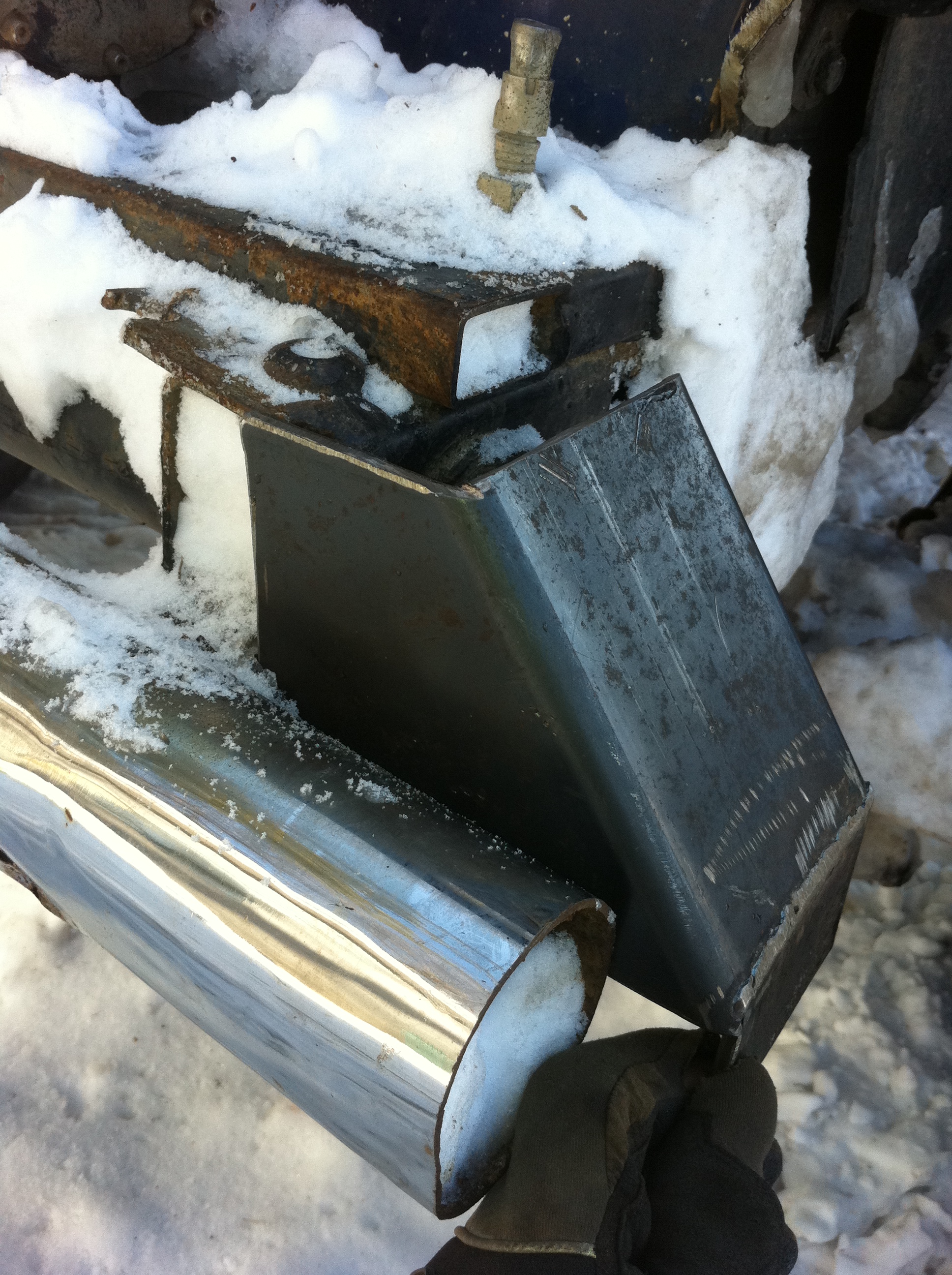

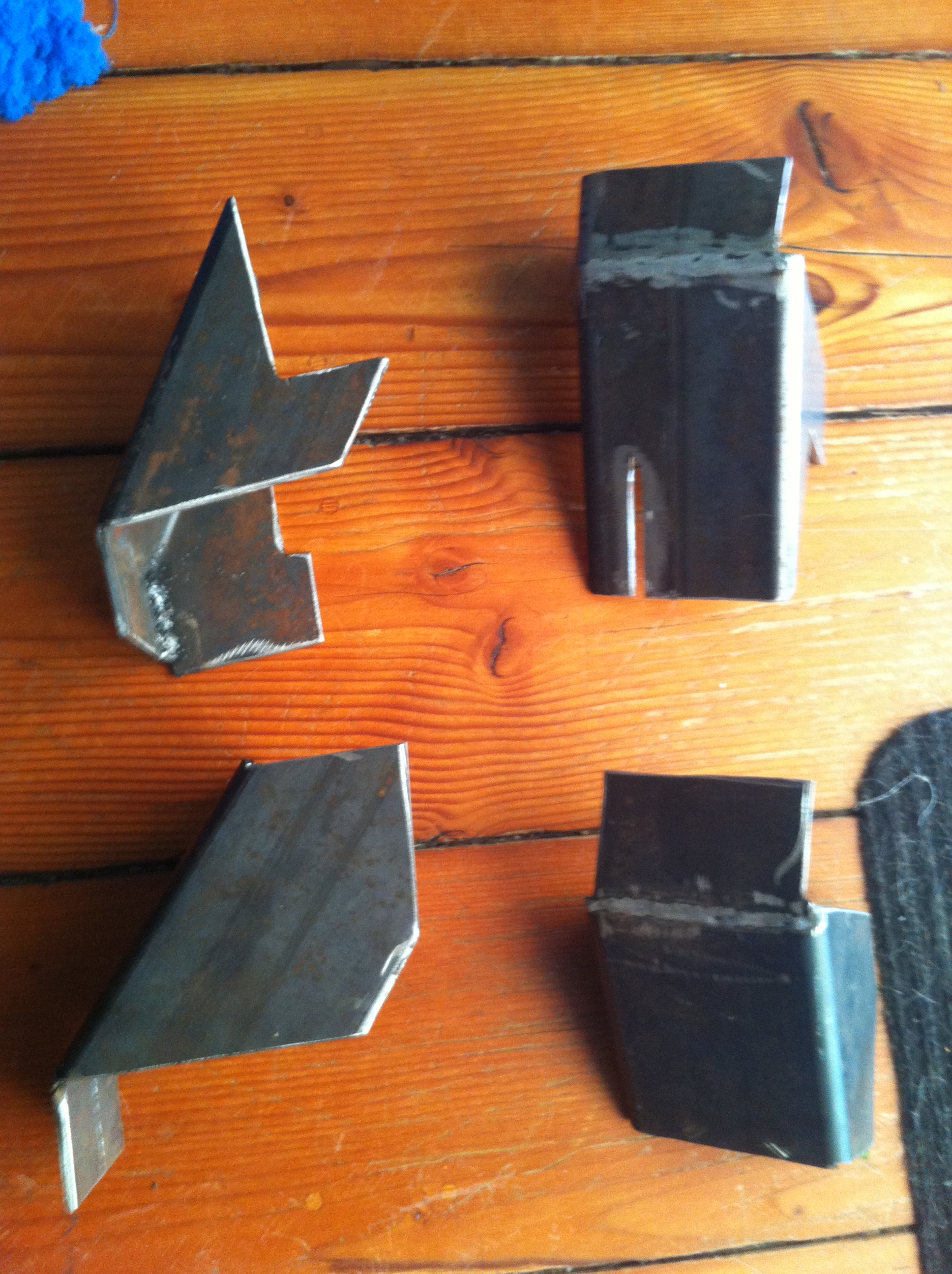

thanks again here sum pics hope there ok!! Ohh ya I dont think i could use sumthin from an astro van ether :lol: but thanks the pics r of the frunt out board brackets that will use half the old mount and the rear new leafs just hangin in place everything about this is budget redneck style nd im proud!!! first build im 22 n everything i no i learned from websites like this n just tryin to figure it out on my own

Being different doesn't always mean your doing it right, or that you are useful.
the way you are out boarding the spings is already adding a couple inches over stock couple that with a 4" spring and SOA, you lift height is gonna be about 13" or so. Way too High.
Your outboarding idea is adequate if you are running a fairly flat spring in SOA, and should fit a 40" tire with out issue. they look like either the ruff stuff or BTF kit. BUT not sure whats going on for the rear or the shackles, but that is some scary looing sh!t.
