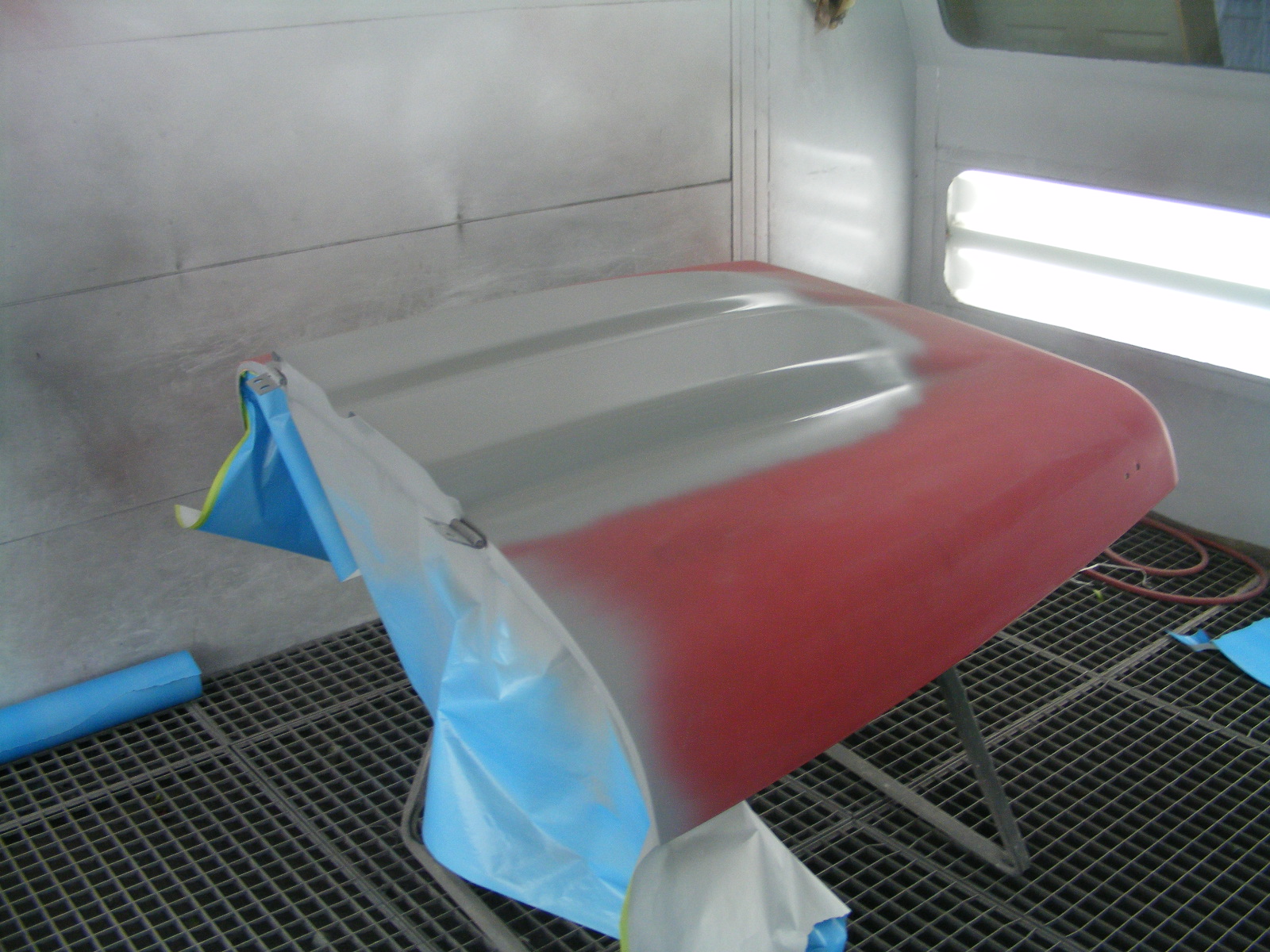

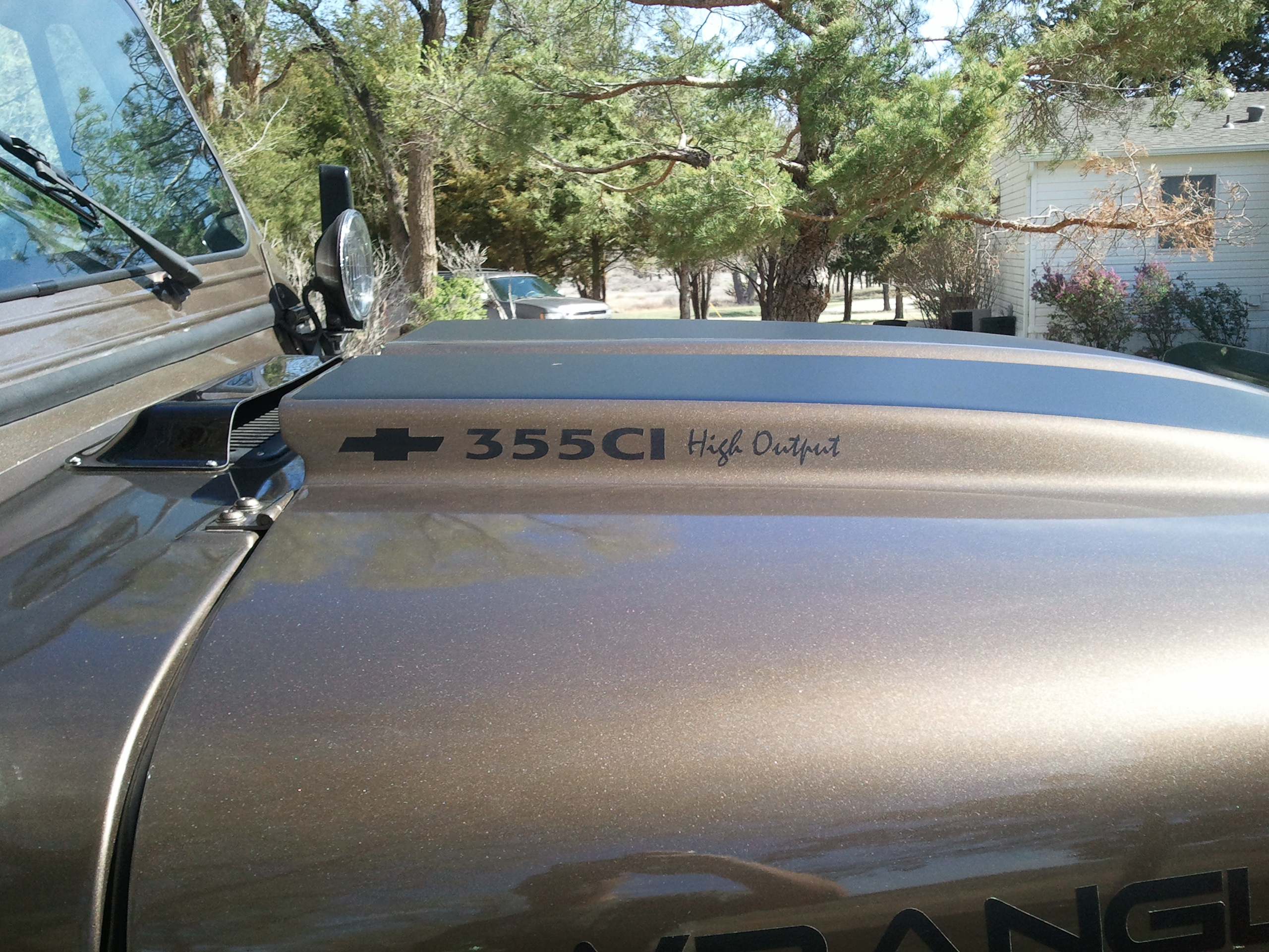

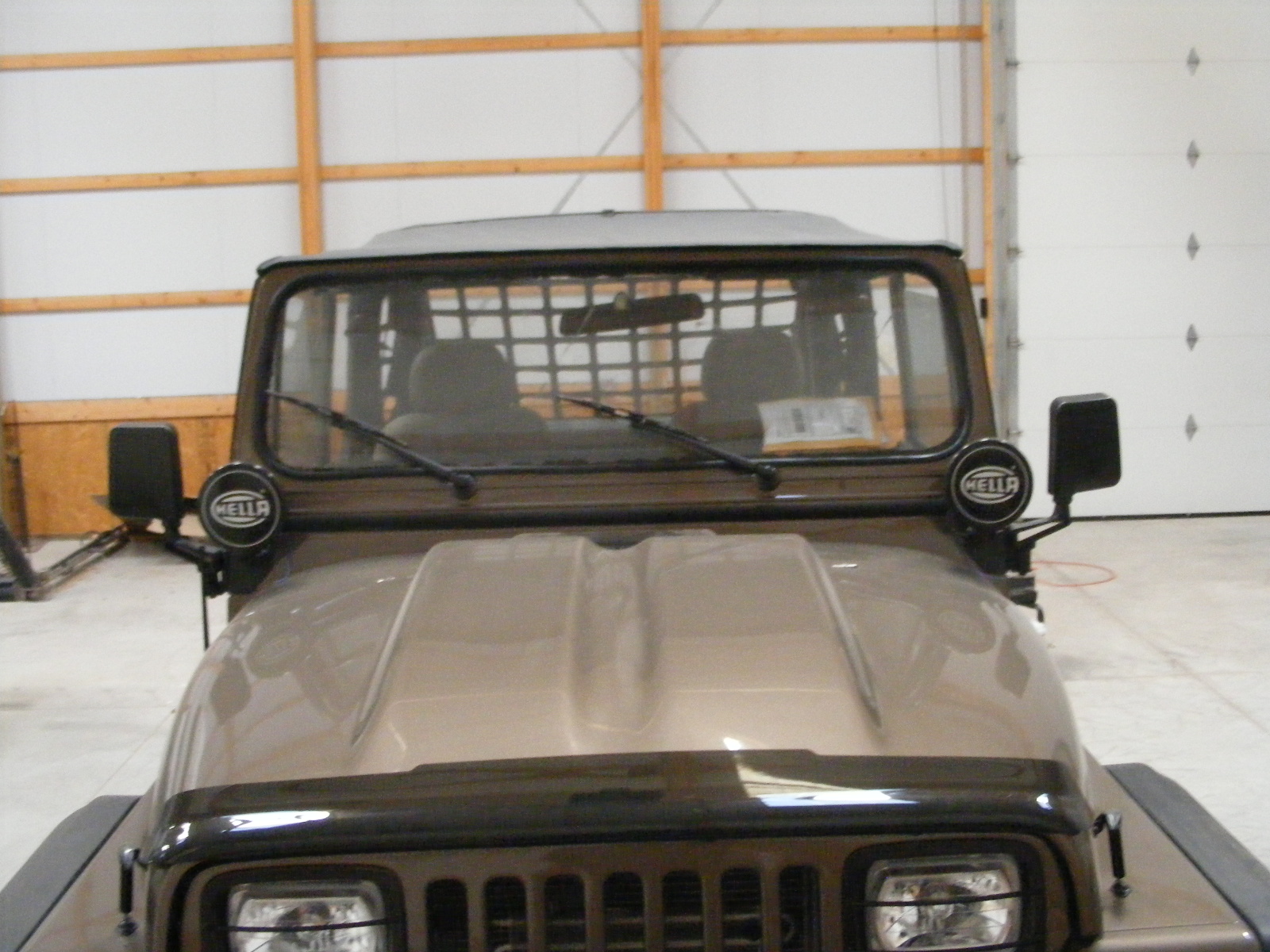

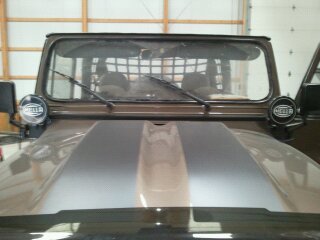

you are exactly right, there was a lot of work involved in getting the hood what i call, "ready to bolt on". It still doesn't fit right either. I just split the difference and i guess i will have to live with it until i can get my local fiberglass man to fix it. I was just hell bent on having a cowl induction hood. I will have it fixed later and while i'm in the process, i want to make the cowl opening a lot bigger. All in all i would have been better off cutting up my stock flat hood also.
Hello, New to Jeepz.com. I feel your pain on the hood. I bought a hood for my dodge ram and I am still not satisfied. So when I was building my jeep I decided to build my own. I hand rolled 16 ga steel into a cowl induction hood. I had every intention of making it functional, but after over 100 hrs of working this I just decided to mount it and I will work it out later. fully welded on the original hood. Your jeep looks great.
That looks super cool. Did you buy or make them your self. If you got them from someone, will you be willing to share the info???? Pleaseeeeeee!
Thank you, Its actually 1 piece of metal. I hand formed and hand rolled each. 100 hrs of work in the hood.
