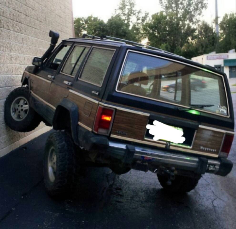

hey im sorry for posting in your comversation but okay i have a dumb question, i dont know how to post on here my own thing. i am just a girlfriend here looking to ask you guys what i should buy my boyfriend for his birthday. he has a jeep xj wagoneer. he has so much he did on it i cant even remember it all. but anyways hes adding long arms to it this week and his birthday is the 7th of october. i just need some ideas of what to grt him... i am already going to dress all sexy for some pics on his jeep lol i just wanna get him a big box of shit for his jeep and keep him happy. trying to soend 200 or less... oreferably less. the oicture attached is his jeep uploadfromtaptalk1411207806955.jpg
Has he ever talked about adding a LED light bar across the top?

I wish I could help you out but I just picked my jeep up less than 3 months ago and have not even begun to trick it out yet. I have been busy fixing the 19 years of rust and wear on it to only find out I have a starting issue......:( Sorry I could not be of further assistance.........
As a guy, I think he would enjoy the pics of you in front of the jeep. I have found that buying things for the jeep is not always straight forward and depending on what it is your trying to do, often changes the scope of the project.....Good Luck!!
