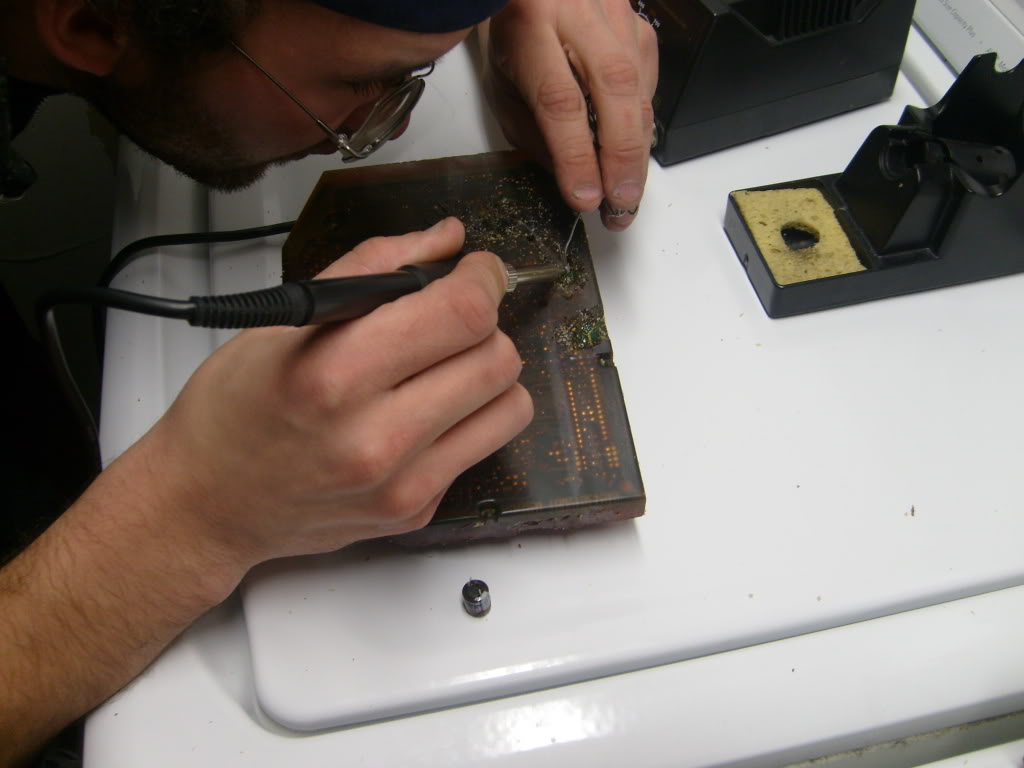

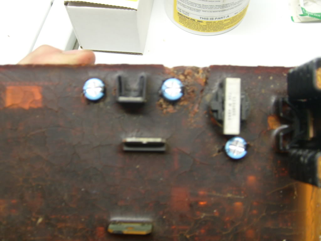

6. now heres were it gets tricky. locate the 3 capacitors on the top of the ECU

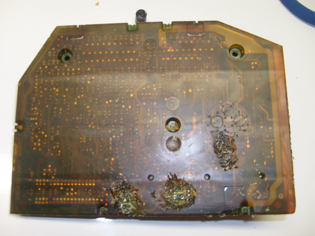

7. After locating them you have to dig out on the underside of the ECU to expose the ballistics encased circuit board. Its a tidious task but it has to be done to get the capacitors out.

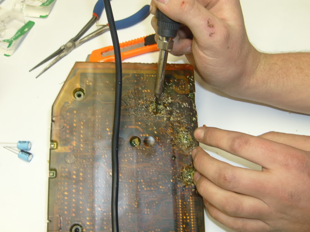

8. now that the contacts are exposed take a soldering gun and melt away the factory solder points, have a friend grab the contact on the top side and pull as you melt the solder.
9.After you get them out take the gun and put it were the contacts went through to make a hole for the new capacitors to go through.
10. now its time to put the capacitors in, make sure that the side with the stripe is facing the big metal tower (reference picture)
11.push them all the done and solder them on the other side back in the original place making sure the stripe is facing the correct way.

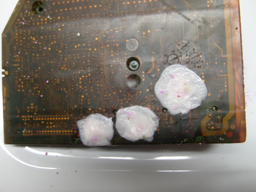

13. take putty or silicon to reseal the holes wait for it to dry and follow the take out procedure in reverse order.
