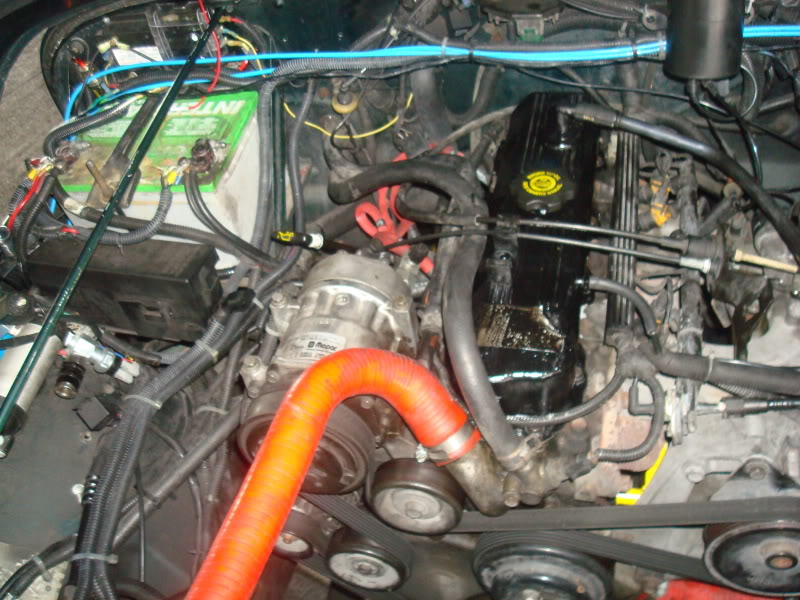

I just bought a marine panel from eBay and put it under the hood on the firewall; it has 6 ports and carries spares inside. You can somewhat see it in these pics; it's behind the battery (there are 2 boxes there; the left one is the fan controller and the right one is the fuse box), and you can see the yellow and red cables going into it... It's the one with the clear plastic cover.
