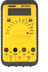

To track down the short switch the multi meter to current.
Put the leads in the meter where you could measure current. Some multi meters have only two places for the leads, others have three common (black), measure voltage or resistance (red) or current (red).
Disconnect the positive battery terminal
Clip or fasten the red lead on the positive terminal and the black lead to the positive battery cable.
You should see less than 100mA with the car off. (Memory for the radio)
Being you have more current draw when the engine is running you could switch the key to on position.
With the ignition in the on position with the engine off you may see more current as the fuel pump will kick on.
Find the fuse box and start to remove fuses. Start with the radio. Watch the ammeter for changes in current.
This method will tell you what circuit to look for the short.
Once you find the circuit, check all accessories on that circuit until the problem is found.
Here is the meter I use.
PS start on the highest current setting.
