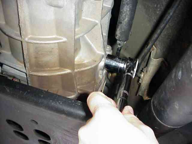

im in the middle of swapping out my ba10/5 and np 207 for a AX-15 with a 231, here's the problem, i dont know where the fill plug is, i think its on the left hand side but im not too sure, im also having trouble finding where the vent line goes.....after i find this out, im hoping that it will go in without any problems, are there any things that i am going to have to modify to get it to fit properly?

The fill plug should be half way up the driver's side of the transmission, similar plug to the drain plug. Don't remove any plug labeled 'Do Not Remove'.

Fill plug:
