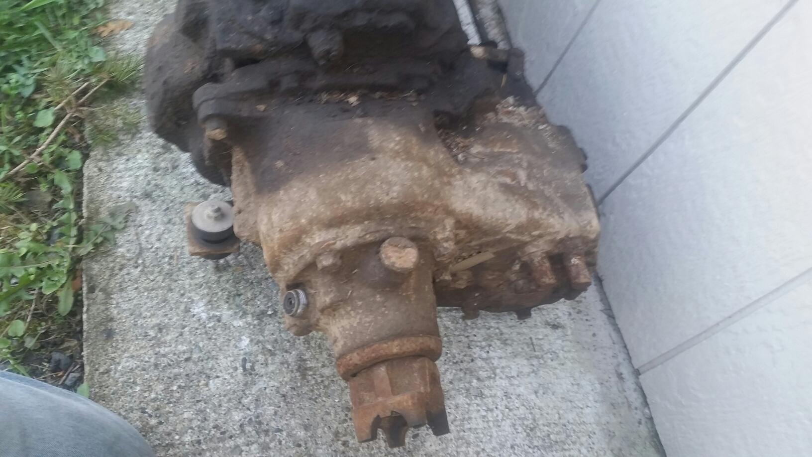

I have decided to go with a chev 350 turbo. After pricing out all the adaptors and clutches and what not. I have found it cheaper to go with Turbo 350. Does anyone know if a Dana 20 will bolt to a Turbo 350 transmission.
From what im seeing both the th350 and th400 will need an adapter for the dana 20 case. a GM 205 tcase would bolt to your th350 I think and is much stronger than the dana 20, but low range in the 205 is terrible for crawling.

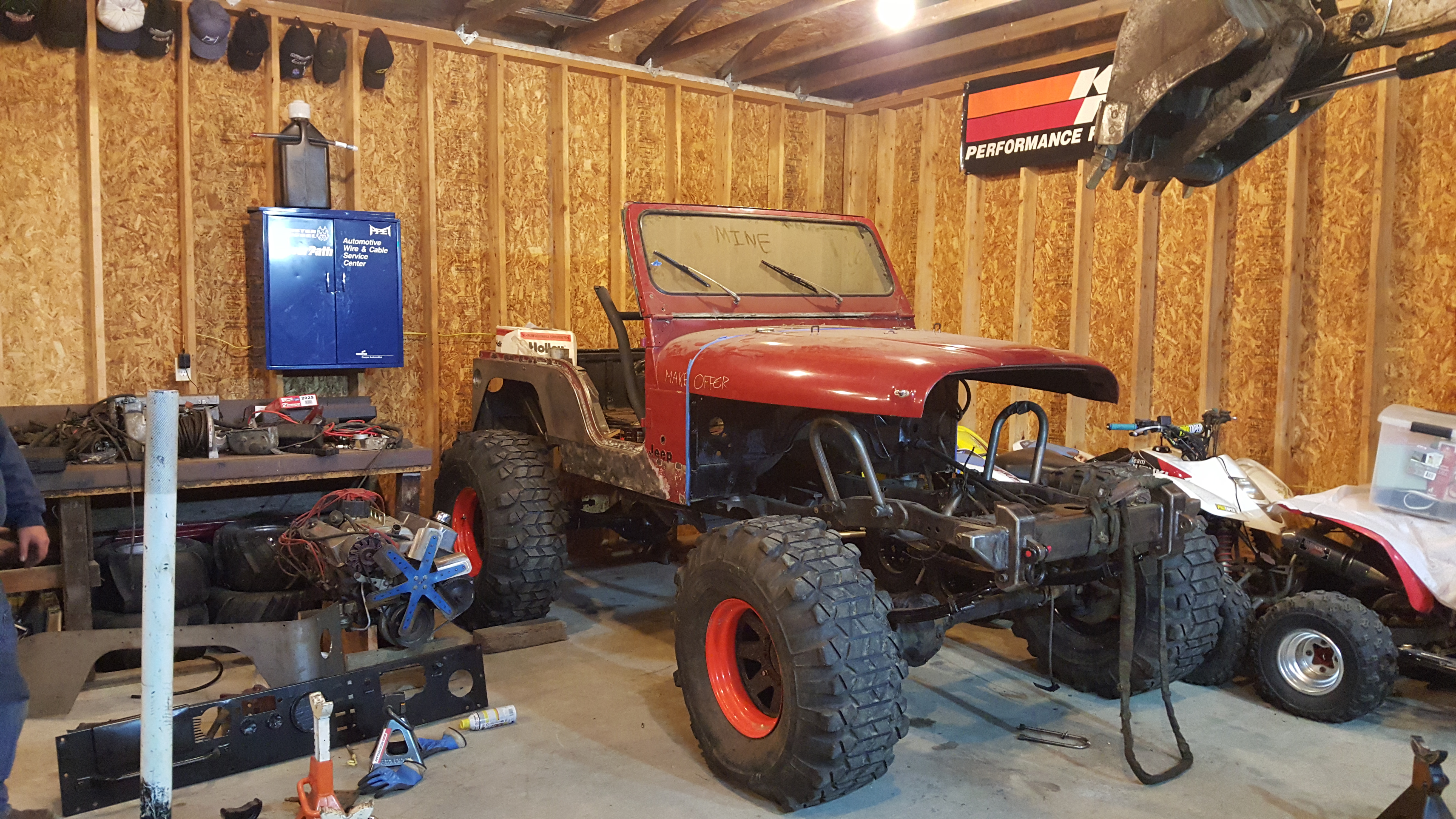

is there any engine, or manual trans. that will fit up to a 94 yj with 4cyl trans.?
ill look up those numbers you mentioned. I have several 4 bys. - I can part out. chev s-10 not the full size. ford ranger and​ F 15O. the only proper ford eng. is the 200 six or the ranger 4 cy. (which worked good in the woods, but not on the freeway. all the 200 six eng. wi require o-haul). vinn

Not many options. SM420 Swapping a SM420 into a Wrangler
You can also use the AX15 from behind the 4.0L if you use a Dodge Dakota 4cyl bellhousing.
