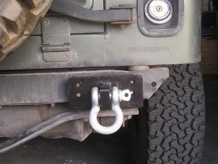

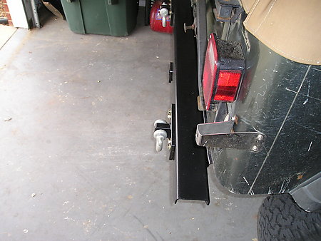

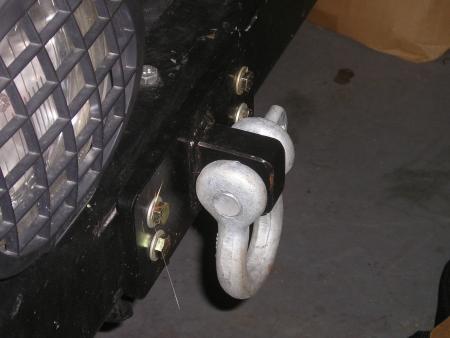

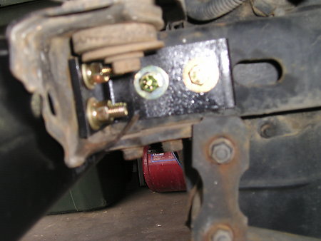

I had some brackets made for my front bumper. I used angle iron bolted to the frame on either side to tie the brackets into the frame, and they bolted over the factory flat steel bumper. Not sure what a TJ bumper looks like, but pics of my setup can be found here.....

Most of these are for the rear bumper, but the brackets are pretty much the same with the only difference being the mounting holes on the rear were not quite centered on the bracket so the brackets would line up using the factory holes in the crossmember. The front brackets had the holes equidistant from the top/bottom/sides of the bracket and the angle iron pictured was bolted to either side of the frame in the front behind the stock bumper.
