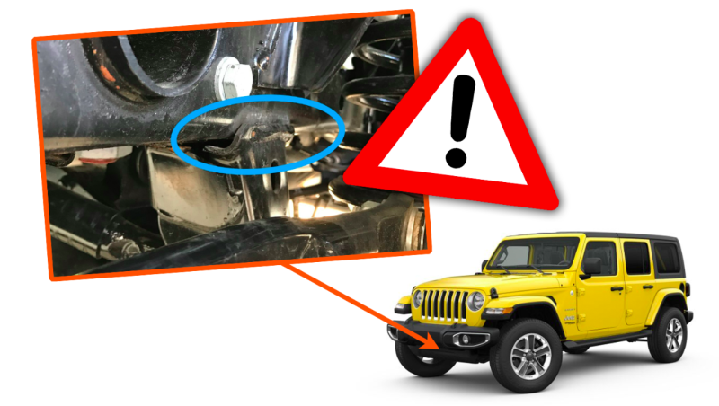

This really makes FCA looks bad. I mean, I understand it's the first year of a new model but I saw some pictures where the weld missed the piece it was trying to weld completely. It was maybe an eight of an inch too high. That no one caught this is incredible. Hopefully they will resolve it quickly.
Here is an image from Jalopnik

How dealers will fix this problem:
To prep the outboard weld to be repaired by the weld specialist, dealers are asked to disconnect the battery before lifting the Jeep, remove the left front wheel, undo the track bar nut and bolt shown above, and then take the track bar off of the poorly-welded bracket on the frame.
From there, Fiat Chrysler says its “Technical Weld Specialist will perform the repair on the outboard weld.” There are no further details on how exactly the specialist will conduct the fix, but clearly the job will involve welding that bracket back onto the frame somehow. Fiat Chrysler told me via email simply: “Weld will be made to comply with specs.”
Once the weld specialist’s job is done, dealers will bolt the track bar back onto the frame (with a new nut and bolt), throw the wheel back on, lower the Jeep, torque down the track bar nut to spec, and then give the vehicle back to the customer. That is, unless the inboard weld also needs to be fixed.
