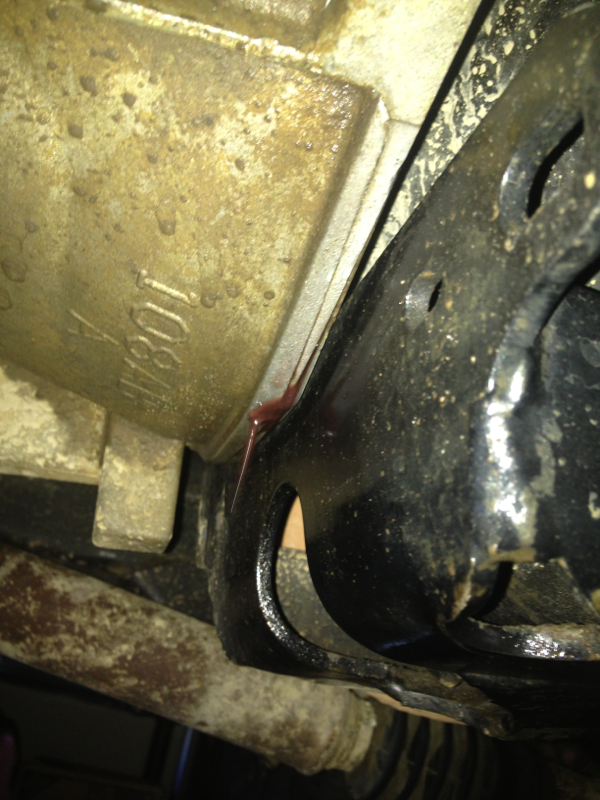

Still leaking. From when I turn the ignition until it is warm. I assume the heat is sealing the leak. I notice no difference in shifting and I am getting better gas mileage since adding Lucas (lol). Caught ATF mid drip in the pic.

Am I understanding from greg92jeepxj that you think I need to replace the trans? You don't think replacing the front seal to stop this leak should be my next step?
Let me not speak too fast , from the experience mom and dad went through , they bought second hand a 2000 jeep grand cherokee that was GORGEOUS . Then my brother changed trans fluid well after the purchase . Sometime after that , the leak surfaced . Yes , Lucas or something else was in the trans prior , but not after the fluid change . Then the symtoms , codes and engine temp rising. My dad said " ok , I'll follow the guys advice " and changed trans. The guy did right with a '95 pathfinder , so my dad trusted him. It worked out to this day . The shop owner said that the trans has to come don anyway , that's labor , and you want to trust seal replacement on a vehicle you know little history ? He showed my dad how many jeeps with that trans had that history . Enough said. I guess I should ask more jeep owners of your model of search that trans and that year if is a common problem close enough to get this kind of forum attention .
I can only say , I hate to see you spend the money for a seal job and have it backfire. Lets tread carefully before proceeding how other jeeps of your year and model fared. I want to be sure too . I don't want to make you spend money on half a glass . I have only the previously posted experiences to speak of but I respect its your money and time that I am potentially spending.

It's becoming that there is a deeper problem, it may be the pump that is right there where the seal lives. My '92 with 168,000 + miles is not and has not leaked from its front desk. Why would this 2006 with presumably less mileage has such aleck ? There must be some TSB's to supports this problem. I cannot see a 3.00$ or so seal fixing it. There can only be a solution found in a reputable tranmission replacement . What say all ?
50K miles on this auto transmission, and I do NOT drive it like a rental. The check engine light has been off for several days now (at least 3). Feels like it shifts the same regardless of whether the light is on or not. I would go so far as to say it is shifting better. I had been hanging out in the 2k RPM prior to the Lucas, now he rides at 1k-1500 (I have changed my tire size from the factory 30" to 33"). I'm also getting better gas mileage sine the Lucas; a good 2-3mpg better! Still a leak. I have put a qt in total since the fluid change.

The leak is getting worse. Started keeping a drain pan under him when i parked. I finally folded. He's in the shop getting a new front seal.
It is our highest hopes that a replacement seal does justice to this leak , which now is of magnitude . The expense has gotten to the point where this repair HAD BETTER work by the owners personal feelings. We of course hope to see soonest a good report to the owners satisfaction . Heaven forbid that there is the need for attention in the future with regards to this model transmission for this vehicle or any other member(or non-member) ,
