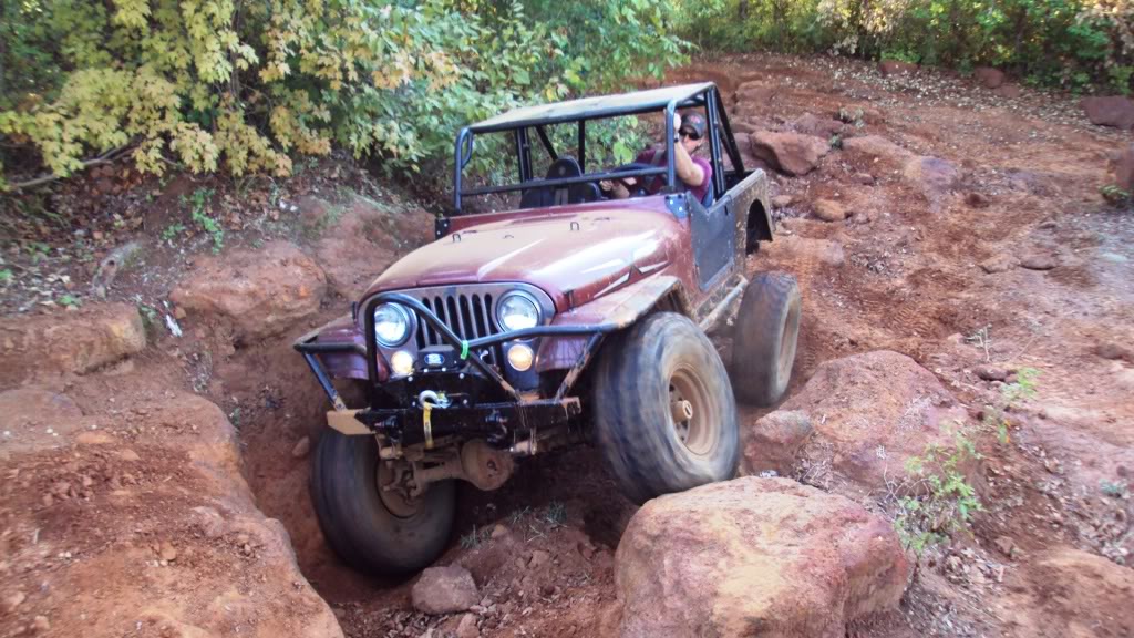

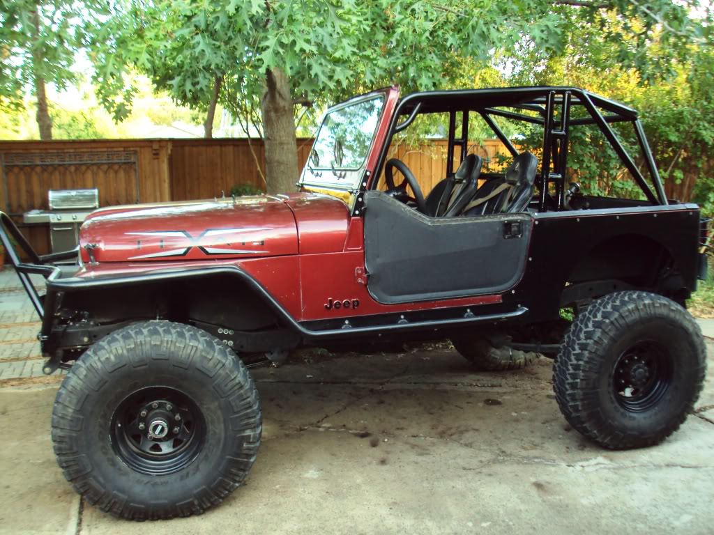

I am on my home PC now, here is a pic of what I am talking about. stock fenders with metal flares, they are tied together to prevent the fenders from crushing the grill or tub, these particular ones, which may not be clear, but are also tied into the rocker guards. This jeep has been laid on it's side, hard and there was no damage to teh grill or tub.
Dosn't look to appealing to me. What about the rear tires? Looks like you may have an issue with your break cylinder on the rear passenger tire.
