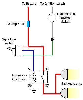

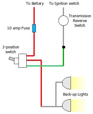

Hi,
Because a schematic is worth a bunch of words, here's two I drew up (below).
Schematic 1 is for hooking up the reverse lights to a two position + off toggle switch Without a relay. This circuit is designed for use with the stock reverse lights:
This second schematic is highly recommended for use with any after-market backup lights. It uses a relay to switch the lights and therefore is safer for larger loads:
NOTES: Gray Lines represent exsisting wiring. The thicker looking lines are meant to represent 18-14 gauge wire, while the thinner lines are meant to represent 22-18 gauge wire. It is important to use AT LEAST 18 gauge wire for stock lights, and 16-14 gauge for aftermarket. The relay coil trigger circuit can safely use 22-18 gauge wire as very little power goes through it.
Have fun :mrgreen:
-Nick :!:

Hi,
I forgot to explain that BOTH of my schematics will function as follows:
Toggle switch position 1: reverse lights function as normal, anytime you are in reverse gear they are ON, otherwise they are OFF.
Toggle switch position center: Reverse lights DO NOT function. This over-rides the transmission switch as well.
Toggle switch position 2: reverse lights stay ON as long as the switch is in this position, everything else is over-ridden.
