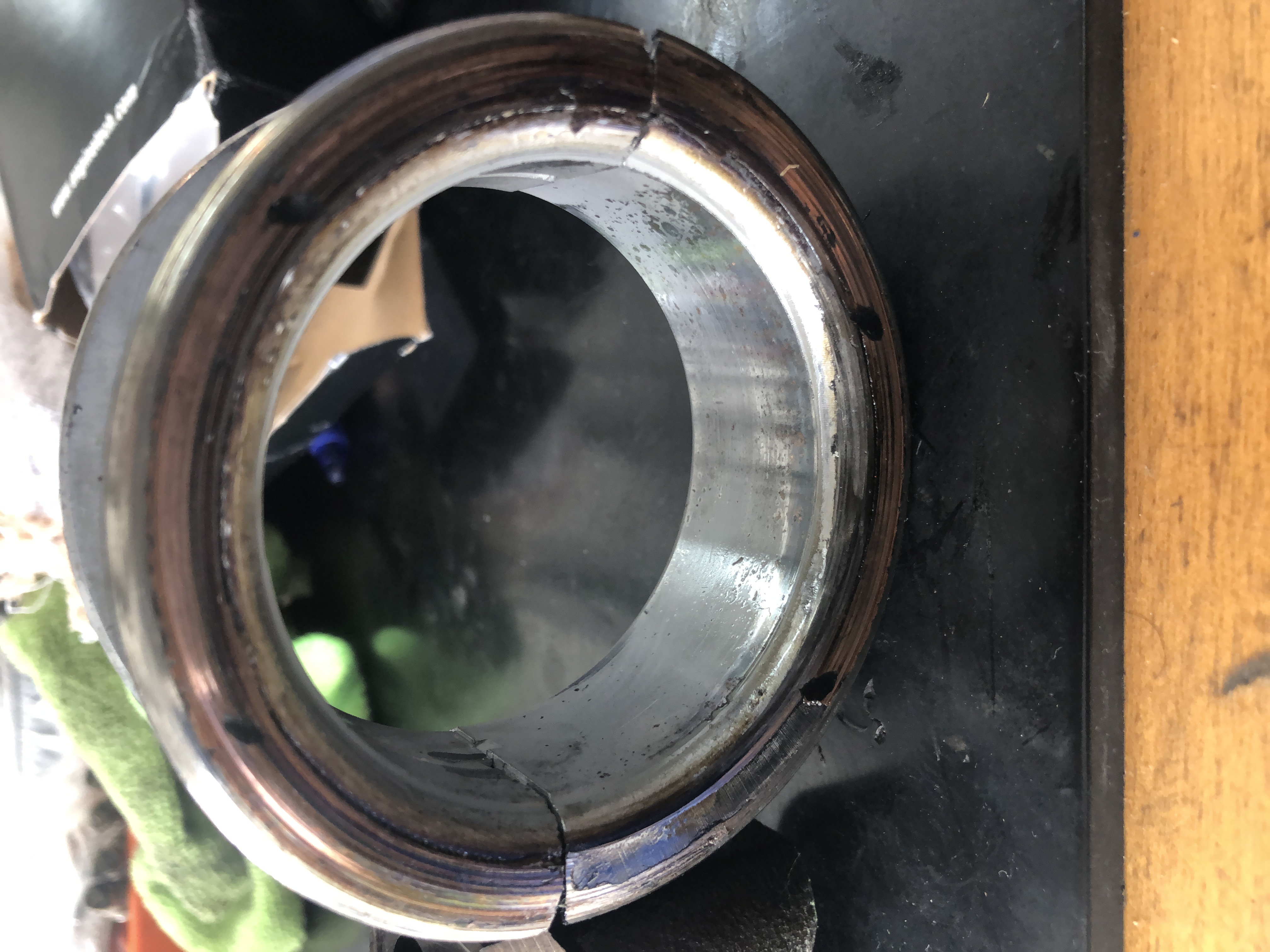

Removed and replaced the # 3 main bearing ( the Thrust Bearing ) the rear of the bearing is worn very thin. The crank is also worn, but that's for another day! The crank had .118 fore and aft movement, I am hoping this was the source of the "knock".

This thrust bearing is not a new issue in this Jeep. I replaced this same bearing maybe 50 thousand miles ago. Something is causing excessive forward pressure on the crank while operating. No one has been able to give any insight as to why the transmission would pressurize causing pressure onto the crank.

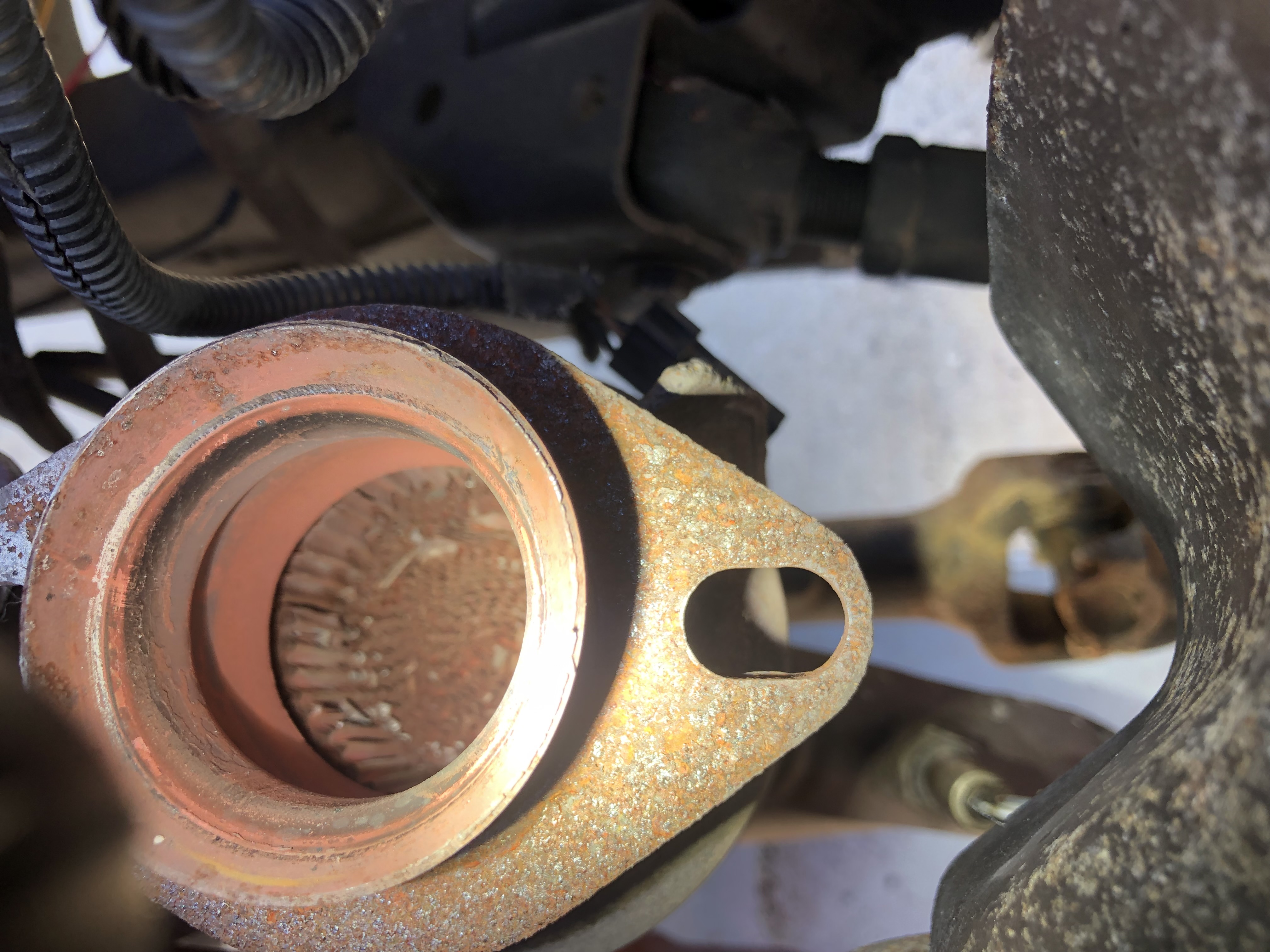

As for the source of the "knock". Upon inspection of the exhaust. When I removed the manifolds I was able to look down the exhaust tubes. This year of the TJ has 3 Catalytic Converters. The front cat (cylinders 1,2 and 3) looks pretty full of corrosion and crap! The rear cat (cylinders 4,5 and 6) is corroded, gone, missing, rotted away! All the guts from that cat went down stream lodged into the main cat down stream. With the uneven exhaust flow in the system the debris was pulsing (knocking).
A new exhaust system has been ordered, that will be the last piece of the 205,000 mile puzzle!!
