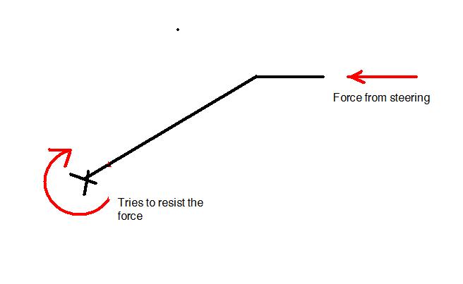

Here's the deal, I drew the s arm, kind of. Where the x is, is where the arm bends again to go to the knuckle.
A moment is a resistance to rotation, in this case the rotation is the rotation is being caused by your steering box pushing the S arm. Or your tire pushing back, whichever.
A moment, is created when you have a force offset from the material it is passing through, it's like a big lever. Lets say there is a pole in the ground, and you try to push it over. If you are pushing on the pole 5 feet up with a force 100 lbs, the pole has a moment at its base of 500ft/lbs. A moment is a resistive force.
In the case of the S arm, the resistance comes at the bends and is due to the offset of the arms design and the pushing on the arm by either the tire or the steering box. If your S arm is offset by 2 feet, and your steering box puts out 200lbs of force, you are creating a 400 ft lb moment around a tiny point. That's the problem. When your steering linkage is straight, you don't have moments, you have a force going straight through the rod to the steering knuckle.
The S arm may hold for a little bit, but if you happen to slam your tire into something, or fatigue the material over time due to the constant moment you create everytime you turn, you're asking for trouble. When you finally overcome the moment at the bend, your system is no longer in equilibrium and you will wind up with a Z arm and not an S arm.
I'm an engineer, screw your water towers.
