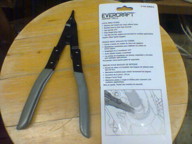

Pry bar set
and just purchased a made in Taiwan lock ring plier set. I know, I know but hopefully this project will be the only time I use 'em.

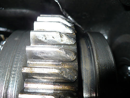

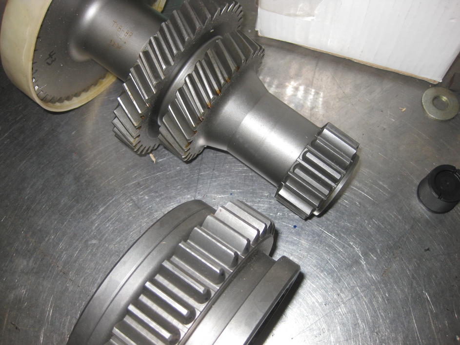

From another forum I saw a fresh First-Second Clutch Sleeve, and mine is toast :(
and mine

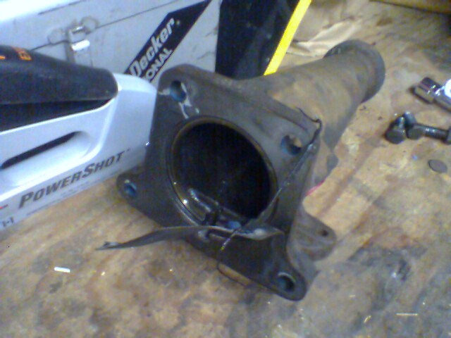

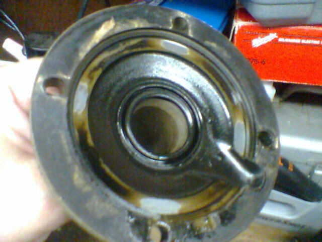

Removed the fore and aft housings yesterday (nice cool day in the garage)
Front Bearing Cap
Tailshaft Housing
This'll give me access to the Lock Ring retainers and the Front and Rear Bearings.
May give those Taiwanese Lock Ring pliers a test tonight and report their usefullness and durability in the morning.

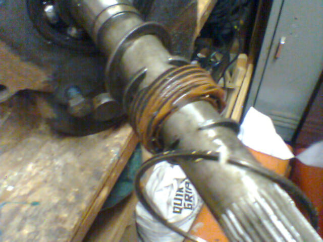

Removed all the Lock Rings and Rear Bearing Retainer (that was a bear to remove) those pair of Lock Ring pliers work okay though so far.
Exp[loded view showing Lock Rings, Speedo drive and Bearing Retainer

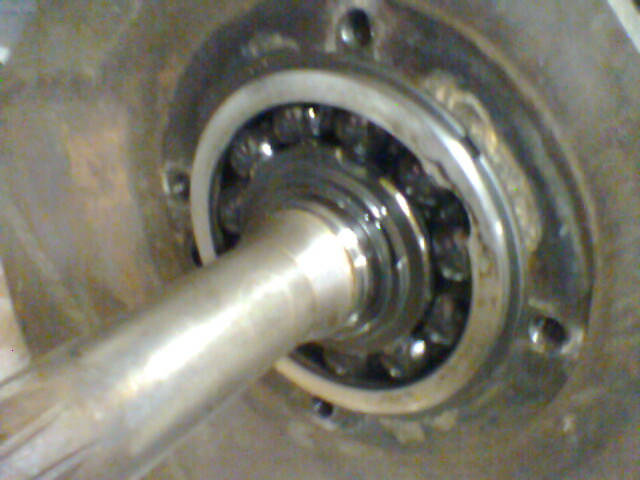

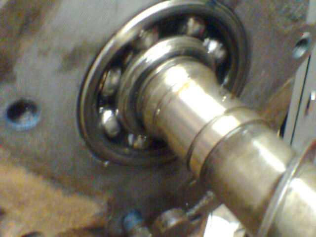

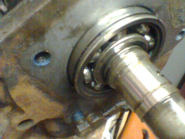

Rear Bearing and surfaces
Rear Bearing extended
The Taiwanese Evercraft Lock Ring pliers
Close up of ends

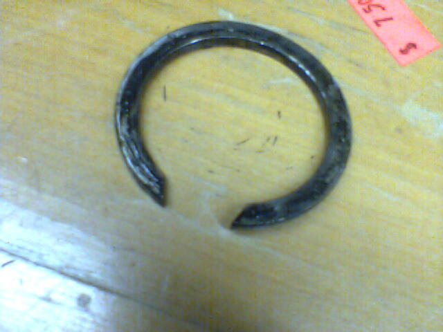

Here's that Rear Bearing Retainer (that was such a bear to remove, I distorted it in the process)
Another view showing thickness

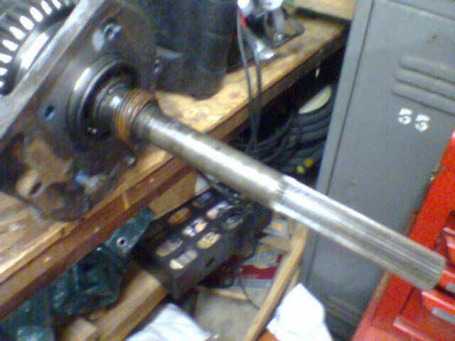

Pulled the Lock Ring and Bearing Retainer on the fron side and like the Output Shaft, the one for the Input shaft was stuck on one side when it finally gave way it took a small chunk of the Input Shaft with it :x

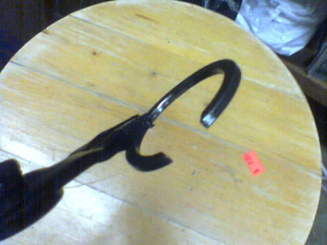

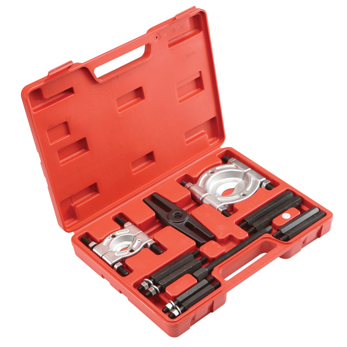

Well, I found this thing on HF and given my experience with tools from them I'm dubious. On the other hand I can't afford to drop $300 for two bearings.
I have that set from HF. It's not a bad tool, but not great either. Do you have a floor press or compressor that can run a air hammer?
I have used a air hammer with a blunt tip to drive the shaft from the bearing in the past. You need either the gearbox casing to support the gear from the input/output shaft or use the hammer along with a bearing separator. Just a little trick I learned from Moses Ludel.
