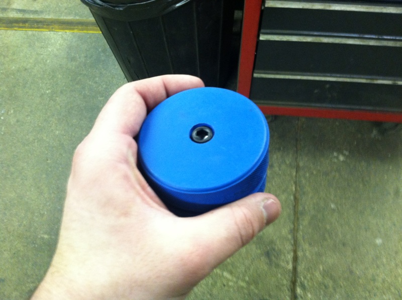

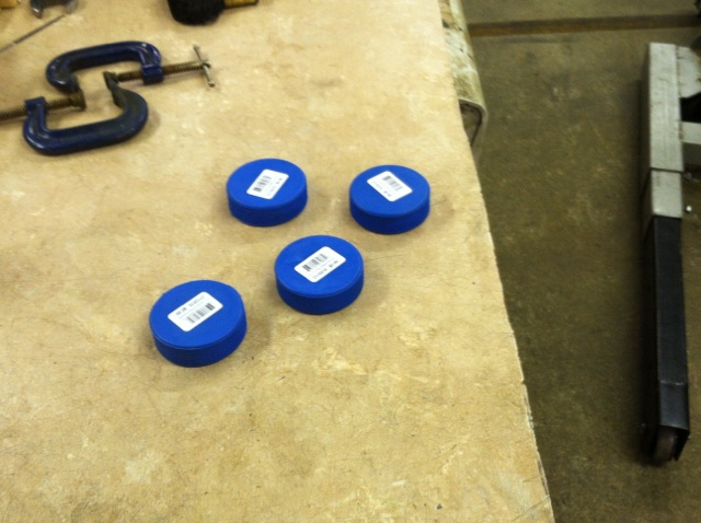

4-Hockey pucks $12 M.C. Sports (rear bump stops)

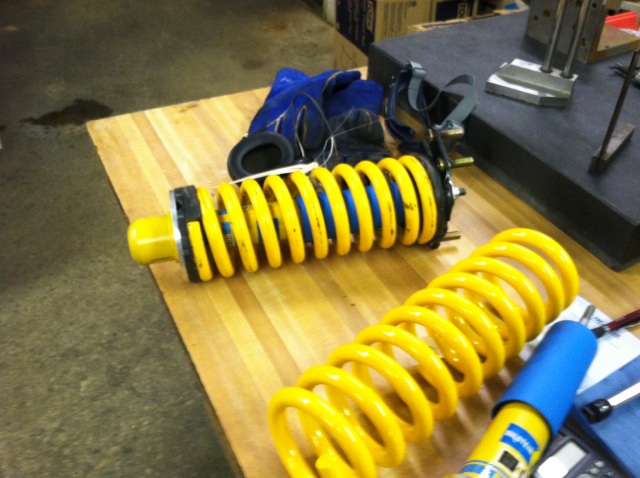

I ended up adding a few extra but not required items such as new top plates and isolaters for the front struts as I didn't want to reuse the old pieces and I wanted to assemble the front struts to save time on the lift install.

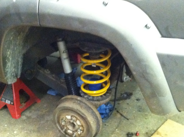

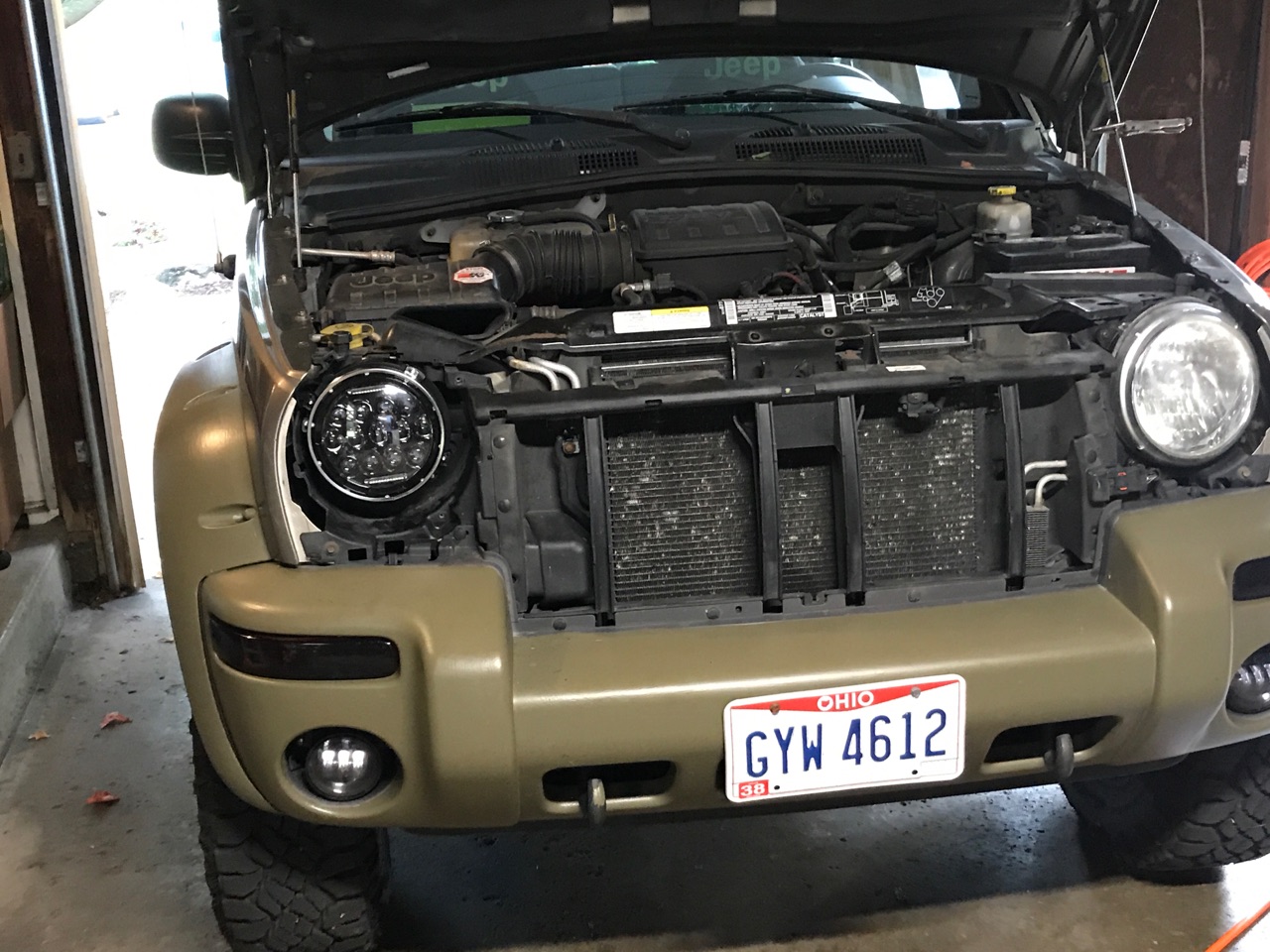

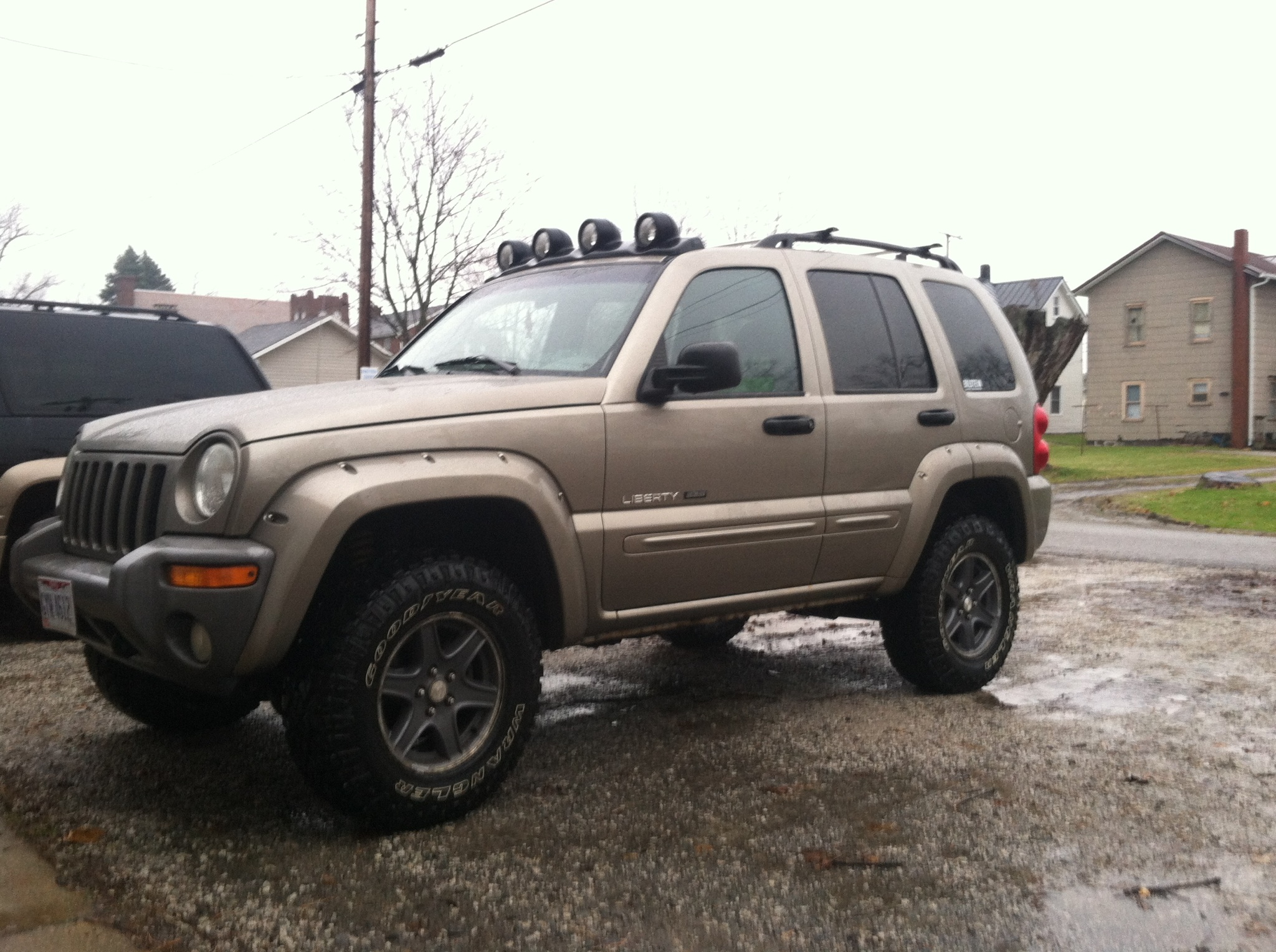

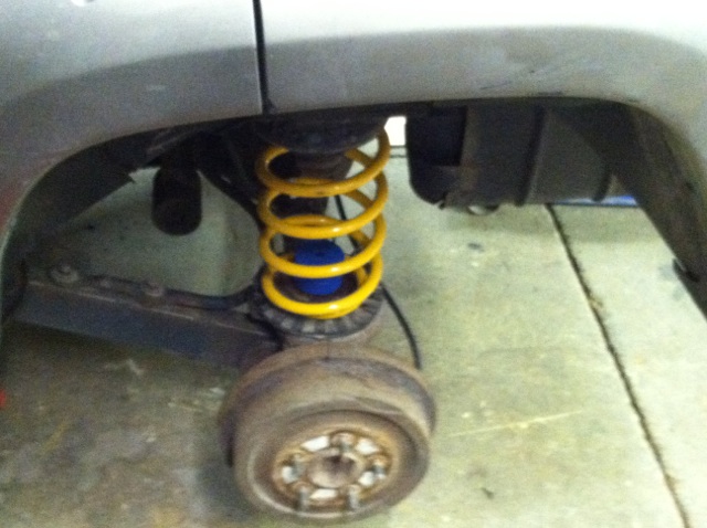

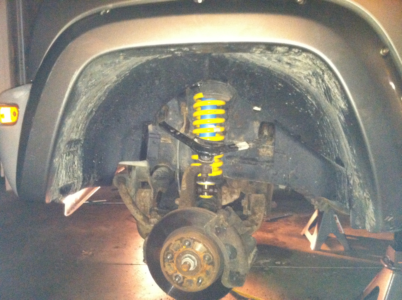

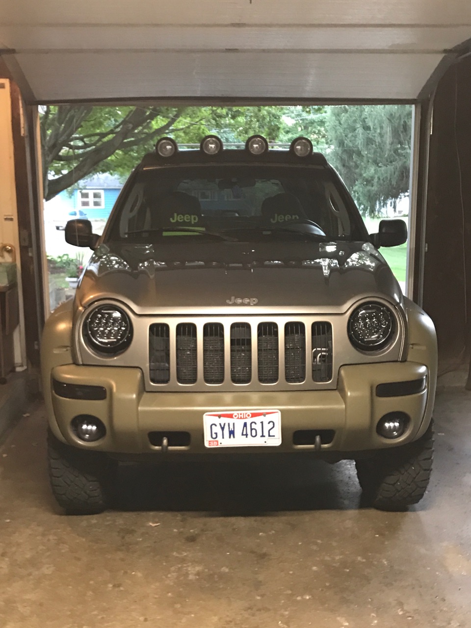

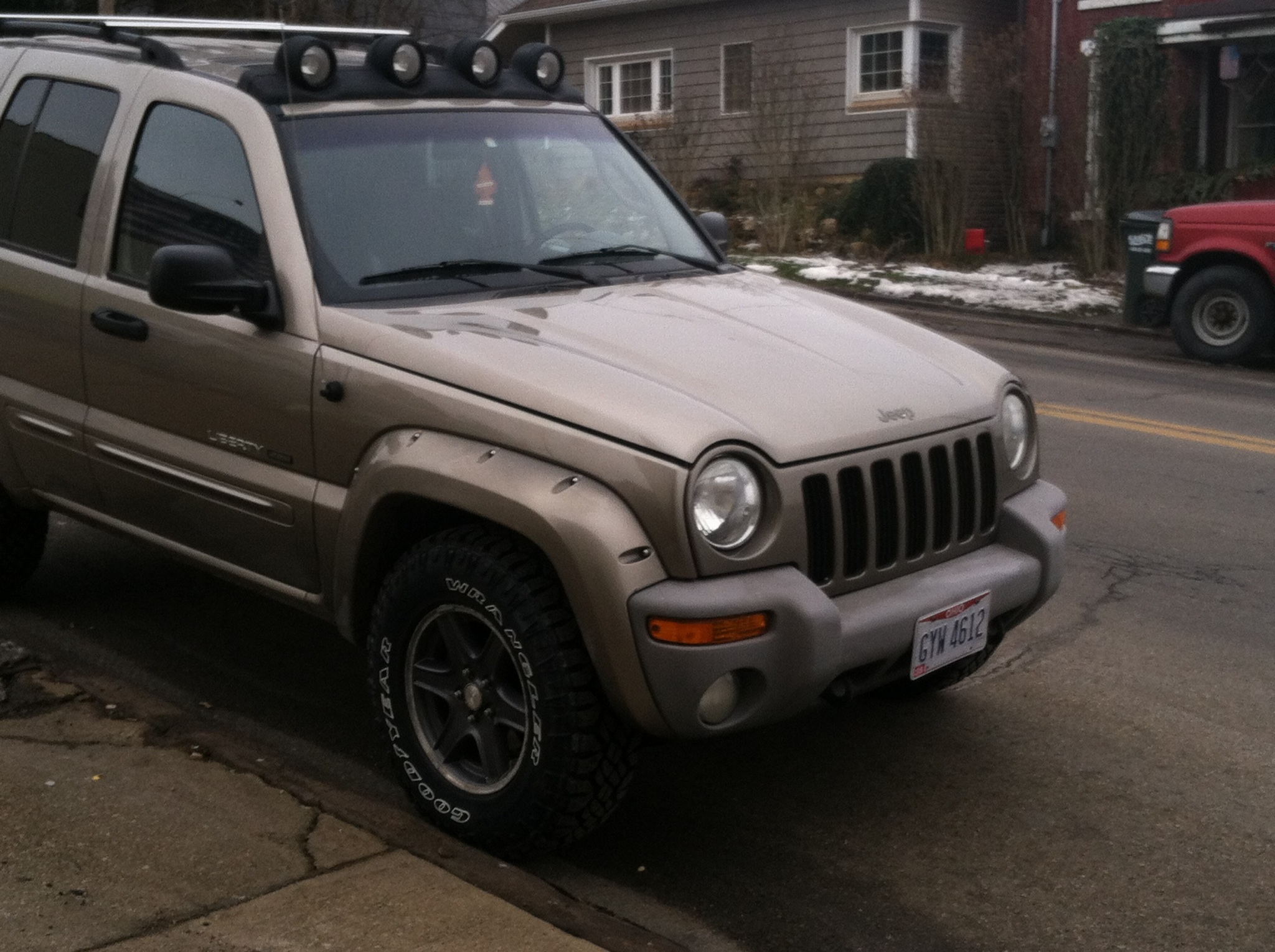

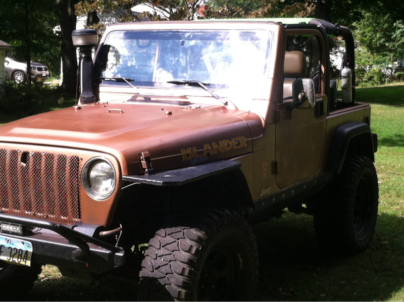

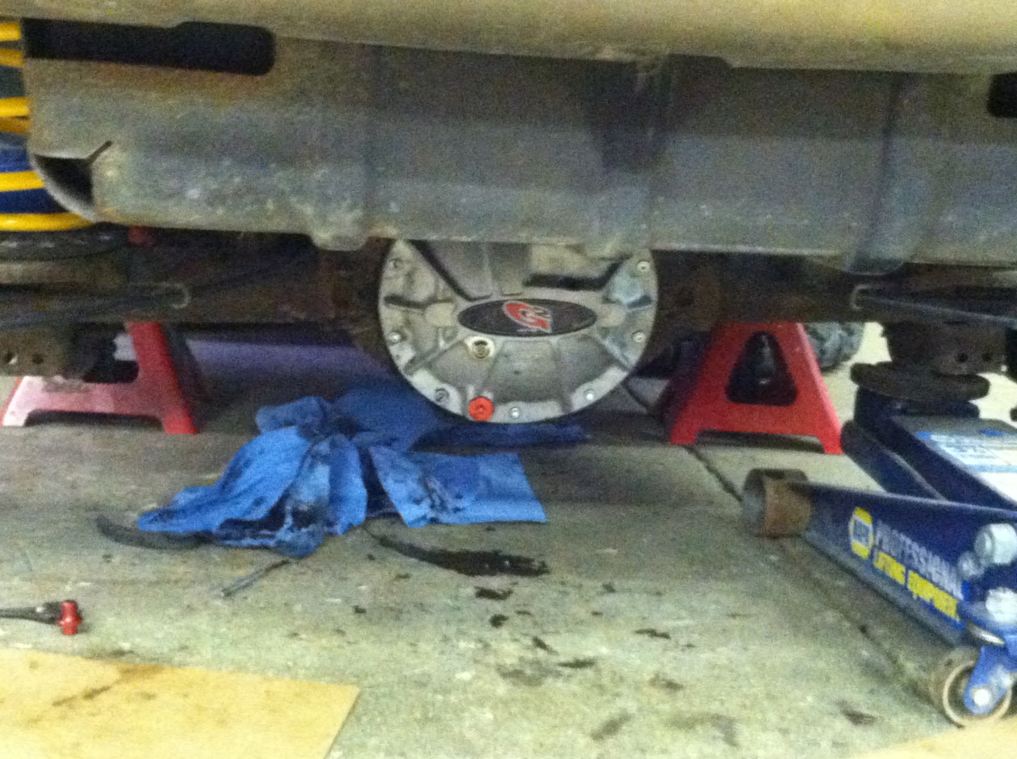

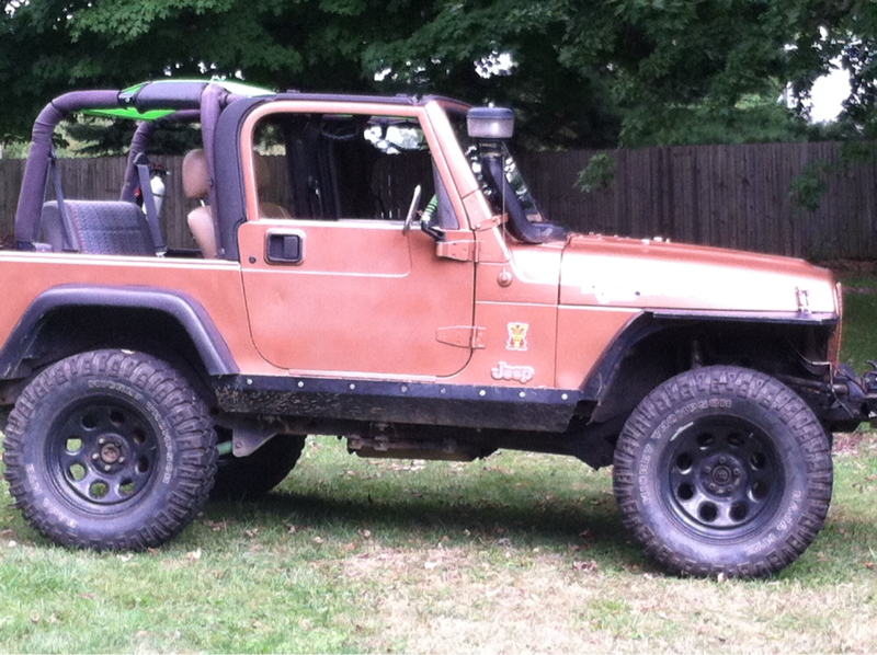

First pic is front lift installed (minus the bumpstop, they are easier to install when the tire is back on and the Jeep is on the ground), second is with new tires before the lift and the final is lift installed.
