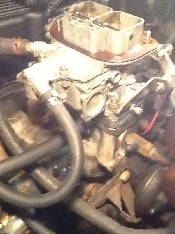

Can you post a couple of photos of your current set up?

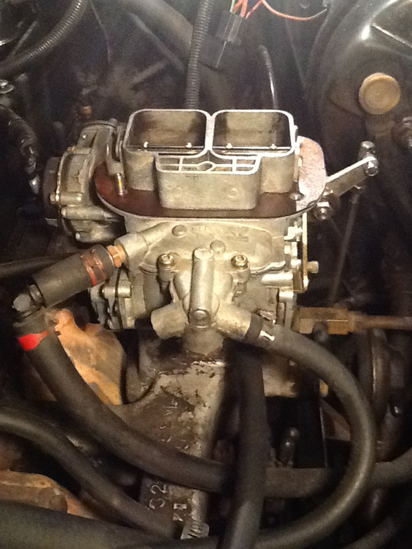

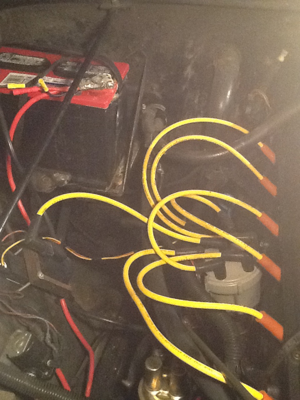

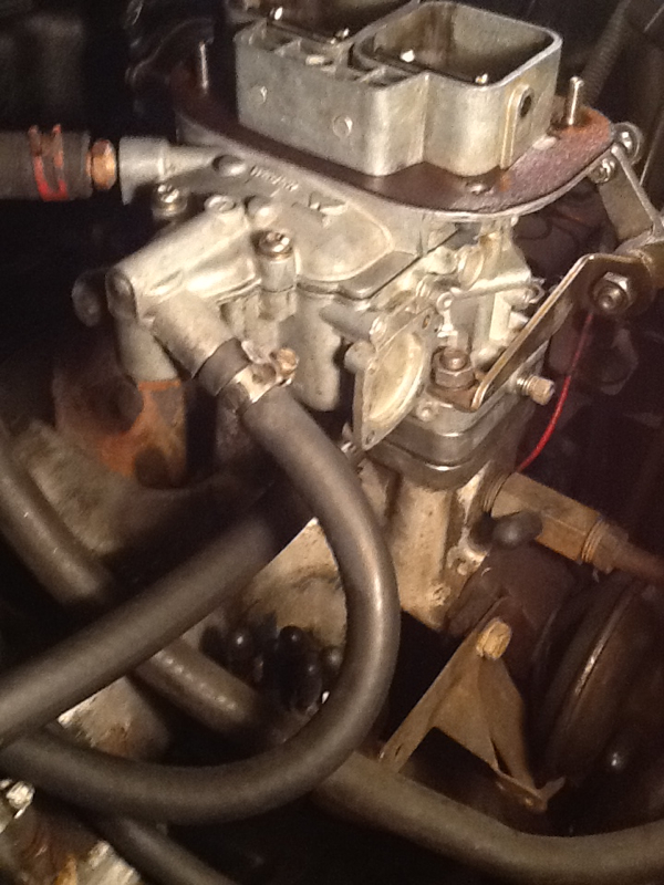

Ahhhh....The Jeep weekend project, if we only got paid to do we'd all have tons of money :funny:. So looking at the photo's, let me ask a couple of basic questions. How long ago did you do the CRT (Juicebox?) iginition upgrade? The fuel pump looks new? Same time frame as your problems? Looking at the first photo, the bowl vent (on the left which has the hose with the 90 deg fitting on it), where does that run to? Also (in the same photo) the fuel inlet block, the fuel comes in on the right of the "Y", is the left side plugged? It's probably the photo but I don't see the plug. Speaking of the inlet, go ahead and remove (unthread) the brass plug between the two inlets (edited.... forgot we are working on a 32/36), there should be a filter screen behind it that may be clogged.
I see you have the EGR valve vacuum line capped at the diaphram. You may want to remove and cap off that system (if you're emissions exempt). You can simply unbolt the two bolts, unthread (or break off depending on which EGR valave you have) the vaccum diaphram and push rod. You can make a block off plate with sheet metal or even a flattened out piece of soda can. Just put your new plate between the gasket and EGR base, bolt back up. Just make sure that you reconnect the "S" tube that connects to two manifolds or cap thoses as well. This not likely the root of your evils, but it will cause idle/performance issues with your Weber set up.
You do have some minor plumbing issues the current way the Weber is installed. Eventually after we get it running again, you may want to consider a fuel psi regulator and perhaps even an electric fuel pump. The Weber carb (down draft models, like your 32/36) work best at 4 psi and a steady fuel flow. Although the electric pump is not required, your mech. pump causes the fuel to surge with each stroke of the diaphram pump. Also, you may want to ethier remove (cap off) or modify the fuel return line. You can modify it by installing a quality "3 way" fuel regulator (or PRV). Holley makes a very reliable one as does Weber (but I'll pay for the one from Weber!). I have photos somewhere of the 32/36 that was on my 85 CJ, I'll look and post them for some ideas.

Oh so true! At least I for the most part, enjoy working on the Jeep it's all the other cars that drive me crazy! Ok, Lets see...I did the "Juicebox" upgrade about a year ago and it ran the best it's ever ran after I did it. I think that was a good upgrade. The fuel pump is fairly new, probably 3-4 months old. I don't believe it is the problem as it is "new" and just because it was running a few weeks ago but then again, it definitely could be...IDK. The hose with the 90 deg fitting goes to the charcoal canister. On that note, I used to live in an emissions exempt state, which is when i removed a bunch of stuff and unfortunately do not have anymore. I do not live there anymore and so, at some point in time I will have to address that issue (Howell FUel injection)? Umm... the fuel block I am hoping is plugged but just went out and looked and do not see or feel a plug there. I would assume if its not plugged fuel would spew out, which it does not.

Ok...maybe dumb question. On the regulator pics I see the fuel line coming in with the filter and gauge on it and then assume it goes straight through to the inlet on the carb. My question is where does the other line go?

As for the set up in the photos I posted, the fuel flows into the regulator (in this case, it’s really a pressure return valve) to a gauge, then filter and into the carb. The smaller line from the bottom is the return line back to the tank for the excess fuel. You have a return line on your Jeep (I see it in the photo), if you look at your fuel filter it has one line in and two out. On the outlet, one goes to the carb and the other back to your tank. Weber’s don’t operate optimally with the stock Jeep fuel set up, but it will work. Unlike a conventional carb which relies on a higher pressure, the Weber is designed to perform with a consistent, steady low pressure / high volume fuel supply. Many Weber set up’s don’t have a return, but do have a regulator. A straight feed to the inlet will work; it just needs to be low pressure.

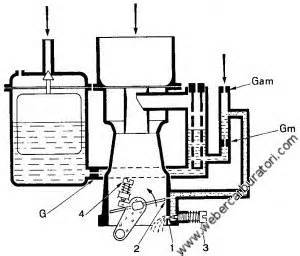

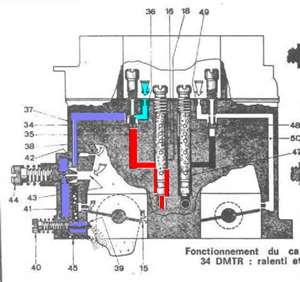

With a properly tuned down draft carb (like the 32/36), you normally will not see fuel flow down the venturi’s during start up or low idle. They have their own low speed (idle) circuit that is below the throttle plate and can’t be seen without opening the linkage (throttle plates) at least 1/3 of the way. This explains why you saw fuel spraying while your wife was depressing the pedal, you activated all three circuits. Unfortunately, I’m at work and can’t scan diagrams in from the manual, but I did find the attached diagraph which illustrates the low speed circuit (however it is from a different model, but the principle is the same).
At this point, we know we are getting fuel up to the carb, have spark and that at least two of the circuits are supplying fuel. Have you adjusted the idle screws in any way? It sounds like the low speed circuit is closed. Regardless, using the proper sized screw driver, gently close (clockwise) the idle mixture screw until it bottoms out (this screw is on the base to the right facing the carb and it’s at an angle). Next you want to unscrew it 1 ½ turns. Then unscrew the idle speed screw (just above the idle mixture screw, perpendicular to it and has a spring around the screw shaft that touches the primary linkage) so it is not touching the linkage. Now screw that in 2 full turns. This is your starting base for a new install (or trouble shooting in our case).
If this does not at least cause some sort of fire up during starting, next we be removing the carb, disassembling it and looking for obstructions.
These links are helpful:
  1. store.cip1.com/.../graphics/00000001/XXX-WEBER-32-36DFEV.pdf
  2. http://carburetion.net/pages/troubleshooting.aspx
