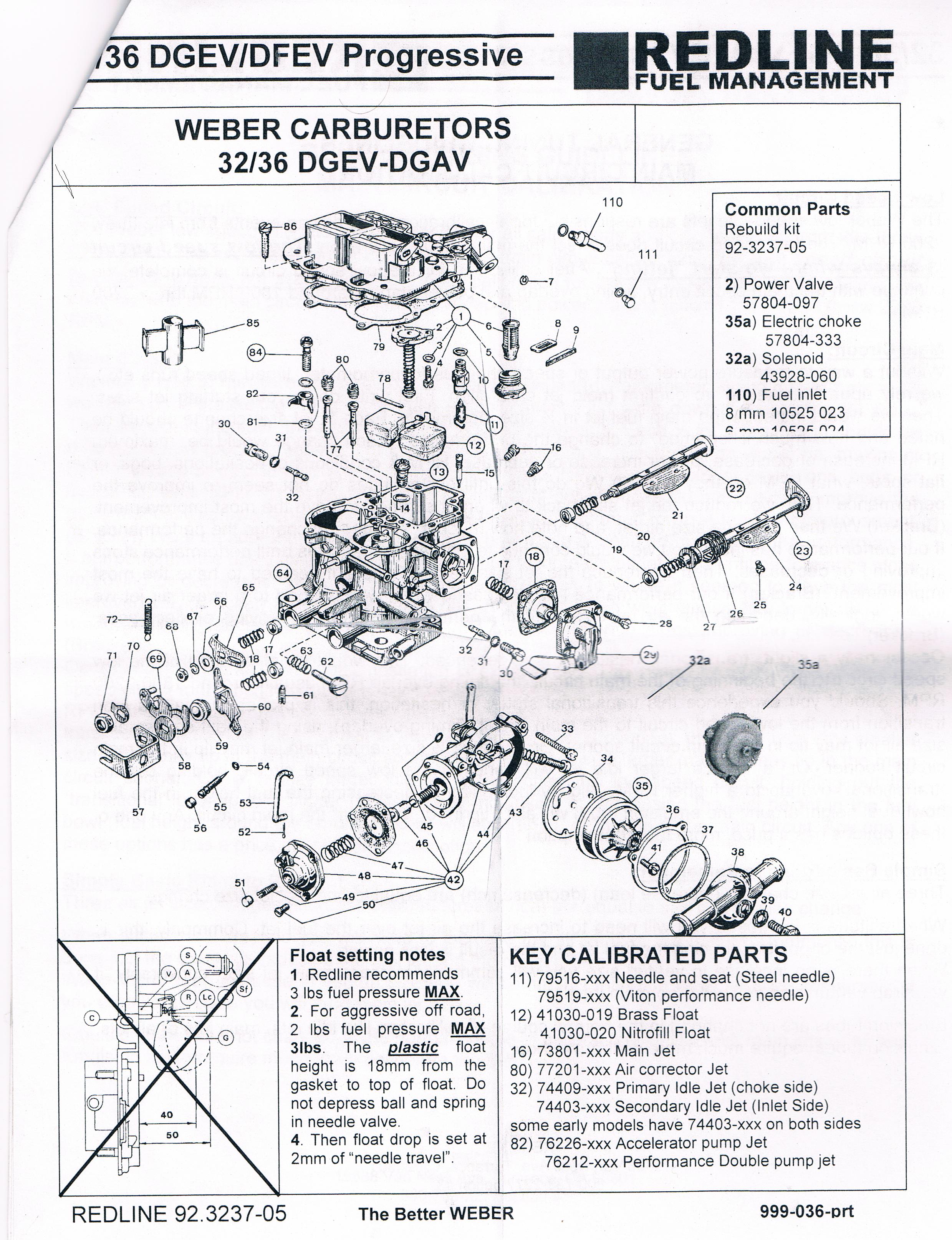

Believe it or not, the fact that it wants to fire up after pumping the pedal is a good thing. When you pump the gas pedal, it is forcing fuel into the ventrui’s , so we have a clog or restriction somewhere on the low speed (idle) circuit. I’m a little curious when you say “I have adjusted/set the idle mixture screws (one on each side)”? Maybe you where turning the idling jet holders(#35 in link 1)? There is one on each side, but the idle adjustments are only on one side? Regardless, the link below is the schematic for the carb. We would be turning number 58 (idle mixture) and 62 (idle speed). It’s a confusing drawing, but hey I have a manual that is not even in English. FYI, some of those parts you will not have.

1. Weber 32/36 DGEV DGAV Diagram

I'm at home today and have attached two diagrams to help with the float adjustments. We are going to refer to the part numbers on these diagrams rather than the numbers on others (the numbers vary depending on who printed it). You may as well replace the parts in your kit as you go. There is no need to fully remove the throttle shafts(22 and 23) or other linkage (58-72). I don't recommend removing the choke assm. from the carb body either (42). These items will require calibration once re-installed after being fully removed.
You want to remove and inspect the main/primary jets (16), the E-tubes (77), the primary and secondary idle jet (32). These you will want to clean out the orfices with a small piece of wire or some thing like that. Look into the carb body as well to make certain their seats are clear too. If you have compressed air available, this helps greatly. Also check the built in filter (6) in clean. The needle valve and seat for the float (11) you are just going to replace with the parts in your kit.
During re-assm. you will want to check your float level and adjust if needed. There are many ways of doing this, but since this is not a race car or rock crawler, we will use the simpler methods. There are two simple ways to do this, both are shown on the bottom of the 1st diagram I sent, dis-regard the "X" there the drawing. You can measure the distance from the inside lip of the top of the carb w/gasket install (hold it as shown in the drawing) to the top of the plastic float. It should be around 18mm. You simply bend "A" in the drawing to achieve this, don't just bend the float up or down! The other way which I perfer is the method with the "X" through it. You would measure from the inside of the carb lip w/gasket to the bottom of the float while holding the unit vertically (as shown) and look for 40mm. Next you would invert the unit so it is horizontal and measusure it again after the float drops, 50mm. This method accounts for float travel, but may require adjustments to points A and R by bending to get the correct travel.

Sorry, it would not let me upload earlier......
