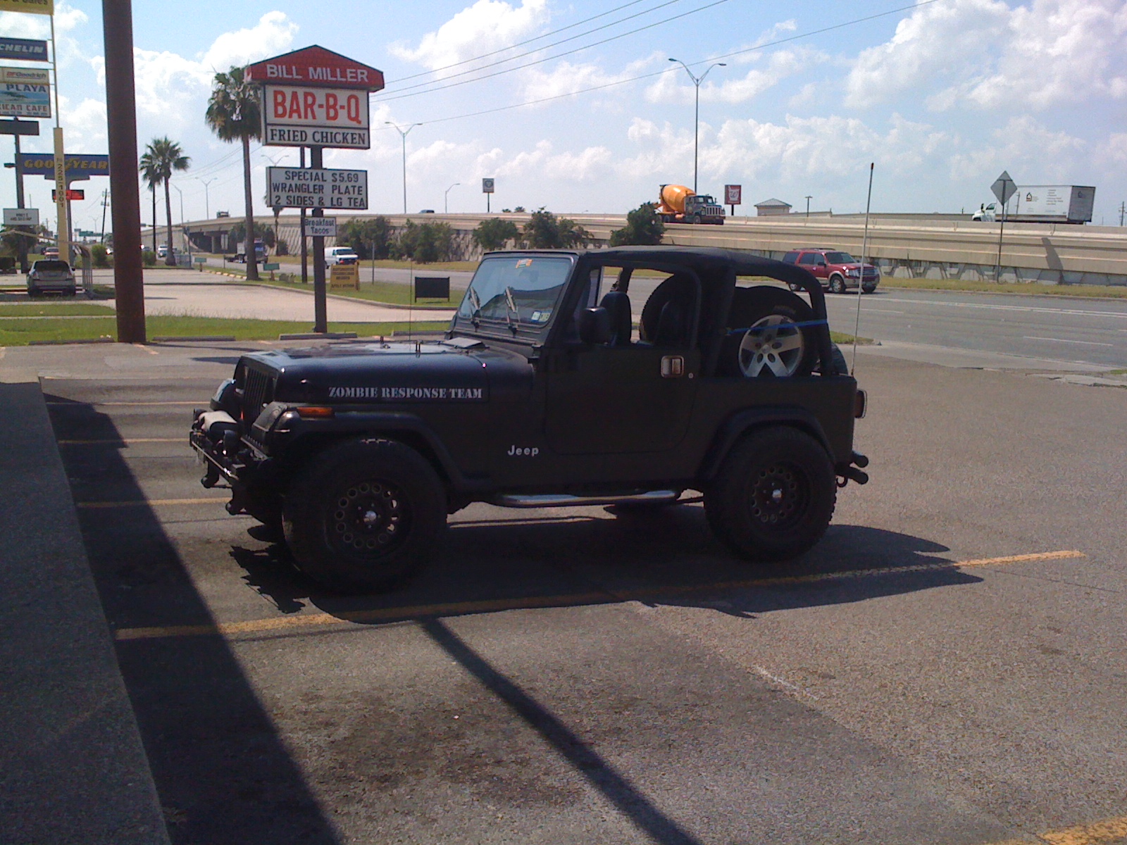

Washed inside and out and shined up the tires. Now I'm getting ready to go for a relaxing ride... if these clouds leave I'll drop the top.

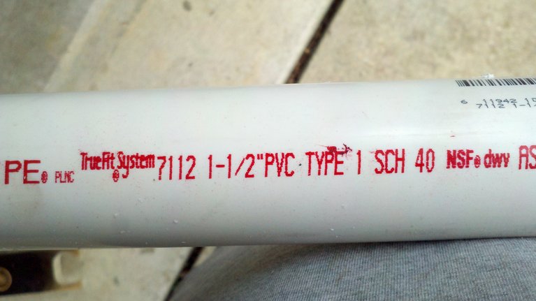

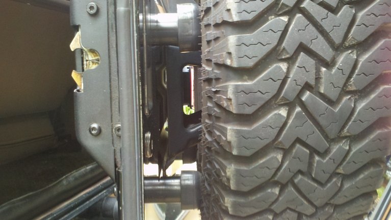

I extended my spare tire bump stops, cost less than $8 :piratenanner:
I used 1 1/2'' pvc pipe $2.68

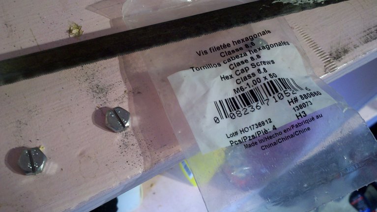

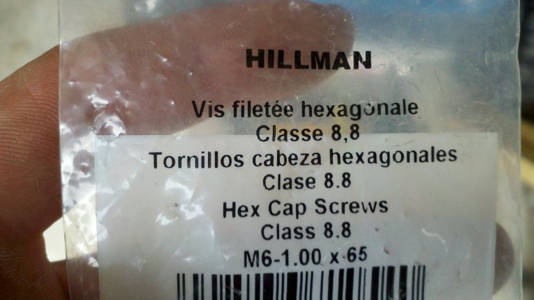

bought M6 x100x50 and M6x100x65 bolts (about $2.50 a pack the shorter bolts were 4pk and the longer were 2pk
and cut a slot in them so I could use a flathead screw driver on them

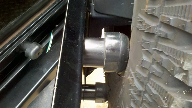

painted the pipe black
and the finished product

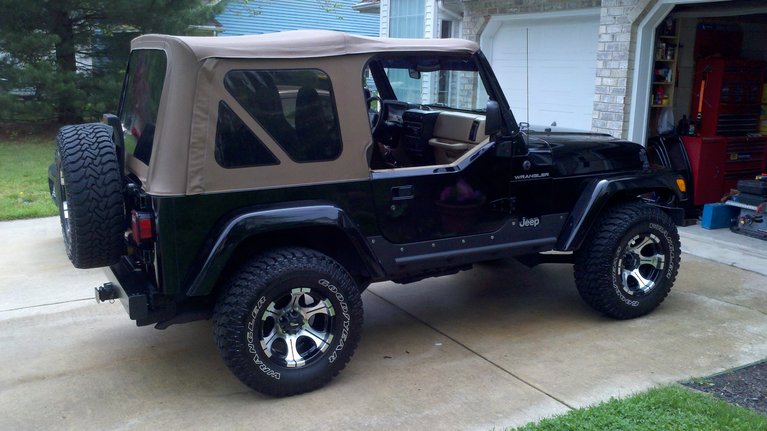

did i mention already put the new rims and tires :) :) ? i think i did but they look so cool i will put them in this thread too

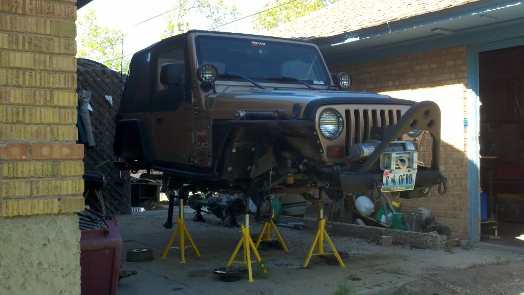

got mine ready for a new HP30 in front and regeared and built up axle in back, all new shocks, springs, upper control arms, steering box brace, truetracs, new steering, tummy tuck skid plate, new everything except housings from the frame down :D
