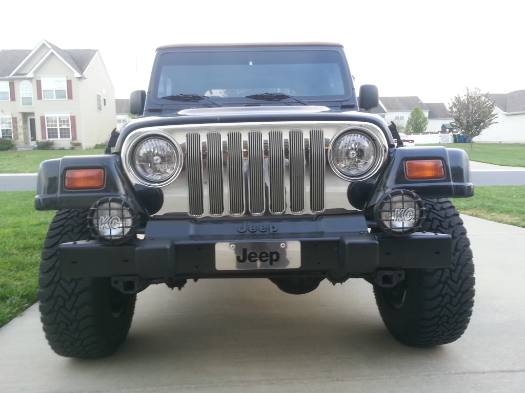

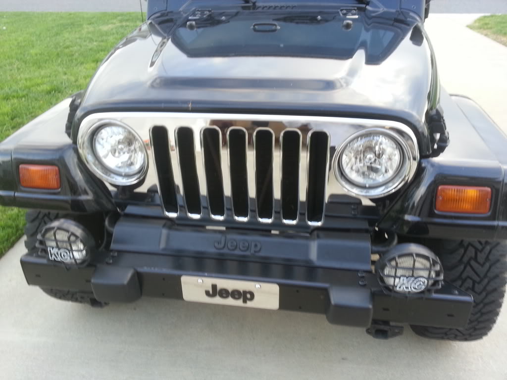

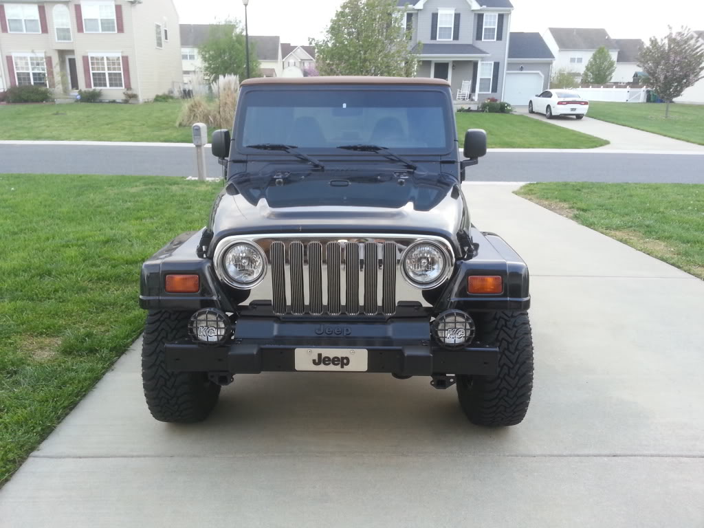

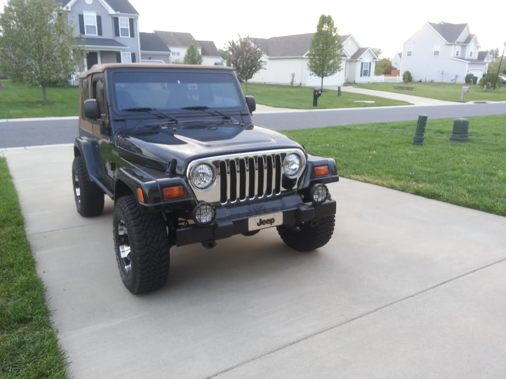

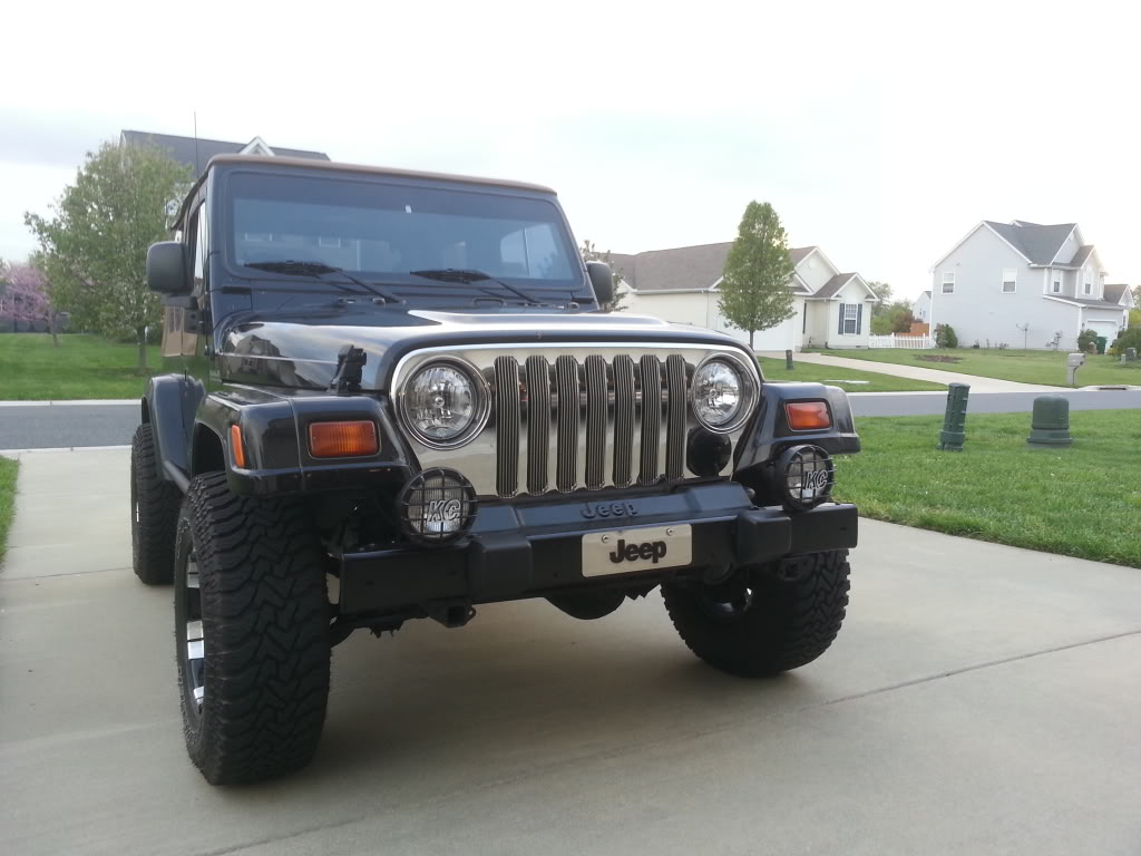

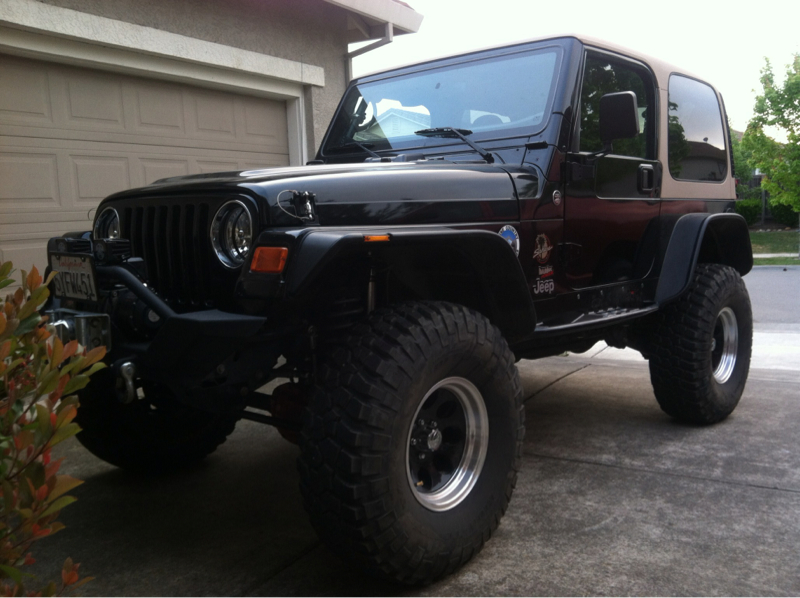

Here's the grill installed
Here's with my my billet inserts installed
I love the new look :bootyshake:

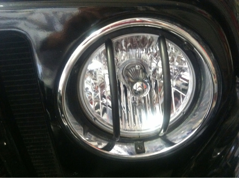

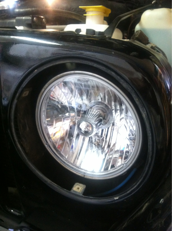

Nice Grill, ^ are those Rugged Ridge H2 conversion headlights? Put these in tonight.
Thanks, no they are the KC conversions

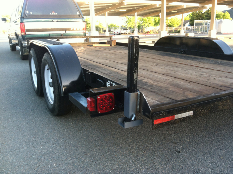

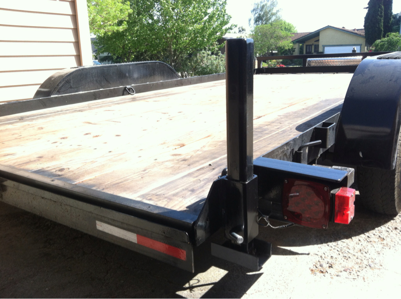

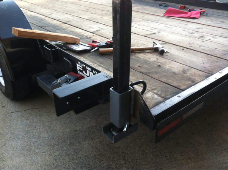

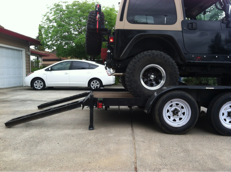

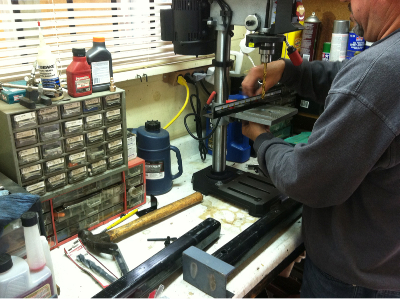

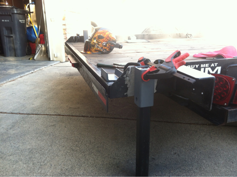

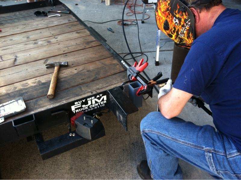

Put some stabilizers on the trailer tonight. Cut off a stake bracket on each side. Welded on the 2" box. Welded on the feet. I need to drill another hole in the post in the down position, a little paint and Viola!

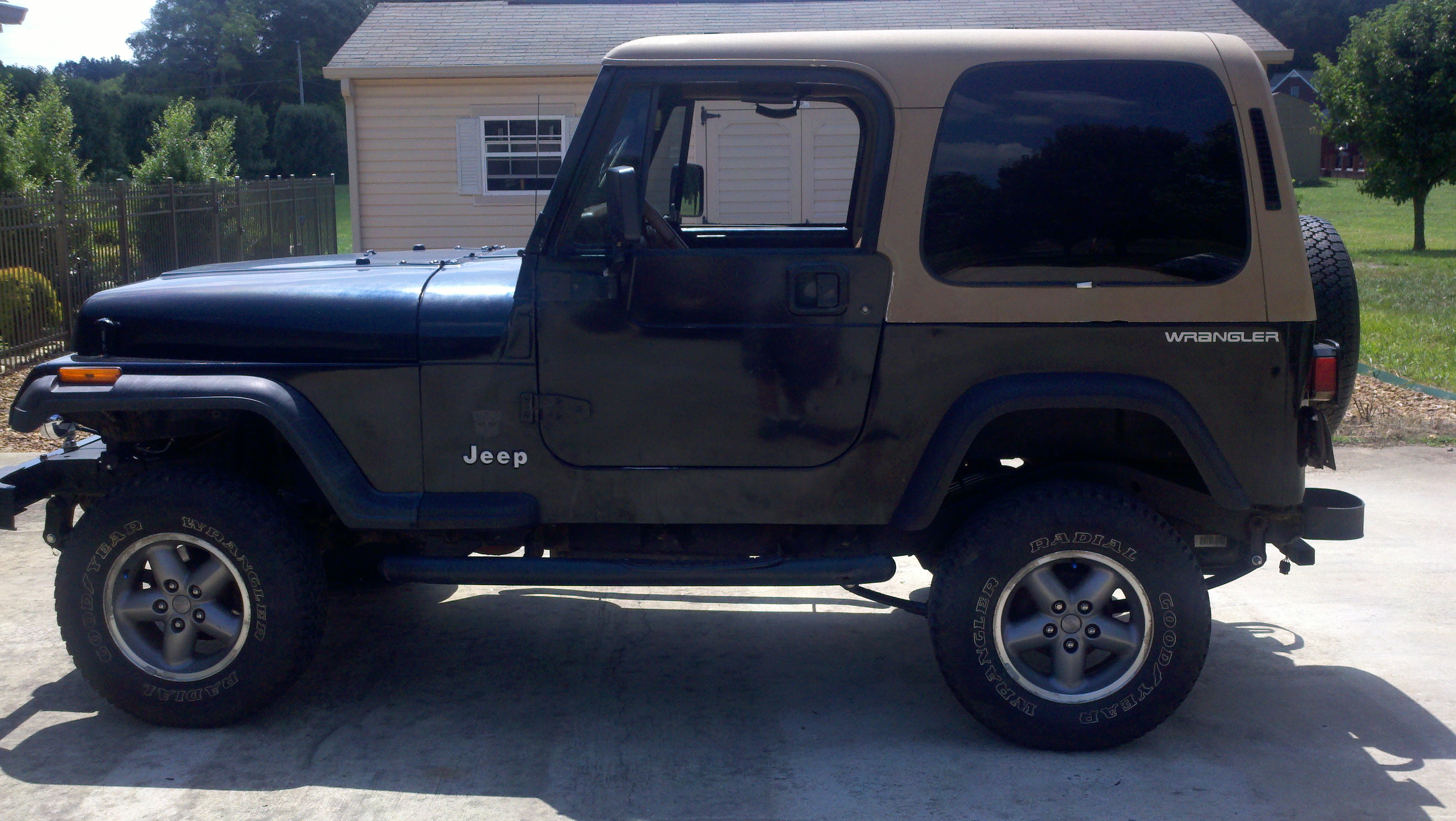

replaced broke degree shim and torqued to 65lbs per Rough Country..? that dont feel right... boy do I need some tires.

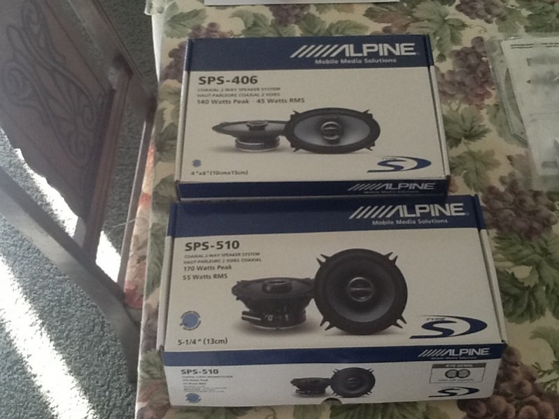

Putting in new speakers in the dash and speaker bar on the roll bar. Crutchfields has the adapters for wiring and front dash to bolt right in? Plug n play doesn't always work, we'll see.

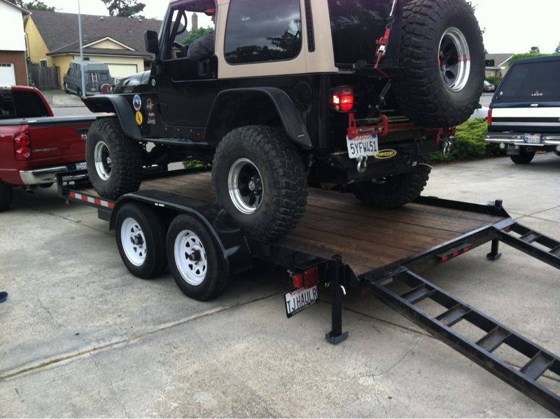

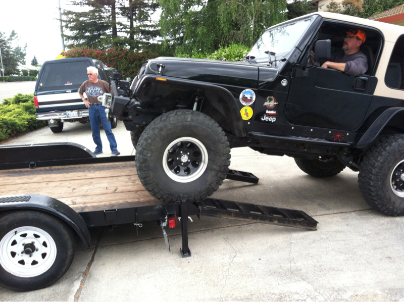

Finished drilling the stabilizer holes in the down position. Works great. Now the trailer doesn't lift up 6 to 8 inches when you drive on, feels a lot better.

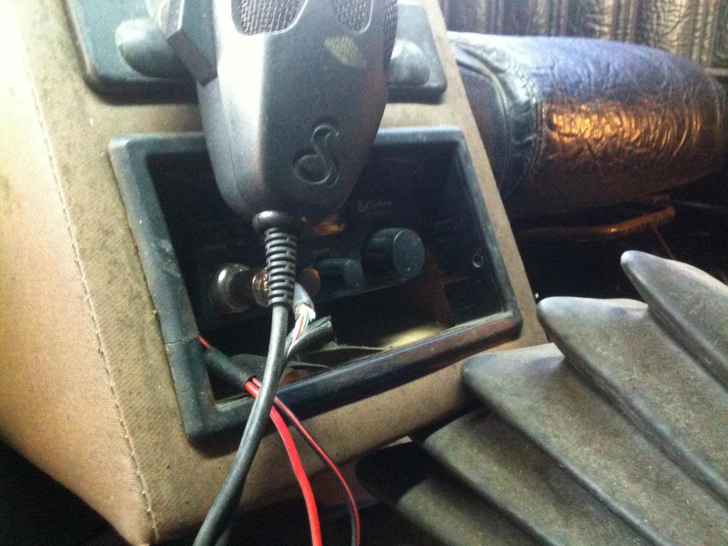

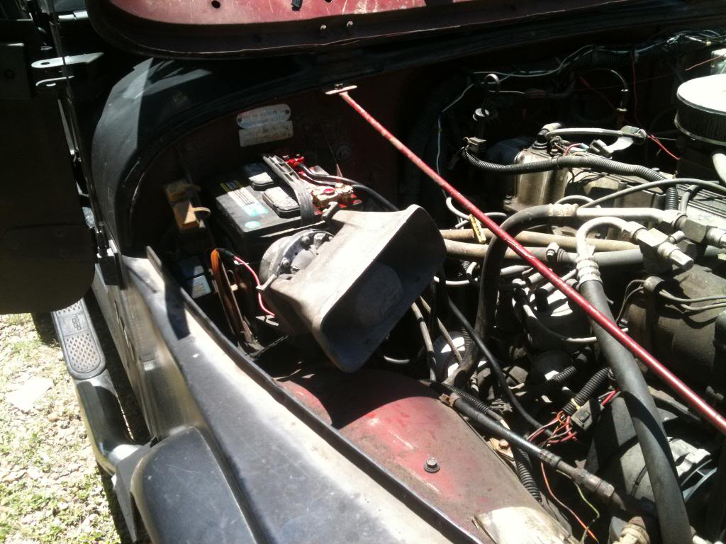

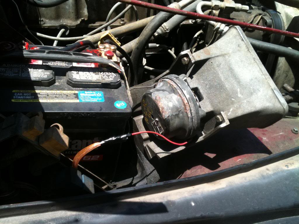

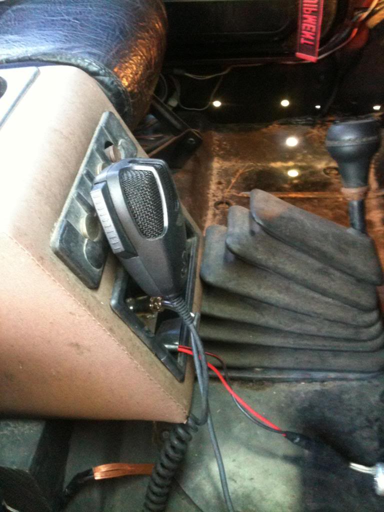

i added the cb back in and wired in the police pa speaker i got at the junkyard. :)
nice and hidden
the dime slot is perfect for the mic clip
its the little pa speaker but makes a lot of noise
the speaker is mounted with an old bracket for an exterior cage a buddy gave me and the connections are just crimped for now because i couldn;t find an extension cord to use the soldering gun
mine?
it really is when you use it. it sounds like the police when you watch them on cops and they are telling people to come outside with their hands up, ha ha ha. it is super duper loud, ha ha ha
