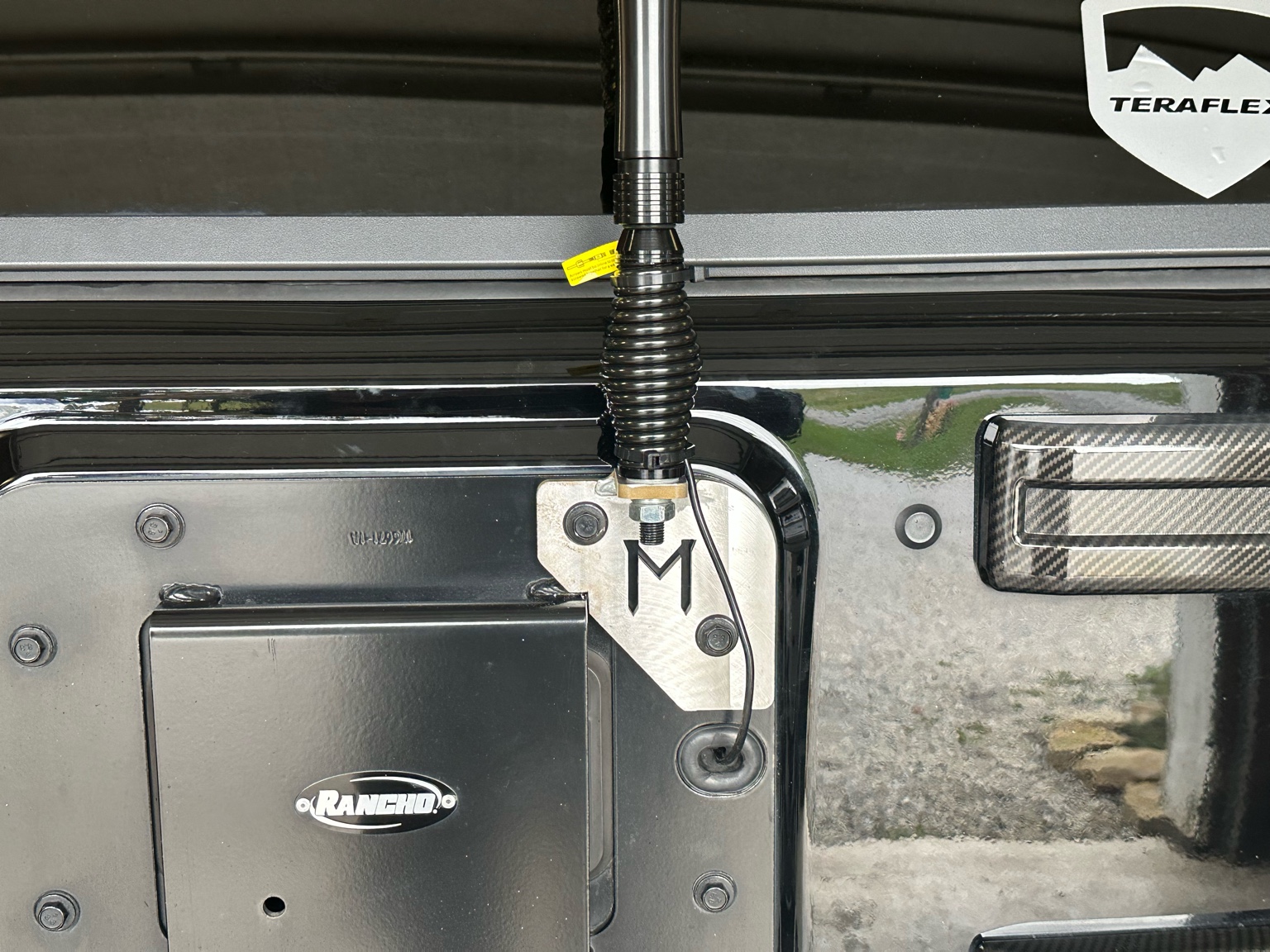

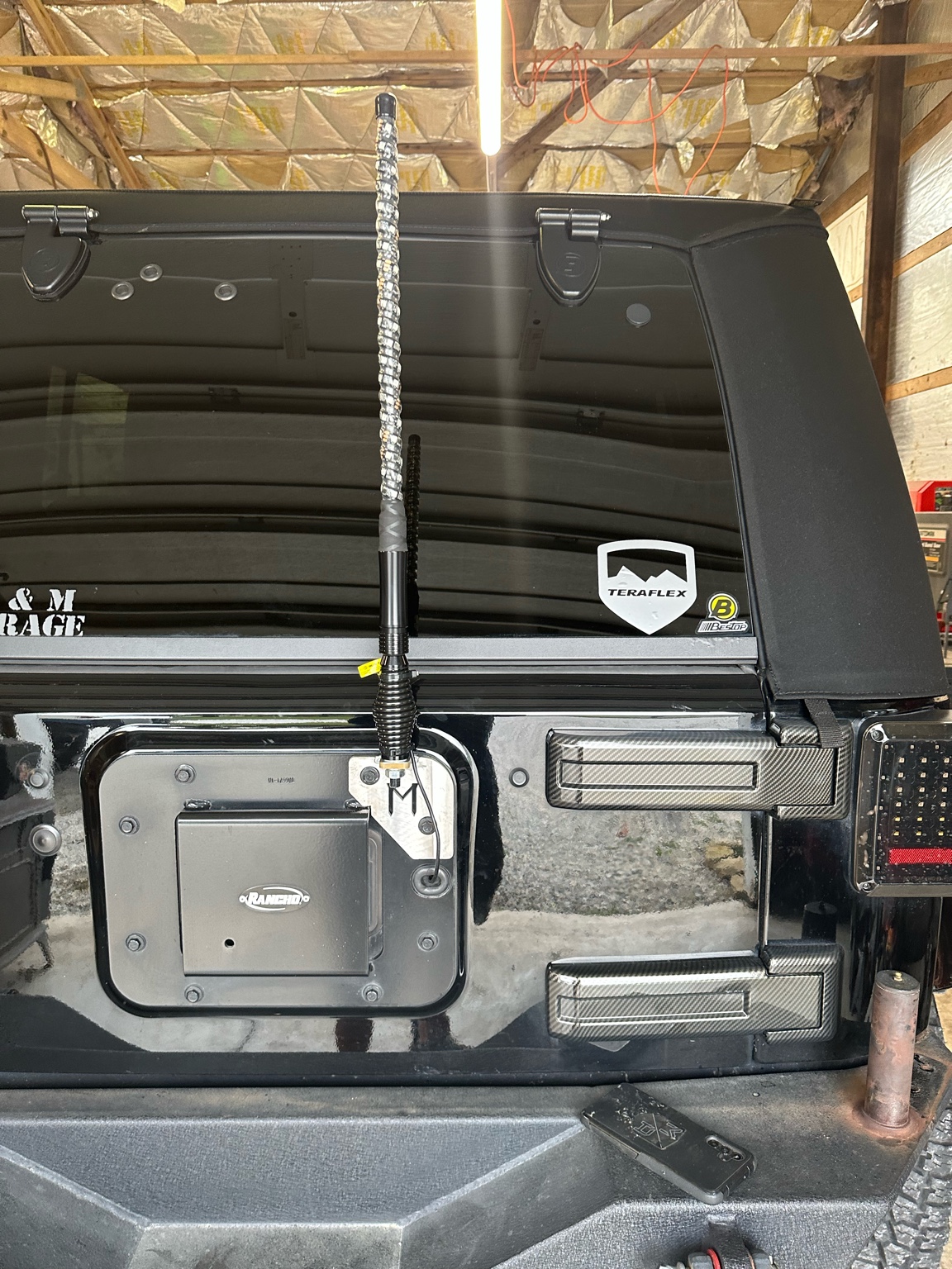

Doors are the worst ground planes for the antenna. Place a ground strap from the tub to the door inside the trunk area.
Eric m
Thanks for the heads up, I?ll make sure to ground them out very well when we get to mounting up the cbs.
To know you have a good ground measure resistance between the ground part of the mount nearest the antenna to tub ground or battery ground. It should read less than one ohm. Greater and you will never get best SWR
