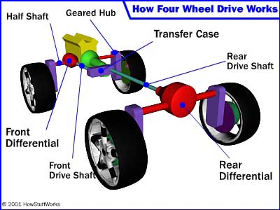

I'd like to see those "portal" axles on them. Talk about ground clearance!!!
Diagram of Hummer system, one cool feature of the Hummer is the geared hubs it uses at each wheel. These raise the entire driveline, giving the Hummer 16 inches (40.64 cm) of ground clearance, more than double what most four-wheel drives have.
MMMM Torsen® differentials
