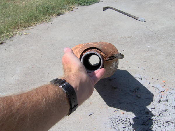

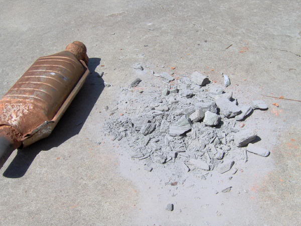

Here's what I got out of the cat:
I've seen people gut their cats before, and all of them I've seen came out like coal dust, all black and sooty. Mine came out a real light shade of gray. Is that normal? I looked at some of the larger honeycomb pieces and could see daylight through them, no blockages. Maybe they weren't plugged at all or at least a little and all the banging around cleared them. I'm guessing there wasn't any blockage, though.
Here's what a hollowed cat looks like, for those of you with emission testing that will never get to see it:
Before this, my airbox was really, really loud. Almost embarassingly loud. But now it's just as quiet as when it was stock, but the exhaust sounds really good. It's not loud or anything, just a nice deep tone.8)
