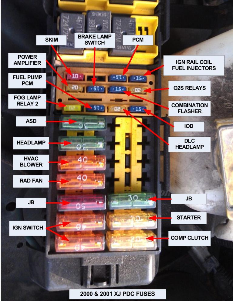

One more question you did say you checked all the fuses correct?

I checked the fuses in the engine power supply box. Haven't done a thorough check under the dash but that is a good call. I ordered from Rock Auto the STANDARD MOTOR PRODUCTS TH189T
