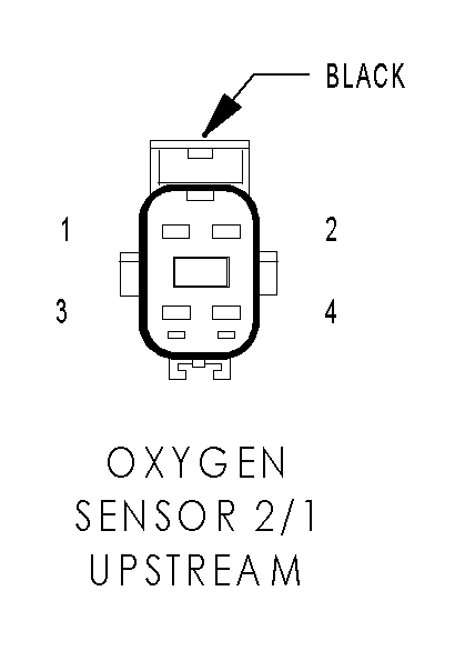

So the Grand Cherokee Laredo is fixed...sort of. My problems with bad stumble coming off open loop and erratic codes flying all over the place were all because of a PCM that had water damage. Car runs fine without any help form code reader or running code reader evap test. I picked up a used PCM and had it flashed for my vin number. I am still getting a code relating to 02 sensor heaters. P0031 and P0051. Checked fuse 16.. all good. Swapped out ASD relay which shares power to 02 heaters no luck ...Yet. Trying to get this OBD Sh*t behind me so I can dump this vehicle.
dlm ny country
OXYGEN SENSOR 2/1 UPSTREAM - BLACK 4 WAY
FUNCTION
1OR/DGFUSED AUTO SHUT DOWN RELAY OUTPUT
2BR/WTOXYGEN SENSOR 2/1 HEATER CONTROL
3BK/LBSENSOR GROUND
4LG/RDOXYGEN SENSOR 2/1 SIGNAL
Regards,
JPNinPA
Sent using TapTalk
Check the wiring for shorts and breaks. Check the fuses.
Check the ground to engine block.
Regards,
JPNinPA
Sent using TapTalk
Thanks for the pinout info...
I've been through the grounds in my journey the last 2 moths. Just did a check on fuse 16.
Swapped out ASD relay( carries power to 02 heater) just in case. I thought the pinout on the o2 sensor had two white wires for the heaters..no????
dlm ny country

I did not expect the PCM.
Looking at a few vendors the wire colors vary. Regardless of color the pin out is what matters.
