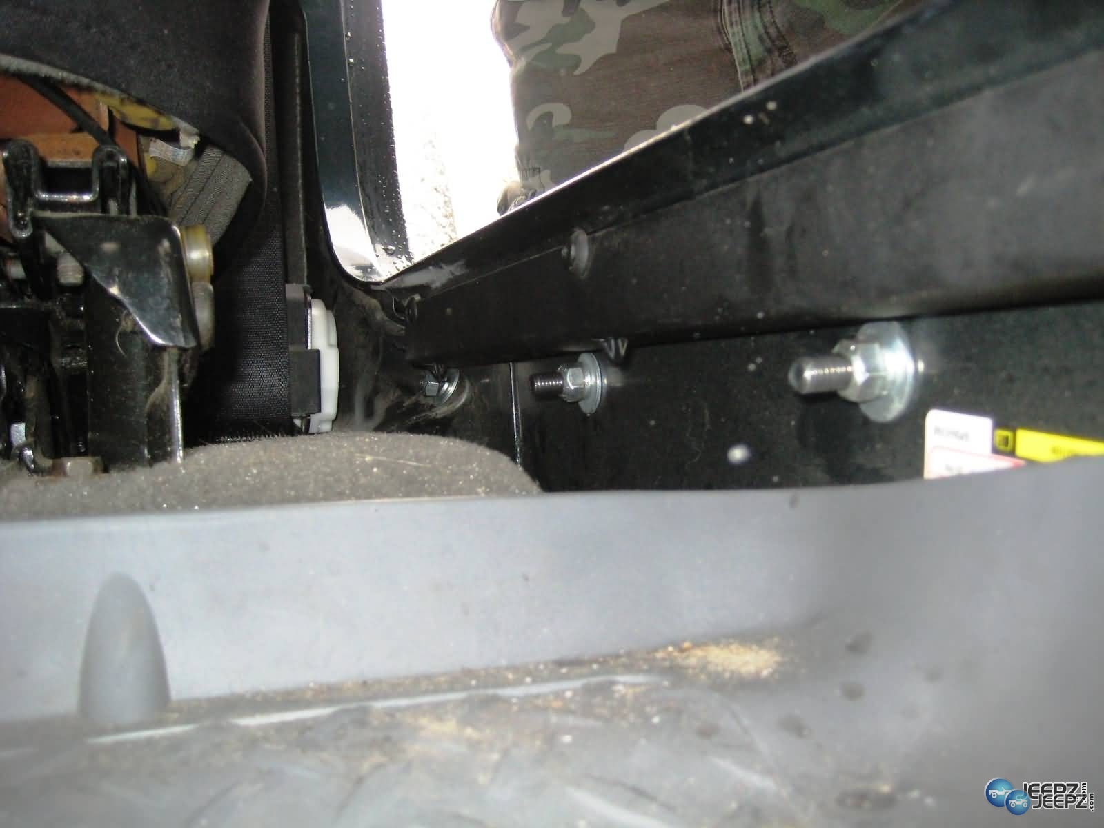

I'm about to install rock sliders and reading the instructions it said "On CJ’s and late model TJ’s an access hole will be needed to install the nut on the rear bolt on the corner guard. This can be done by using a 1” hole saw on the inside of the body near the lower seat belt mount." I'm going to install the Smittybilt 76871 XRC Black Textured Rocker Guards with Step. I hate drill unnecessary holes can I use a Rivet Nut instead?
They are talking about the last bolt on the inside, and how it goes through a little hump in the body. You can see in mine that I just bolted it up with a longer bolt, which you could do, or you could cut a hole in the hump and bolt it flat like the others
