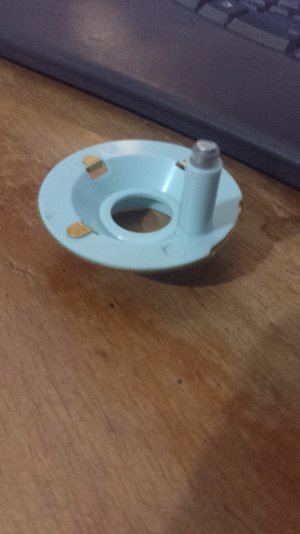

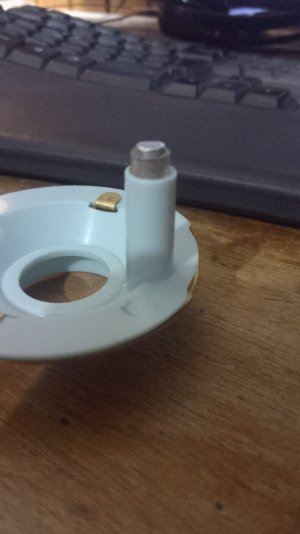

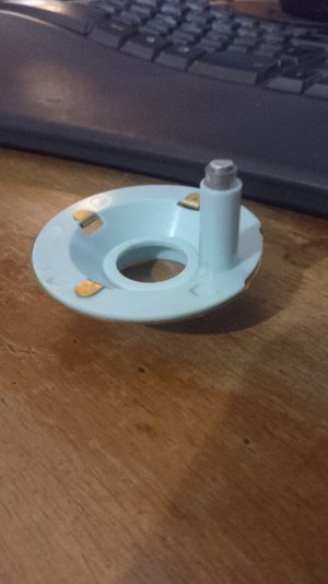

I took some images of what I have and would like to ask if this looks right?
WhatsApp Image 2025-04-09 at 16.07.13_9037a52c.jpgWhatsApp Image 2025-04-09 at 16.06.05_b1b7fbdf.jpgWhatsApp Image 2025-04-09 at 16.04.50_8f95e3bc.jpgWhatsApp Image 2025-04-09 at 16.04.15_93a42181.jpg
I found a post on cherokee forums with people having the same issue you do, though. Since its a chevy steering column, they found the same part fits the xj, yj, mj, and also cj, plus many types of chevy vehicles. But ine guy posts he fixed his by drilling out where the silver post goes so it moves properly because he said a spring rides under it.
I have it working I had to adjust the relay a few times but got it working. I still think doing away with those parts and using a piece of conductive metal is a better way. Anyway 84-01 the turn signal cancel cam is part number 4487816 and 4487816K the "K" designation is for tilt wheel. Omix sells them on Amazon but for some reason they do not have the XJ listed as applicable when it is.
