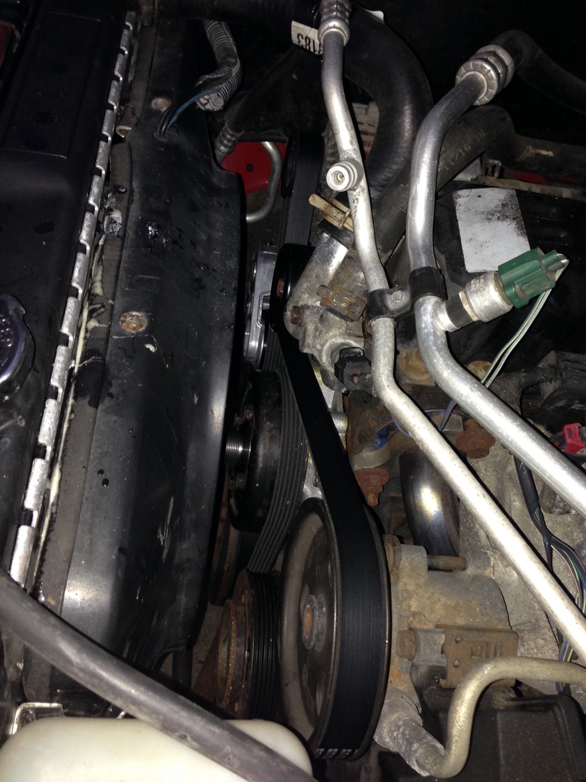

Today I swapped out the tensioner. Idler pulley belt and hoses. The radiator is back in. Lastly the fan.

All back together. Just need to change the oil now.
